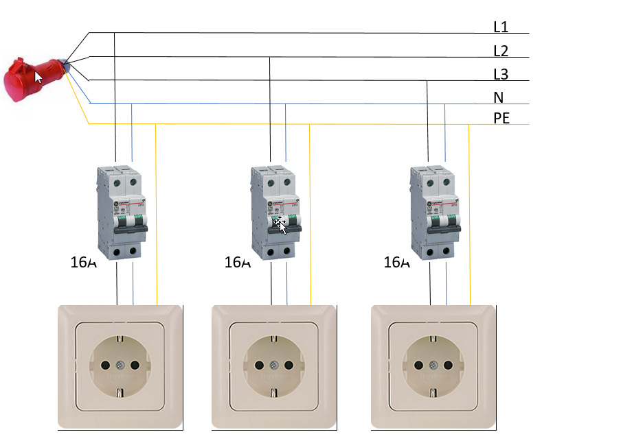

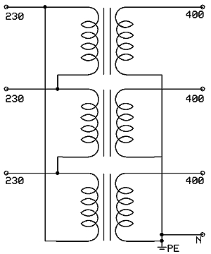

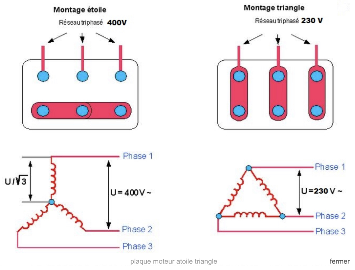

    I did some research and it is now clear to me.
    The AASD-15A needs a single phase 230V / 50Hz power supply or a three phase 220V power supply.
    The 3-phase 220V is therefore not the 3-phase 400V common in Europe.
    How about this now. The 3 phase, which is common in Europe, is structured as follows:
    There is 230V between each phase and the ZERO (Nul). But 400V is present between the phases. So if we now connect Fase1, 2 and 3 to L1, L2 and L3 from the AASD-15A, it will probably go up in smoke.
    If you still want to use 3-phase, you will have to use a 3-phase transformer in the power supply line that transforms the 3x 400V to 3x 220V.
    However, this is a very expensive solution (€ 600 and more)
    It is better to use the single-phase 230V, however, not many more users must be connected to the same group to prevent your fuse from tripping.
    You can consider connecting 3 separate sockets from a power group. You then connect 2 AASD-15A to each socket to spread the load.
    Good luck.
    :nerd
    Builder.

    Thanks! Great explanation. That's how I understood it as well. :thumbs
    Initially my argument for wanting to use 3 phase 400V was this:
    I have 6 motors with 1050W of power. So theoretically the motors could draw 6300W from the mains. Since european mains is 240V, it would have to draw 26A. That would have tripped the 16A breaker.
    Then I considered doing just what you suggested. Connect two motors to each 240V phase. That meant I could theoretically supply 11520W.:grin
    But eventually I wired all six motors up to a single 240V line, "just to do some testing" and also the computer, 3D printer, lights and monitor all draw from that same line and it still didn't trip the breaker. Ever.
    I think that goes hand in hand with what I said earlier, over 99% of the time those motors operate at somwhere around 10-20% load.
    Cheers,... Dirty :)

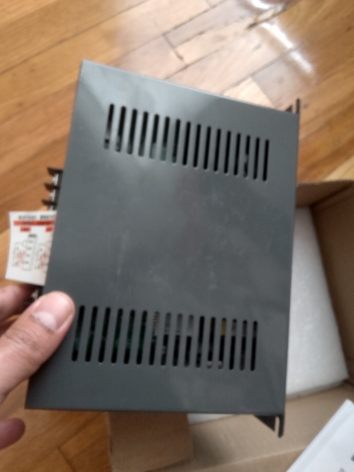

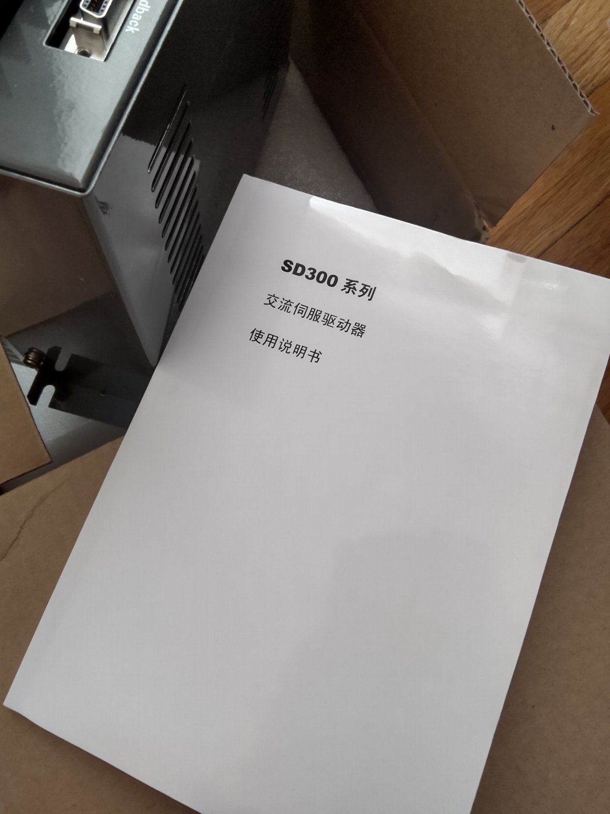

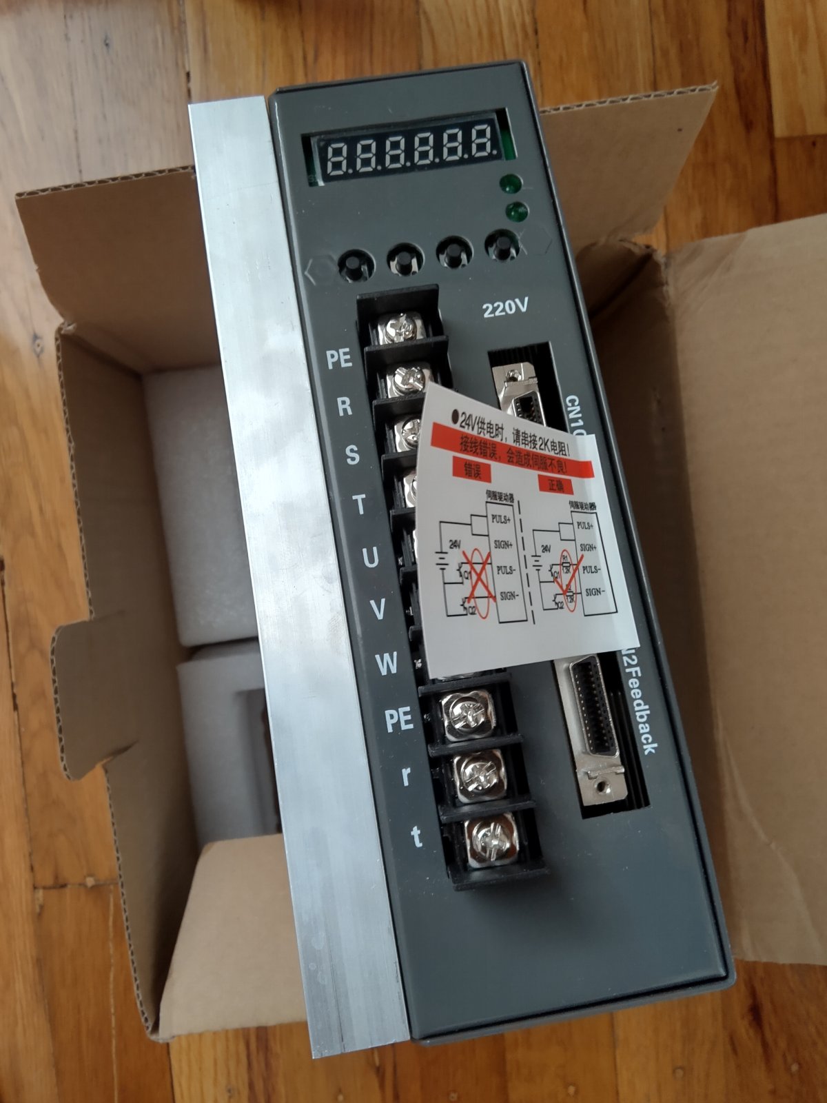

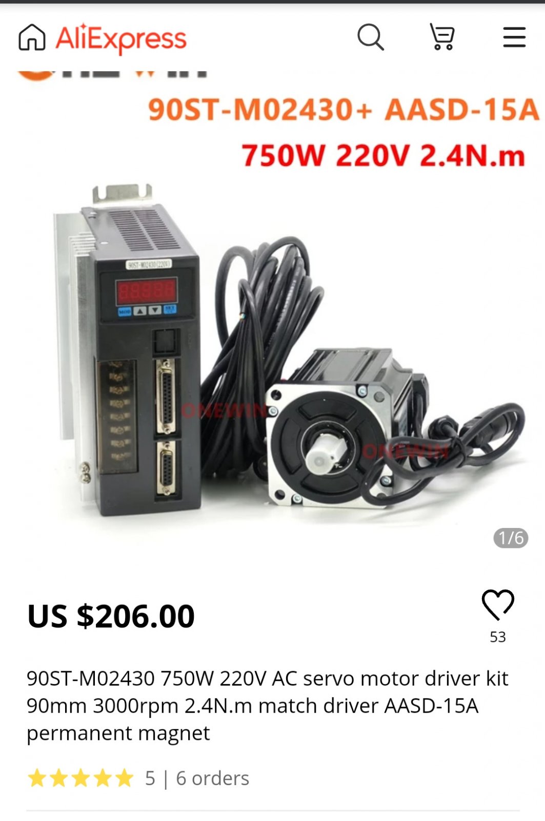

    Getting very close to start my thread and show the assembly of the entire rig.
    Today I got finally the package with the rest of the motors and drivers.
    BUT, to my surprise... DRIVERS ARE DIFFERENT to the AASD15A
    When requesting the purchase, I sent pictures and model numbers. They supposed to understand and ship the right stuff.
    The manual recieved is in Chinese and I found some kind of similar English manual here:
    http://www.topcncworkshop.com/data/download/201912/20/53099b6d4c63185bf17b3b9925ec6e93.pdf
    Seems that the specs are similar (or better... 30A?)... But worried about the parameters.
    Already left a message to @Thanos in RaceDepartment.com, but wanted to post here in case someone has seen this type of driver.
    Thanks to all as always for any idea if this would work or I shall return!
    Charlie

    Definitely return them. Not only there is no DB25 plug and play connector (has a 50pin connector instead), it doesn't support automatic calibration against hard stop either...
    Make sure when you order to get from seller that their drive looks like this externally:
    Link to this for example
    Thanos
  12. vectorcharlie
    vectorcharlie New Member
    Dec 11, 2020
    18
    191Coins
    +7 / 0 / -0
    Thanks so much @Thanos
    Will return them!
    CI

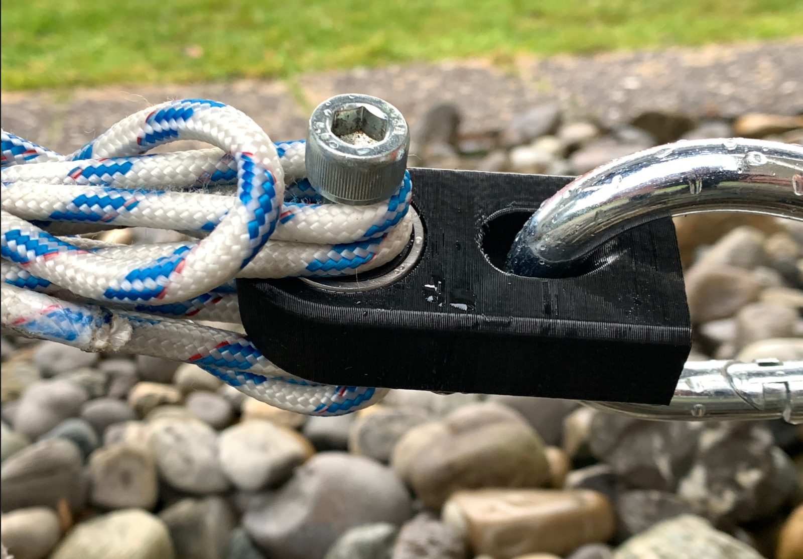

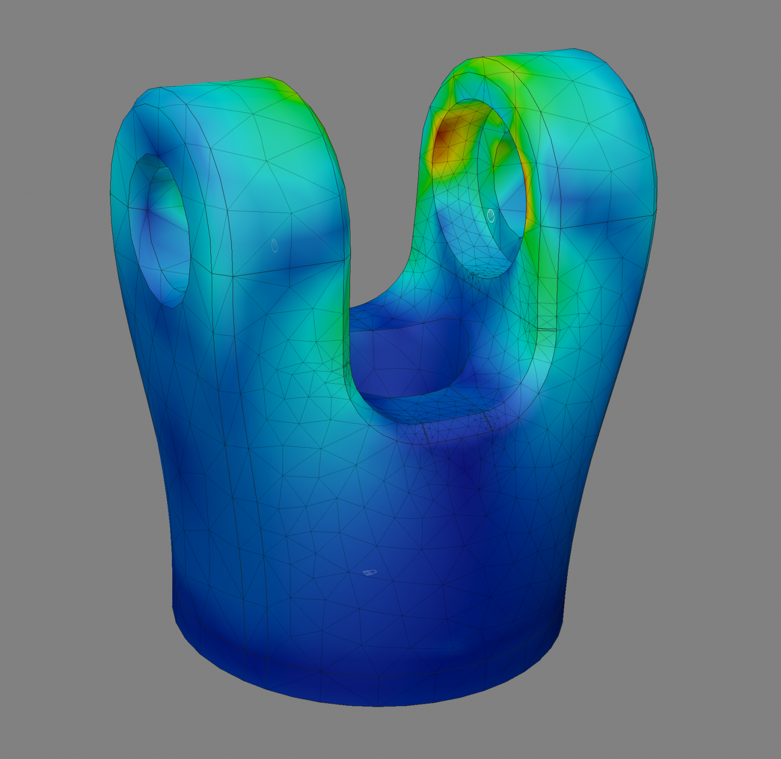

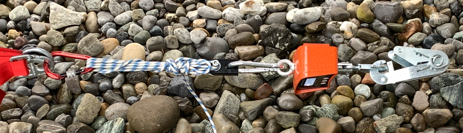

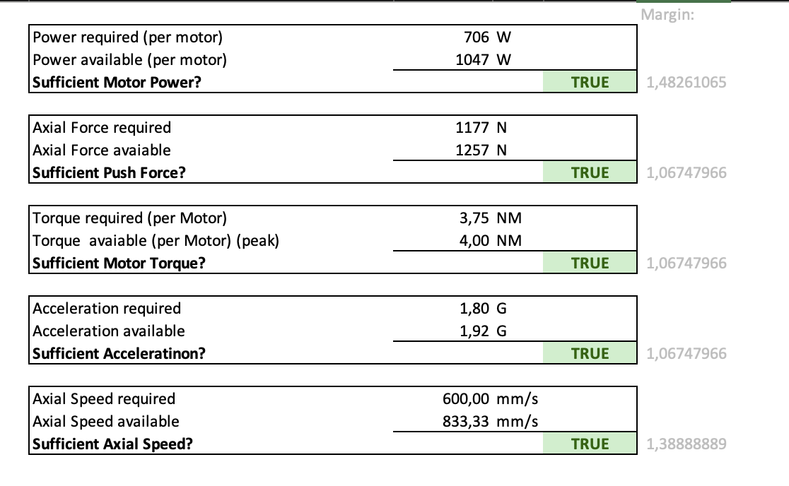

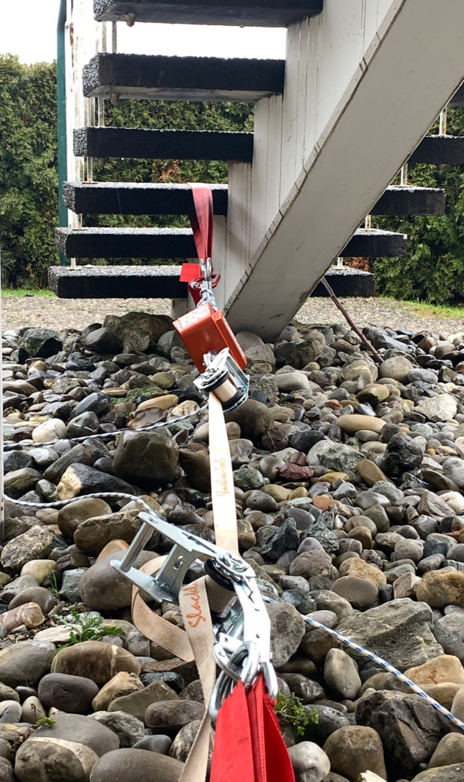

    I have done some tests to confirm my FE analysis:
    Since I designed those actuators for a nominal load of 1000N (~100Kgs / 220lbs) in pull direction and I wanted the usual safety factor of 3, I had to put 300kgs of pulling load on those U-joints.
    I used a (pretty beefy) tension belt from my slackline kit to create the tension and a crane scale to measure it, but even though I am certainly no pencil-neck, I was unable to create the necessary 3000N with the wrench.

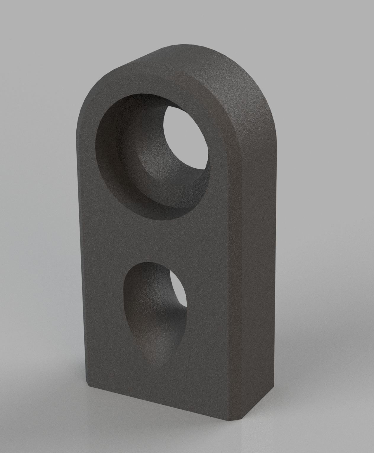

    So, I printed one isolated half of the forkhead as a test sample to measure on it's own.
    That way, I only needed to generate 1500N of load to confirm the safety factor of 3 :)
    upload_2021-2-3_10-10-34.png upload_2021-2-3_10-11-6.png upload_2021-2-3_10-12-15.png

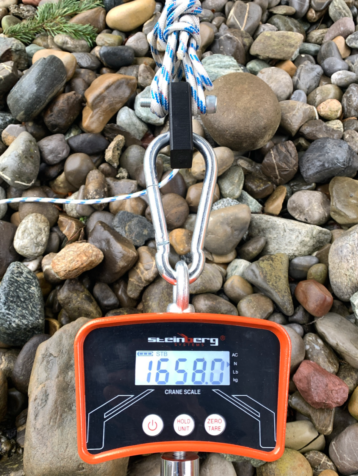

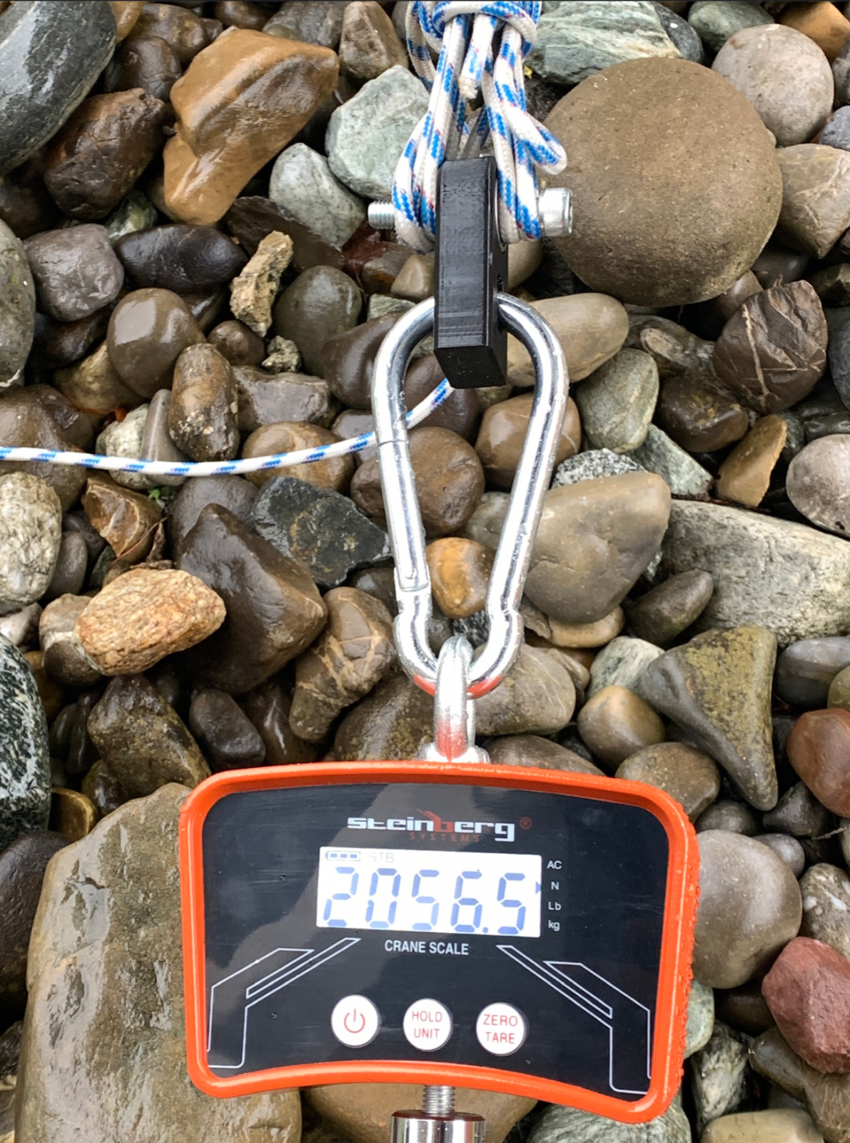

    First step:
    1600N, held up over 1h. It appears the belts have given a little, so I had to re-tighten it twice to keep the load up.
    Second step:
    2000N, also held up over 1h.
    That's the equivalent of 400Kgs/880lbs pulling on those U-joints!
    Given that over 99.9% of the time those joints will only be under ~30Kgs of compression load, I'd say that is a reassuring result :thumbs
    What I will do now is keep up that load for a few hours, just to be sure and then comes the fun part:
    Pulling them apart to determine the ultimate failure load :grin:grin:grin:grin:grin
