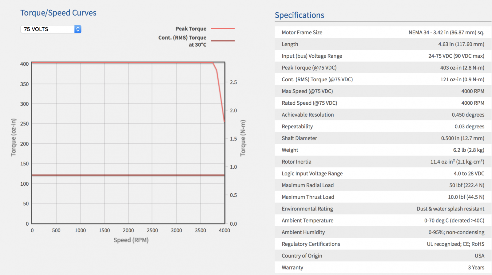

    Hi Dirty, Ive been browsing over the figures on torque (.09 N- > 2.8 N) and now I'm confused; at those figures it doesn't seem like it would be strong enough to pull your pants down????:confused:
    Would you care to enlighten me, on why this product was chosen!

    +17 / 3 / -0
    Hmm...they have 900W steady. Plenty Power anyway. And don´t forget the transmision (2.8 Nm @ 1:50 =125 Nm !!!)

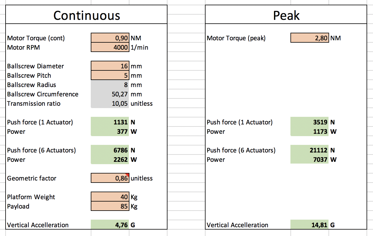

    Hey :)
    sorry for the late reply. Took me forever. Been away for a while. But still quite active in the workshop! I am happy to be able to say I’m well ahead of schedule on this project which is a rare occurrence in my life :)
    Here’s how I calculated:
    The motors generate 0.9N of force @ a radius of 1m (continuous)
    =900N @1mm
    =112N @8mm (since the ballscrew has 16mm diameter = 8mm radius)
    When the ballscrew does a full rotation it moves 50,27mm along the circumference of the screw while it pushes the ball nut 5mm forward. That is like a gear ratio of 10:1 leading to a push force of 1130N.
    That’s ~113Kg of lifting capacity (continuous) or 350Kg (peak) per actuator. Can you imagine what happens when 6 actuators each apply 3500N of force (total of 21000N) on a 85Kg payload!?! This thing will initially accelerate upwards at 14G. I don’t know what kind of pants you’re wearing, but I’d be more concerned for my balls flying off when this beast springs into action. :grin
    All that said, please… if there is an error in my calculations, let me know! I might have gotten those numbers wrong somewhere along the road.
    I’m still in Egypt (windsurfing) and for some reason I cannot access my cloud drive, but I will post a link to the excel sheet I’m using for you to check my calculations when I’m back. I’d REALLY appreciate some feedback.
    To answer your question:
    I chose those motors because they are very powerful and they can be driven directly by the AMC1280. All they need is a speed demand signal. No arduinos, no PID, no Kangaroos, no soldering (almost), no break resistors, no capacitors, no nothing!

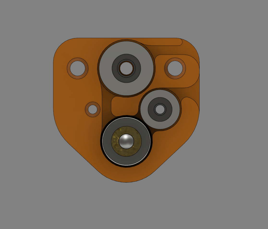

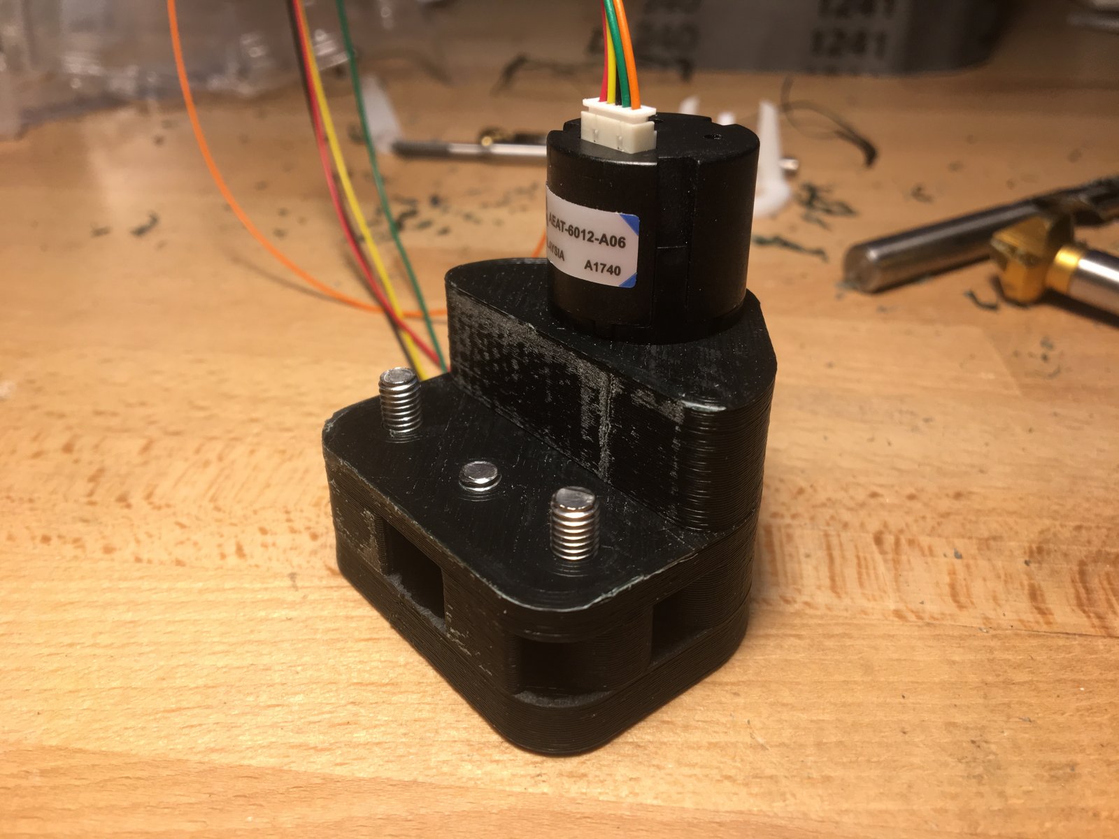

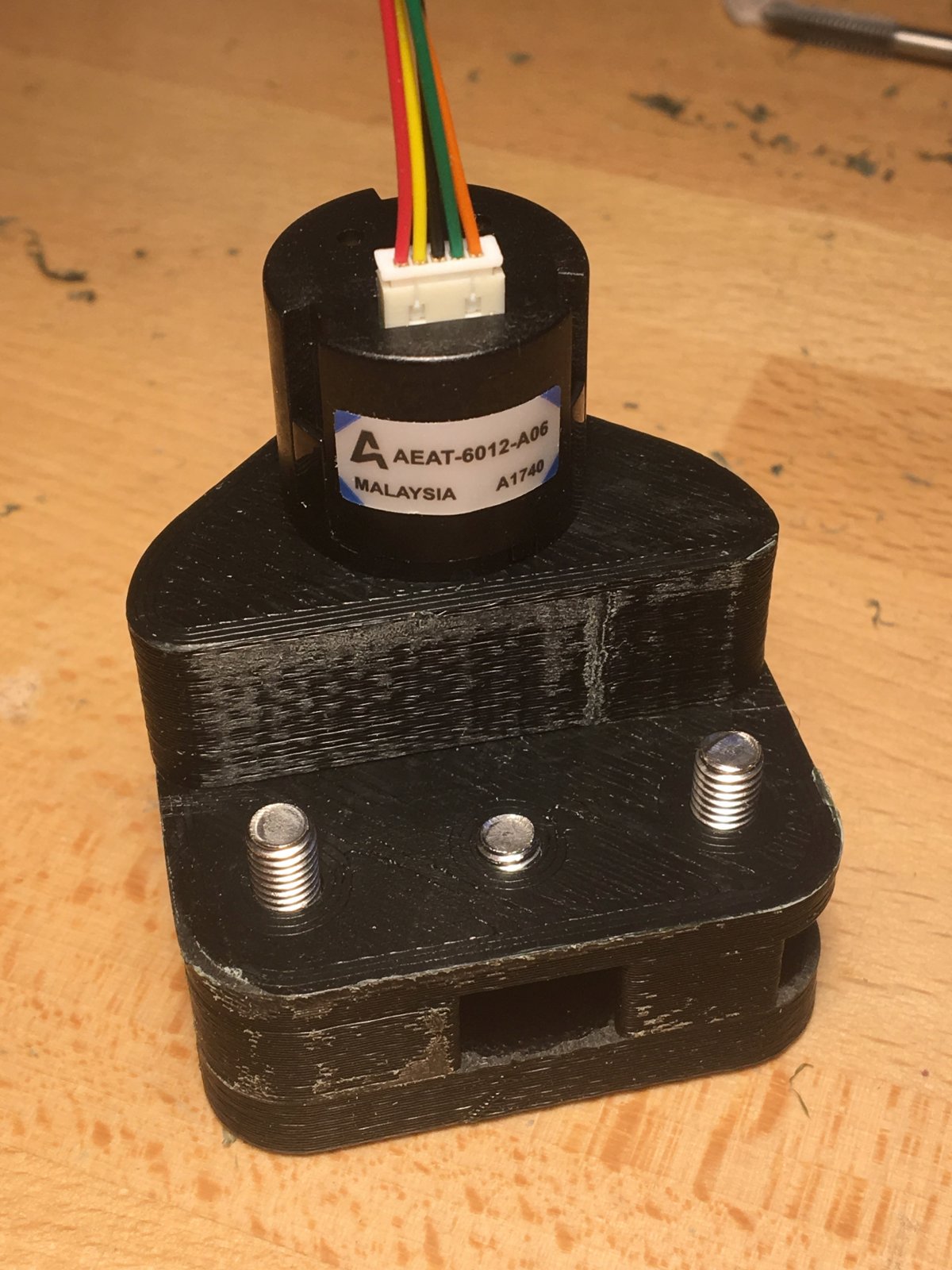

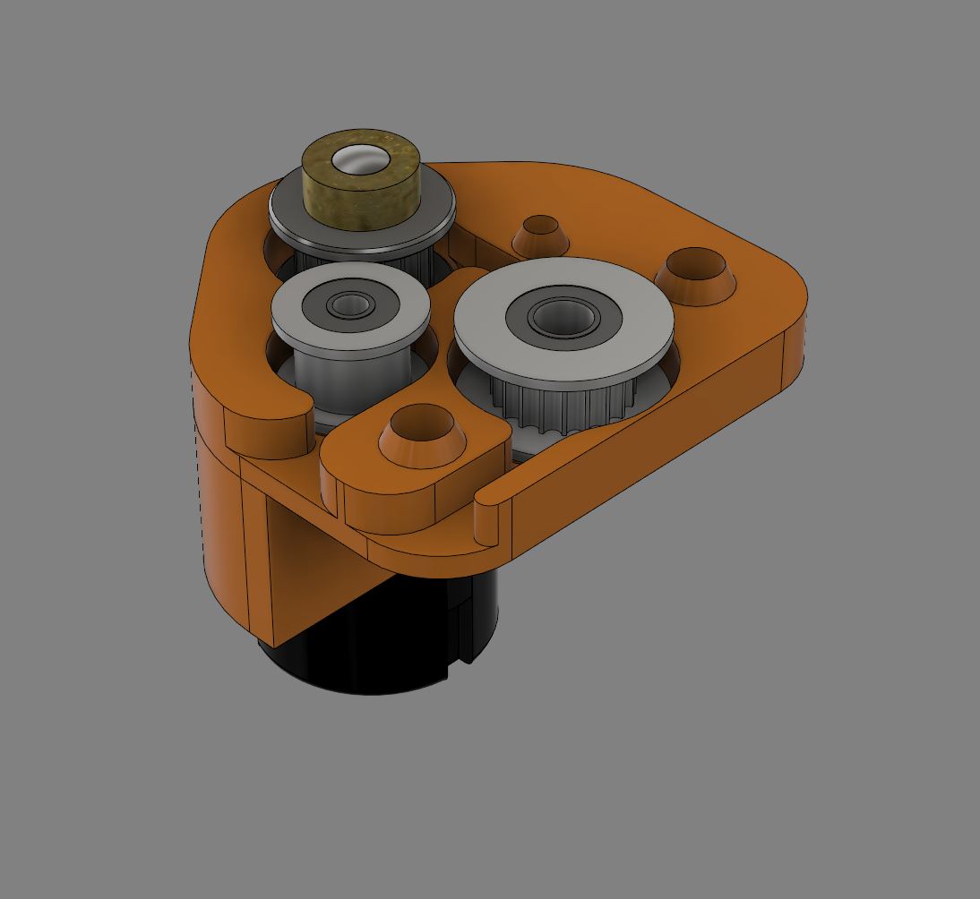

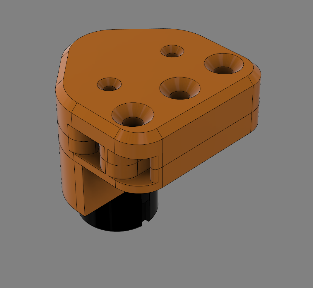

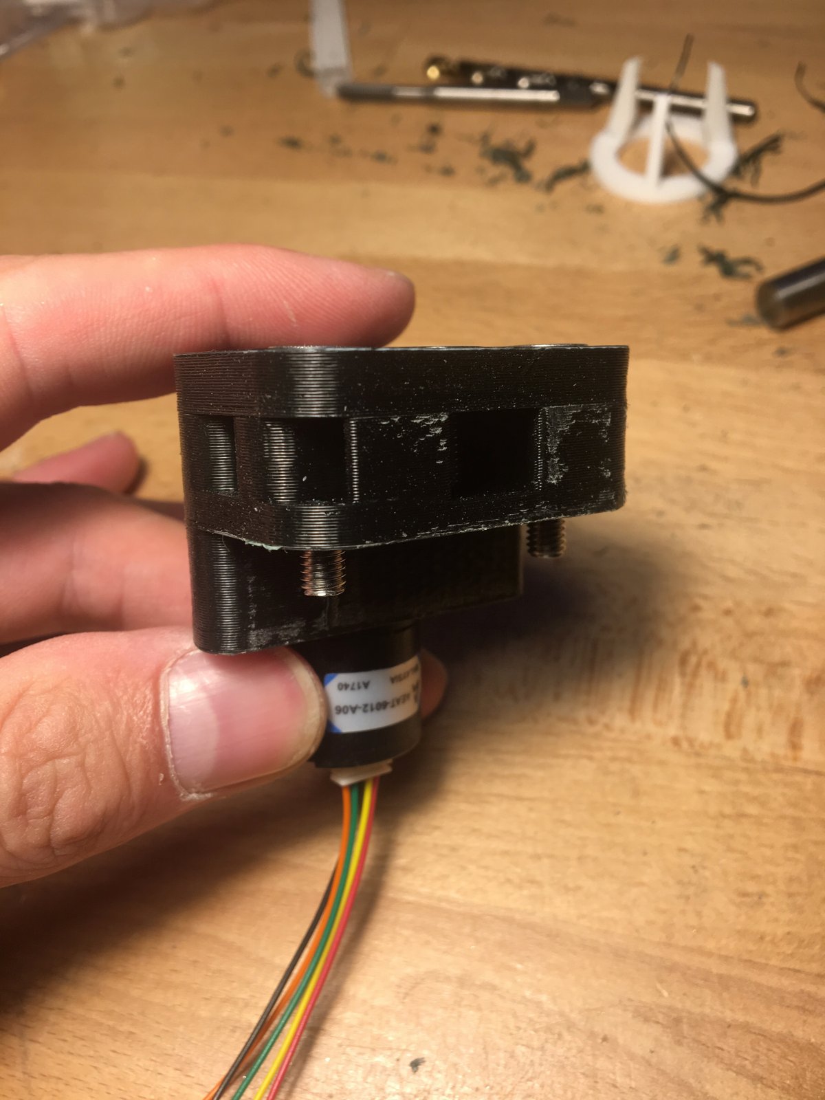

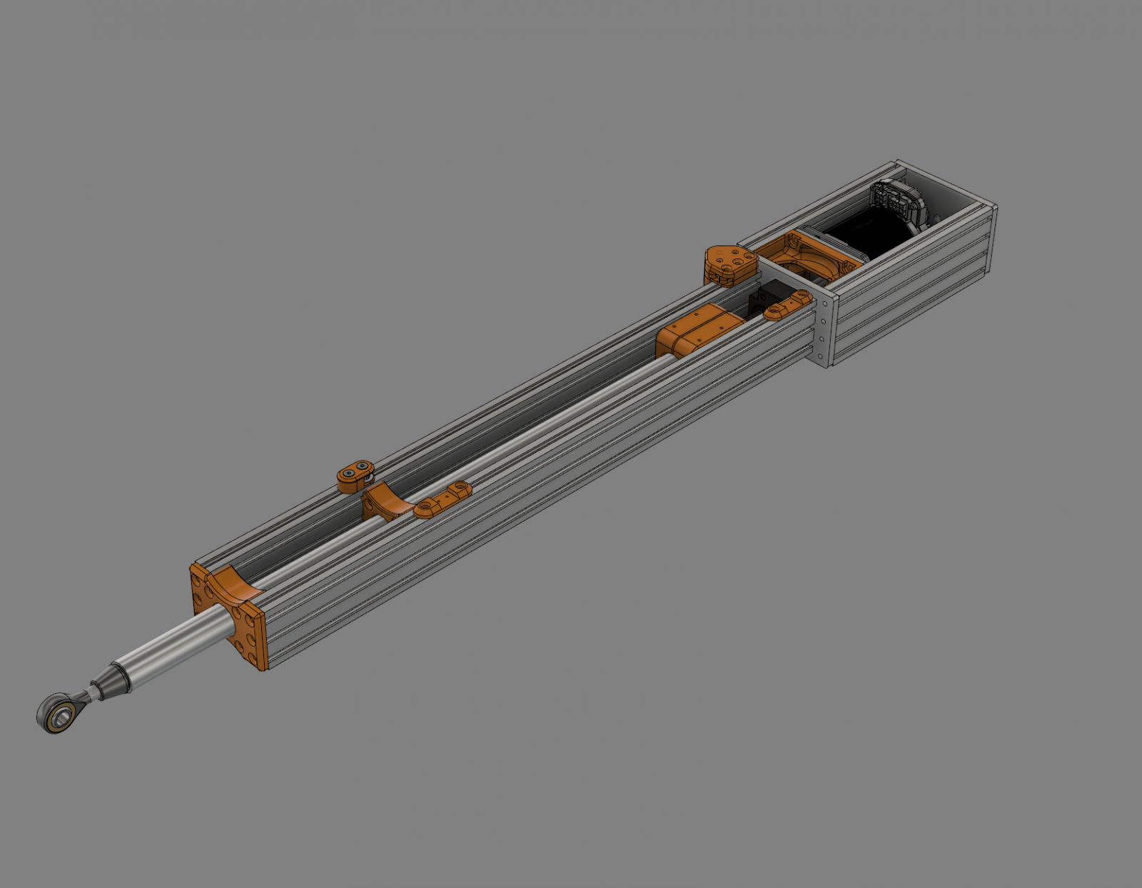

    Hey @pmvcda
    Well,…. Initially I was planning on building an actuator with a simple MY1020 and an Arduino. Therefore the belt and pot was a necessary evil and I designed the actuators with those in mind. When I switched to the Clearpath motors, I thought that I could leave everything out if I used them in „Follow Position Demand“ mode. Unfortunately, that wasn’t quite as easy as I would’ve liked it to be….
    First @Thanos informed me about this issue with the motors having to finish every move before being able to execute a new move and recommended using the motors in „Follow Speed Demand“ mode together with the AEAT-6012 as a sensor.
    Then I briefly considered using the motors internal sensor (like you do in your project) but those motors aren’t meant to be used in this way and my technical skills are definitely not sufficient to hack into the motors internal workings, so I looked into the AEAT-6012s.
    They provide 12bit resolution (4096 steps) and I have ~10 turns per full stroke leaving me with ~40.960 steps for the 380mm of travel. That’s a resolution of 0,0092mm per step. Less than 1/100 of a mm. I know that this is a theoretical value, but at least I can be reasonably certain that the position sensing will not be the bottle neck when it comes to the accuracy of the rig.
    Here a couple of pics of how I will mount the belt and sensor.
    Instead of the T-shape belt run I planned earlier, I can now use this L-shape design.
    For now I will print all parts in PLA (a dream to print!) until I am through a few design iterations and found the right setup and everything works flawless. Then I will switch over to either NylonX or PETG for the "serial production".
    Here you can see, that the new design I adopted from @bruce stephen 's recommendation allows me to have only one idler.
    Dirty :D

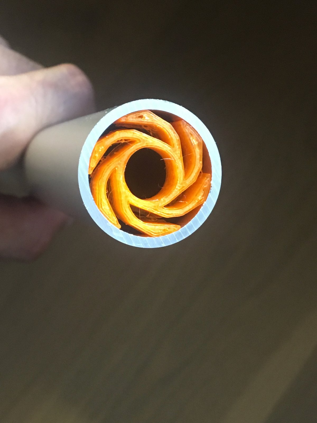

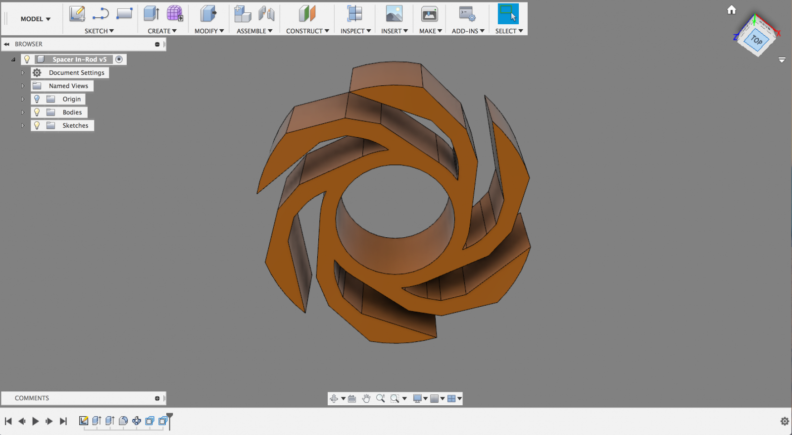

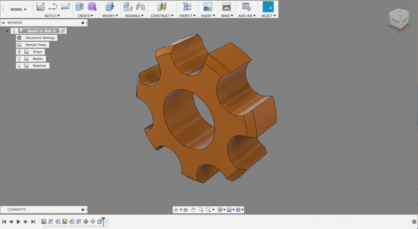

    To keep the end of the ballscrew from dangling around inside the rod, some form of spacer needs to keep it in place (centred). This spacer must also be able to let air pass through, because when the rod moves the air inside it must have somewhere to go.
    Initially I used this star-shape design.
    The problem is, that you need tight tolerances to prevent (noisy!) vibrations of the ballscrew but at the same time you need a little wiggle room to allow it to rotate on the ballscrew and to keep it from getting stuck inside the rod as it moves past the spacer.
    This new spiral-design works a lot better!
    It has an outside diameter about 0,2mm (1/100th inch) greater than the inside diameter of the rod. So you will need to flex-in those spiral arms a little to get it inside the rod, but then it will deliver
    1. a nice and constant "springy" centering force to the ballscrew
    2. will allow for ventilation and is
    3. absolutely play-free.
    I have made a before and after video from the same distance and there is an audible difference in noise level :) I will post those when I'm back home.
    Dirty :D

    Hi Dirty, I have question if I may?
    Can we add the weight of "motor and ballscrew inertia" into the equation?
    It would be interesting to see the difference on the outcome.
    Regards Jerry
  13. Dirty
    Oct 15, 2017
    746
    All the way up front.
    7,980Coins
    +890 / 3 / -0
    I'd say the rotational moments of inertia of the ballscrew and motor axis (aka. "what it takes to get these small parts into motion") are negligible compared to the inertia of the platform/payload (aka. "what it takes to get this huge mass into motion!)
    Keep in mind, when it comes to actuation speed or nominal static force of the actuators, inertia plays absolutely NO role. It is only important for acceleration.
    If you wanna reduce weight, your platform and your "belly" are the most promising candidates :)
