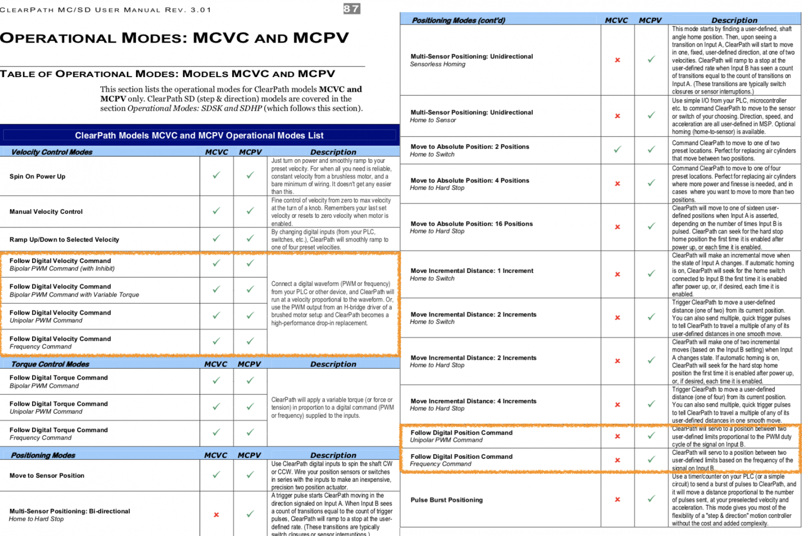

    Ahh, interesting! Thanks!
    I guess I have mixed up "Move to Absolute Position" with "Follow Digital Position Command".
    I have found a video of it here. That mode sounds like you can completely ditch belt, and pot and rely on the motors sensors alone :) That's what I find incredibly attractive about them. And even in the standard version it would give you position control to within ~2.7 micrometers. Thats about a 1/10000th of an inch! (Assuming a ballscrew with a 5mm lead)
    I think for now I will stay with the conventional position sensing via belt & pot and control through "Follow Digital Velocity Command". But if someone here on the forums were to try them out, and found that indeed they performed as precise as one would expect. I'd try to sell my MCVCs on eBay.

    I'm an engineer at Teknic and came across this forum. @Dirty - Thanks for using Teknic motors and for sharing information about your build! I love your enthusiasm and the encouragement you offer to others.
    I noticed some users (including @pmvcda and @Dirty) had some questions about different ClearPath families and control modes, so I wanted to help clarify the difference between ClearPath MC, SD, and SC series motors.
    1a - MCVC (Motion Control with Velocity Control).
    • This series was designed primarily for torque and velocity applications, (but includes two positioning modes as well).
    • For most positioning applications, the MCPV or SDxx families are typically a better fit, but it really depends on the application.
    1b - MCPV (Motion Control with Position and Velocity).
    • This series has several positioning modes. A couple of MCPV modes I saw mentioned in this thread include:
      • Follow Digital Position - Real time position control through a PWM or variable frequency signal.
      • Pulse Burst Positioning - Lets you command moves by sending a high frequency burst of pulses where each pulse represents a small incremental distance.
    • Pros: Unlimited positioning without expensive controller requirements (users don't need to time the step pulses as they would with Step & Dir models).
    • Cons: Limited number of speed and acceleration settings and, as @Thanos mentioned, once a stream of pulses is sent to ClearPath, the servo will (necessarily) "play out" all steps before another move can begin.

    Ok, so I did confirm that the new MCPV firmware, using the Follow Digital Position Command does NOT have to "play out" any sequences. I did this by setting the RPM on the servo low (100rpm) and testing the limit buttons on the AMC1280USB. The AMC is set to 12bit PWM, absolute position. I set the start and end points to be a single revolution in each direction. I did the button presses to simulate "mid-movement" interrupts with new positions.
    Excuse the basic video, but it should illustrate the point.
    Hopefully this clears up how they can work with the AMC. Based on this, I'm going to be ordering 5 more motors :)
