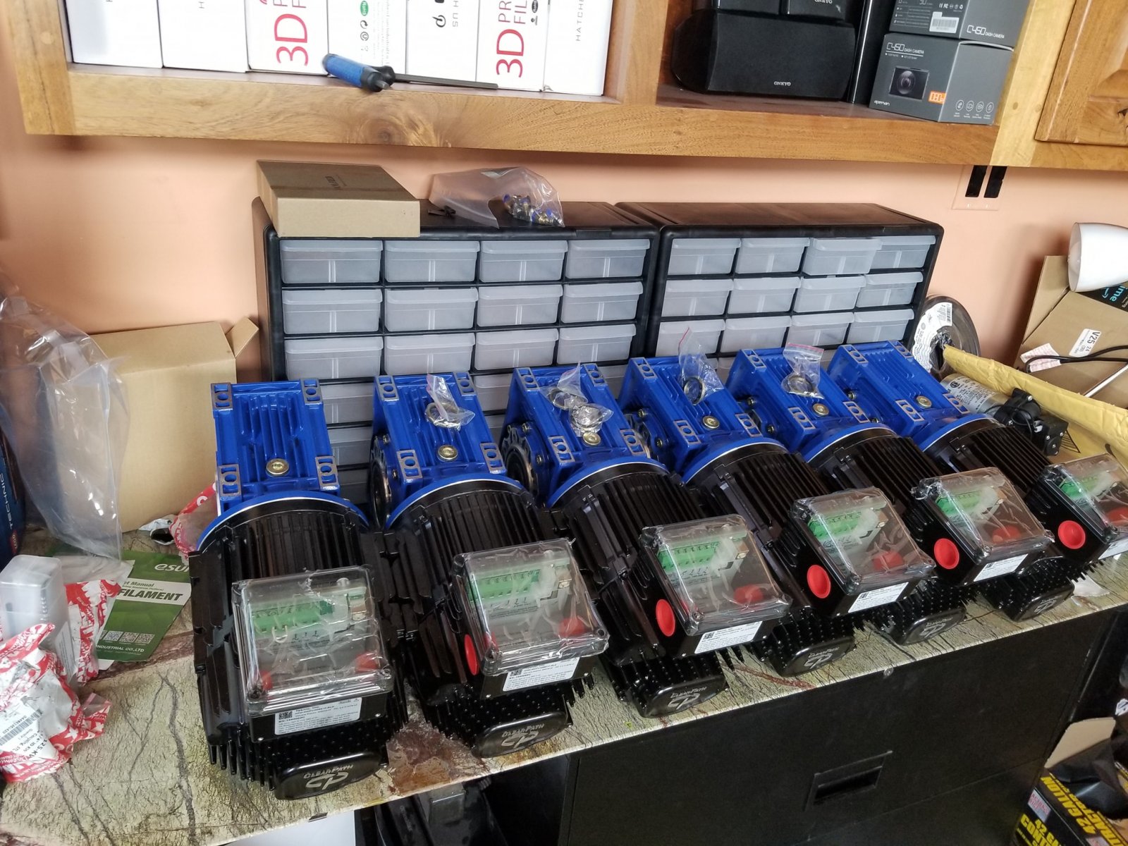

    It comes at a price though. I ordered the 5 other motors today. Came in around $4400 with cables and shipping.
    I'll start a separate thread once everything starts going together. Pertaining to this post though, the MCPV models seem to be a solid option at this point. Definitely makes it less intimidating

    That’s maybe the price for convince and quality.
    With those you have enough torque for a small dual cockpit with a decent speed.
    Those gearboxes do they have a limit for nominal, max, and ultimate torque ?
    What’s the price of those?

    The conclusion is that it does work, but it's ultimately more expensive at about $900 per motor after the cost of the motor, cable and shipping. @Thanos has been making a lot of progress with servo control which presents a much more affordable and more simple setup without the need for the potentiometers for position feedback. Out of the box, the Teknic servos are super simple and that was what I was going for. It worked with a stock firmware AMC base board, leaving the only setup required to be in the Teknic software to set start, end, max RPM, acceleration, etc.
    I purchased the additional motors and am making my frame. Waiting on a little more metal.

    Those motors are huge... Great to know that it is working alright with no need for external positionnning sensor and no power supply if I get correctly. 900$ / motor is a high price indeed, but I guess it is the price to pay for "relative" simplicity. And to be fair, adding the costs of servo drives, power supplies and sensors, it is not that much more expensive I guess. Only the gearbox is still needed. Can you share more info regarding it by the way ? Model, price, supplier, etc...
    Thanks in advance.
