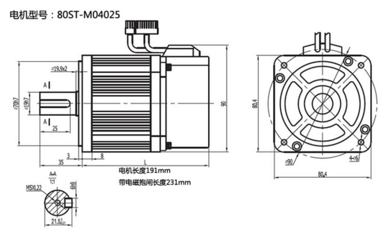

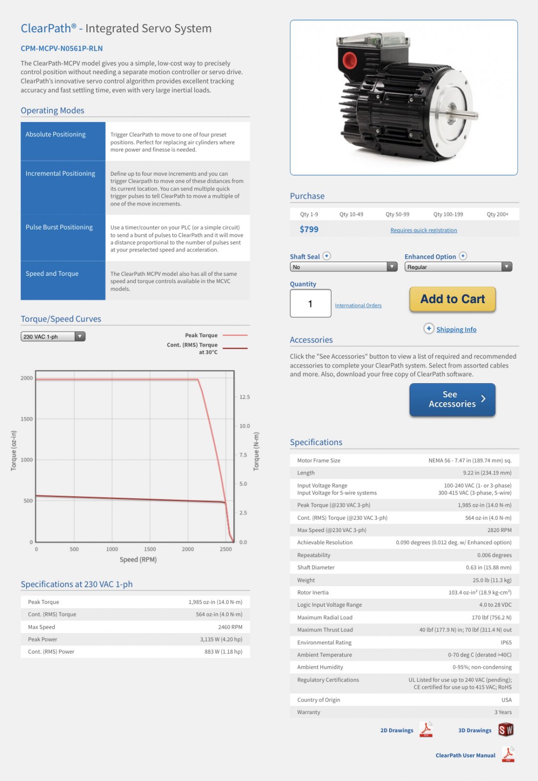

    Supposing the curve of the M04025 is similar accordingly to the model @Thanos is showing, I found a model at Teknic with similar specs. Two small differences :
    3 x the weight and 4 x the price. ;-)

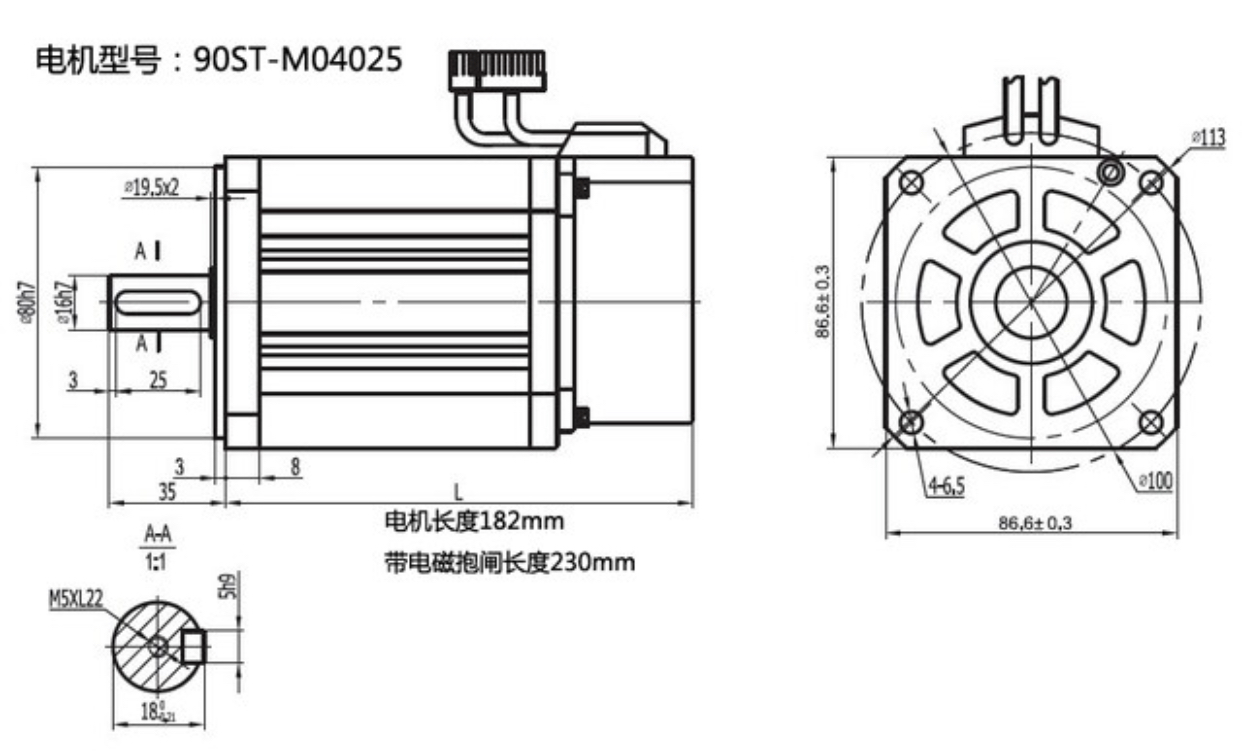

    We have also this size.
    Don’t know if the st80 or st90 corresponds to the NEMA 34 standard. It doesn’t looks like.
    https://m.de.aliexpress.com/item/32845039986.html

    +138 / 4 / -0
    A st80 fits on a nema32 gearbox
    I am not shure a st90 fits on a nema34 gearbox

    +138 / 4 / -0
    Be careful with nema32 there are different shaft sizes

    DC motor, 6DOF
    Yea same shit for the nema 34

    Yes, but be aware of the different shaft sizes. They may need different coupler link sizes...
    But otherwise, these have advantage on size for the power and price of course.

    Tell me @Thanos please, can you interface in the same way all the range of these motors ? I mean, there is no problem to go with bigger frames like ST90 ST110 ST130 and ST 150 ?

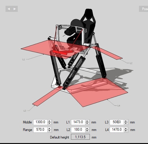

    Hey guys. I'm looking at dimensions and the kind of travels geometrically possible are a bit higher than I expected! I assume that it's inadvisable to use that kind of translational travel, is that correct? What kind of limitations should I expect to put on sway and surge? Not in terms of preventing clipping,, that's a separate thing. I mean in terms of maybe mechanical interference, actuator angles that could cause damage etc.
    Answer: the upper joints of the actuators seem to be the primary limiting factor.

  18. Trip Rodriguez
    Trip Rodriguez VR Pilot

    I wasn't looking for exact info, just some idea. Mostly I was wondering if there is an angle we generally don't want the actuators to go beyond regardless of u-joints and collision issues. The closer they get to horizontal the harder they have to work to raise the platform correct? I meant things like that.

    pmvcda aka FlyPT
    Nov 3, 2010
    2,286
    Portugal
    15,986Coins
    +2,734 / 18 / -0
    You might loose in the combination of DOF's.
    You also get the actuators more vertical. Might be an advantage in the load of each one, but it's also more unstable. It's like putting all actuators vertical, and with joints, all gaps have a larger effect on the rig.
    Might be wrong, I have to think more about it.
    But I don't think it's a problem in your measures.
    But you are wrong with range. Range is half of the full travel.
    So if minimum extension is 1015 and maximum 1580, full travel is 565mm and range is 565/2=282.5
