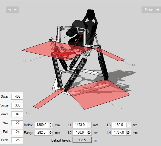

  3. Trip Rodriguez
    Trip Rodriguez VR Pilot
    May 8, 2016
    683
    Lake Ariel, Pennsylvania
    3,978Coins
    +331 / 7 / -0
    Updated numbers. Note that I'm now back to the standard minimal dimensions on the short sides of the bottom hex.
    It looks like the Heim joint angles are once again an issue for pitch and roll angles approaching 20 degrees. I don't expect I'll use that much but still I'll want to use joints that give me as much range as possible. Other than that, everything looks good!
    Maximum travels shown here (mm and degrees) are the theoretical max so I'll have to take a bit out for a safety margin.

    I would say that’s an optimistic statement although it’s very good as a starting point.
    Depending on the design, actuation ability and the amount of HPF it can be that the heave full travel will need to be reduced by more than a half.
    It’s a complex topic where the empirical approach will give you an answer.

    Oh sorry, I thought the discussion was going on how big the heave can be ?
    The standard heim joints will have to be customized with spacers in order to allow more bank angle otherwise you will hit the limit pretty quickly.
    The good question is if it makes sense to go for expensive 360 rotative u joints with the actuator length and stroke you take as option.
    I don’t know.
    For range limitations:
    - put 20 angular and 150 translational
    - construct a profile for a vehicle and apply filtering according to your needs
    - do all possible maneuvers except accident.
    If you lock your platform increase first the HPF, if it doesn’t help increase the heave range limiter.
    Otherwise you can search for bigger heave.

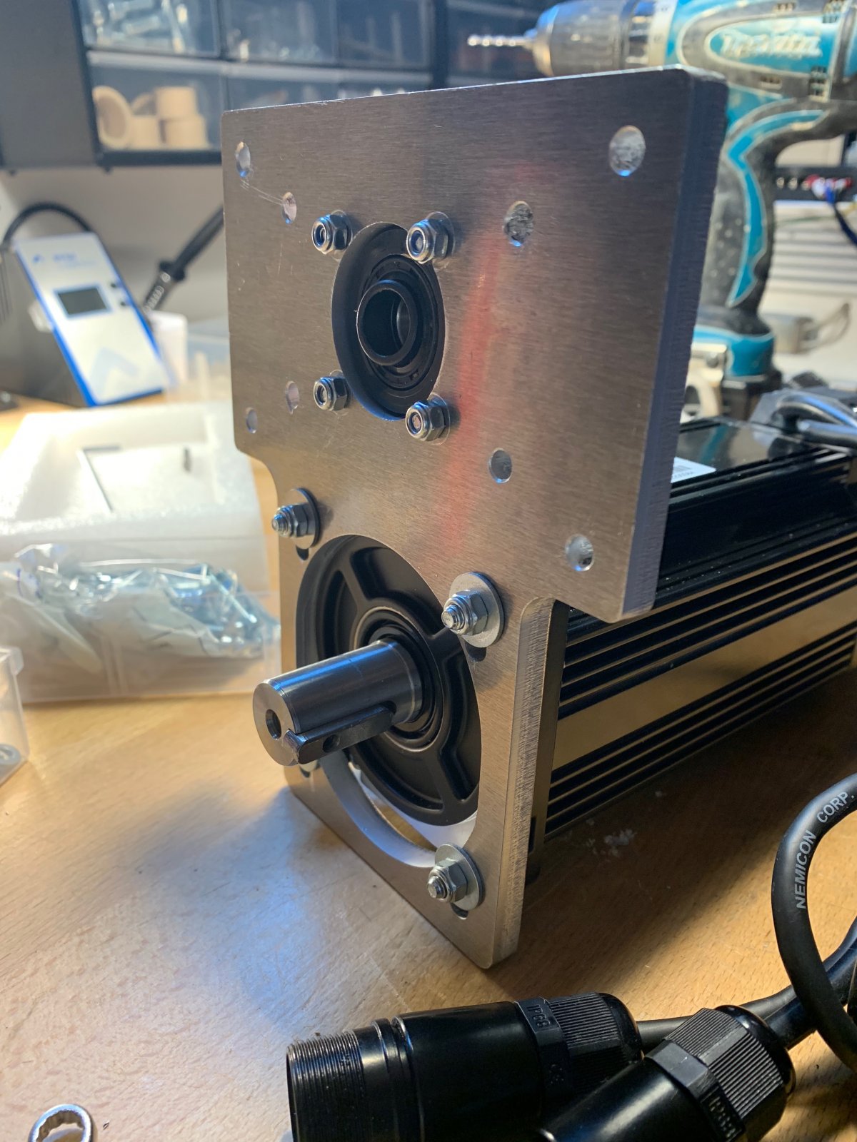

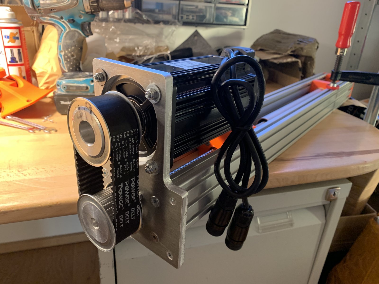

    I ordered these:
    https://de.aliexpress.com/item/32789668396.html?spm=a2g0s.9042311.0.0.7c2c4c4dlOIKck
    ...for a 25mm belt, 30 teeth, with 6 having 10mm bore and 6 having 19mm bore.
    They fit onto the motors really well. Absolutely no gap.
    I glued them on with a tiny drop of Loctite 243 and [hope that I]can remove them with a heatgun.
    Cheers,... Dirty

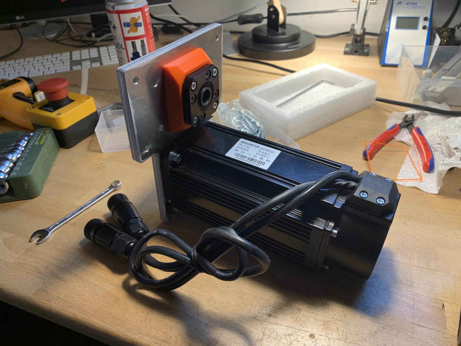

    I got the motors from China! :)
    Those are the ones I ordered,...
    https://de.aliexpress.com/item/32843516422.html?spm=a2g0s.9042311.0.0.9b984c4dYKpspH
    ...and I find them great! @Thanos' AMC AASD-15A works great with them and they are easy to hook up.
    If you have ordinary European 240V, just put the Line (brown or black) on L1 and the Neutral (blue) on L2. Polarity shouldn't even make a difference here.

    Oh, and probably also noteworthy:
    These motors have a 19mm shaft with an inserted key. After spending an hour trying to find key'ed pulleys, I noticed that you can pull them out of the "trench" with a strong pair of pliers :thumbs

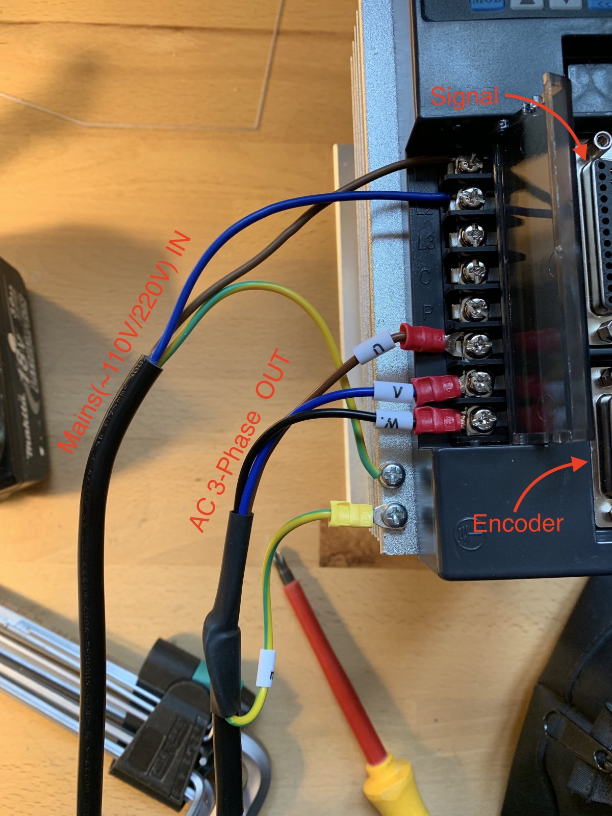

  18. Thanos
    Jul 6, 2017
    1,378
    Electronics Engineer
    United States
    2,911Coins
    +1,079 / 10 / -0
    On the photo, where you have a label as encoder on the cable on the screw terminal, this cable is actually the 3phase AC power for the motor!!! Just saying ;)
    Which cable you may want to replace at some point. Its unshielded and produces lots of EMI
    https://www.racedepartment.com/thre...controller-thread.168360/page-26#post-3070461

    DC motor, 6DOF
    @Thanos, It’s a shame to reveal my ignorance but I just want to die less stupid.
    This servo drive is designed to be powered by a single phase 230V than it sends 3 x 230V = 400V (L1 L2 L3 and Neutral) to the motor. Is this correct ?
  20. Dirty
    Oct 15, 2017
    746
    All the way up front.
    7,974Coins
    +890 / 3 / -0
    OMG,... You're right. Of course! UVW are the three AC phases.
    The encoder is the cable to the lower right. I will correct it when I get home.
    Thanks for checking!
