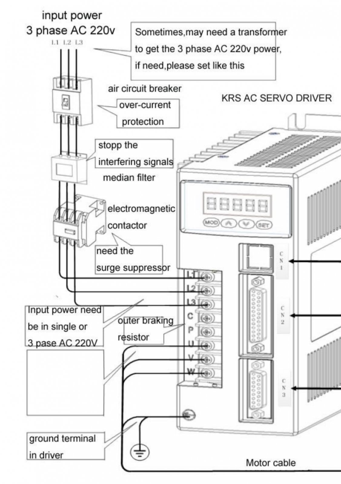

    DC motor, 6DOF
    I am still a bit confused but please watch this diagram because I don’t see the neutral in the input

    When using 3phase, you can connect the Neutral (equipment ground) to the ground screw of the driver.

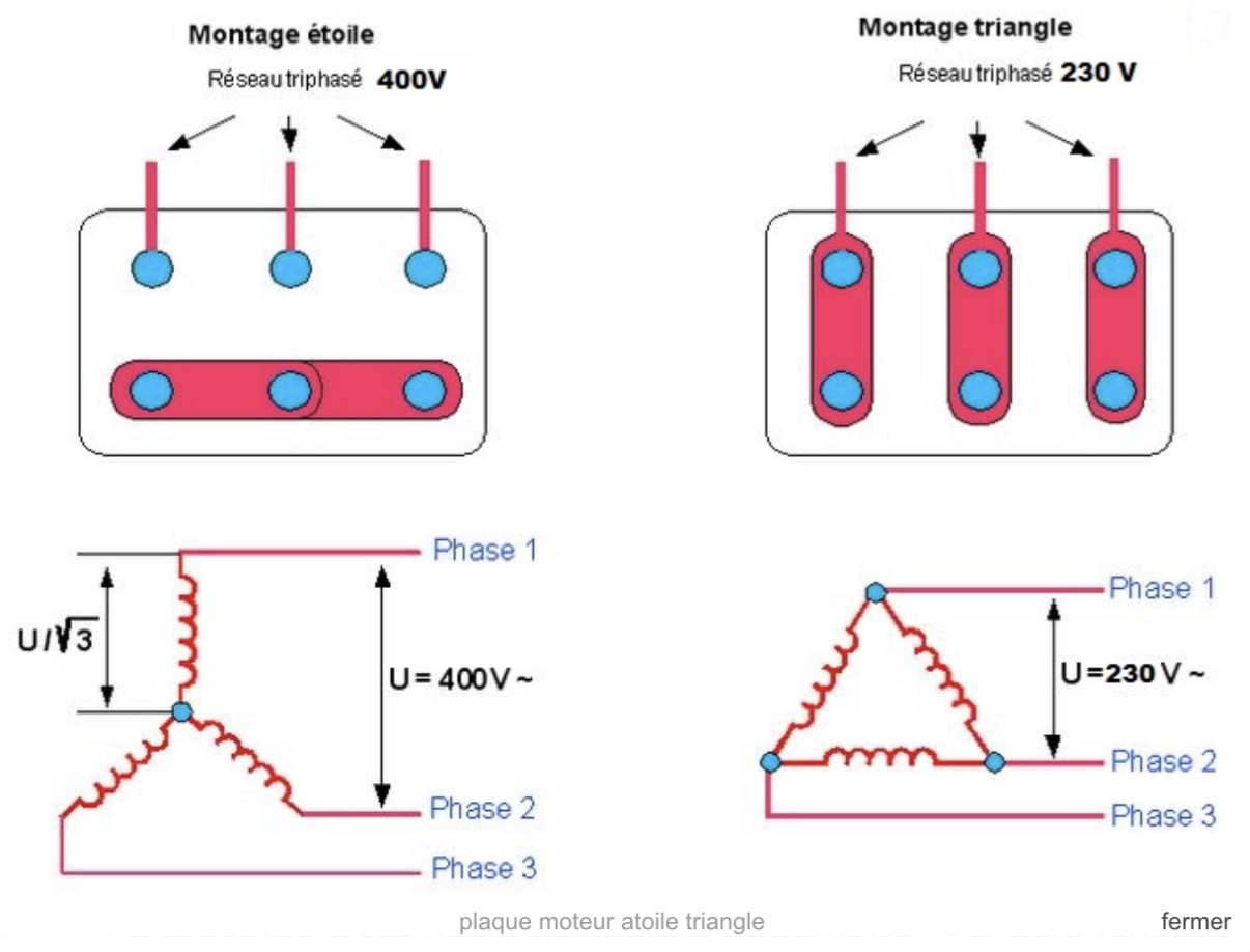

    Again an ignorant question...
    Is the 3 phase voltage (230 vs 400) related to delta / star wiring ?
  7. Dirty
    Oct 15, 2017
    746
    All the way up front.
    7,980Coins
    +890 / 3 / -0
    Yes, that's the difference. You can either use...
    - one phase against neutral (star)
    - one phase against another phase (delta)
    The factor between the two methods is always square root of 3 (~1.73)
    230V --> 400V (Germany)
    120V --> 208V (US)

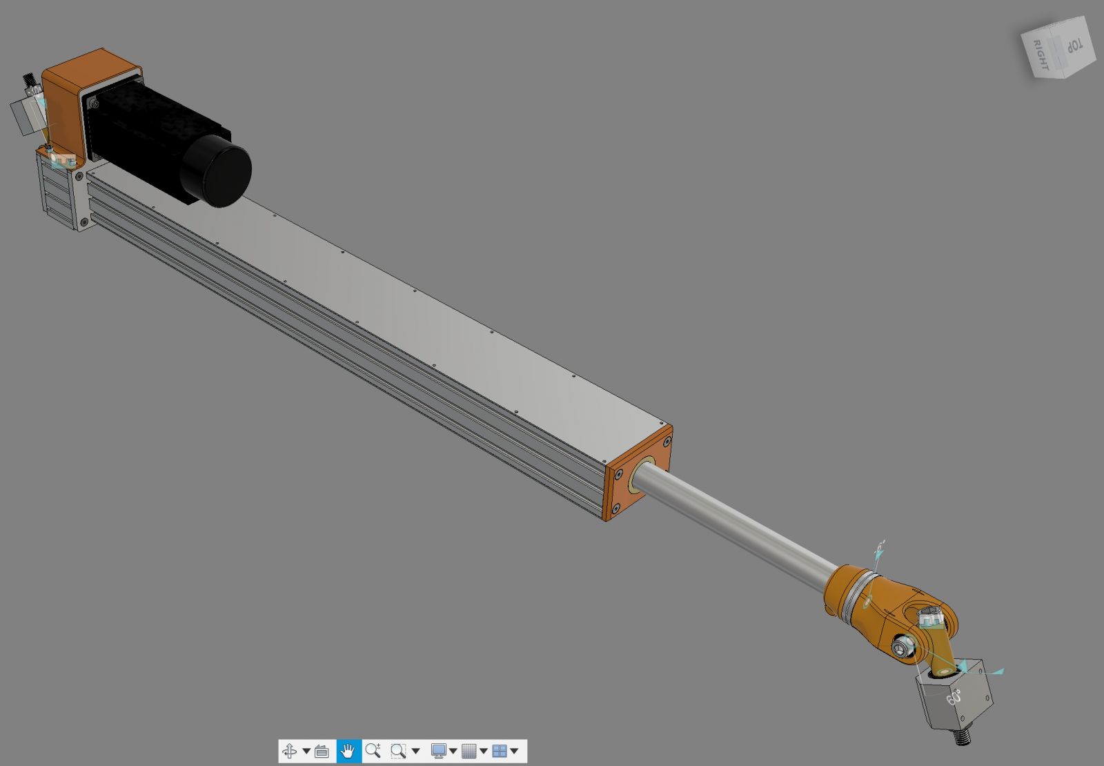

    Hey :)
    finally the first actuator is working. Properly driven by the sim. It performs as expected :thumbs
    Push and pull force way within design specs. So much so actually that it's possible to change the gear ratio to 1:2 for twice the speed (830mm/s) if needed.
    Cheers, Dirty :)

  13. Dirty
    Oct 15, 2017
    746
    7,980Coins
    +890 / 3 / -0
    I agree! Your butt can feel motion a lot better than your eyes can see it. Especially when all there is to see is a tiny concept-model on the screen.

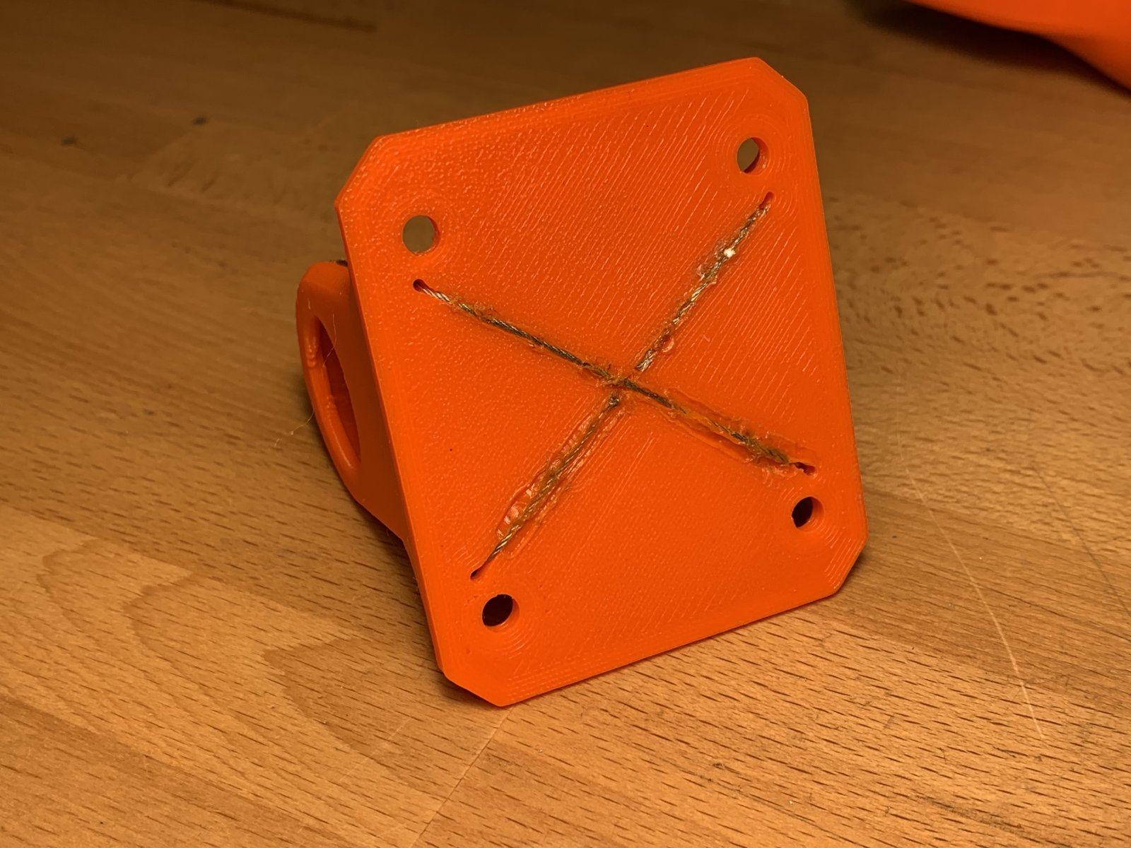

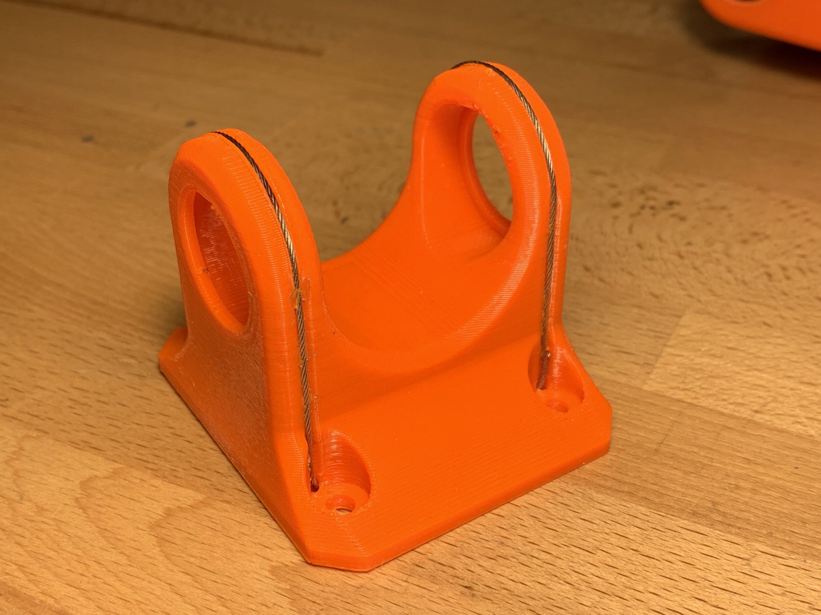

    4. I guess so :) I hope so! :) So far, I see no bending or other deformations. I have printed the parts with a 3mm shell and 50% infill. There are two kinds of load on the part: Compression and extension. Compression does not seem to be a big factor here. Extension might be a more critical case. Especially considering that the parts are printed with the layer lines horizontal! I have put ~150Kg of extension load on the actuator for a few minutes. That went fine. But....
      ...I have a friend who works with thermoplastics as an engineer in a professional manner. He mentioned, that over longer periods (weeks/months) even PETG can flow like a Glacier. I will see how it holds up.
      I have tried to melt a steel wire into the plastic to transfer the load into the deeper layers of the part:
      At the end of the day, I think that the part will hold the load fine when dimensioned big enough even without steel reinforcement. Especially the shell thickness is important.
