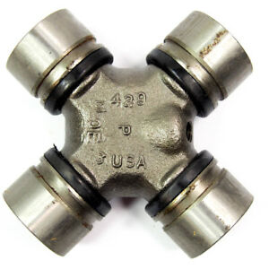

    I have 2 questions :
    1. what is the difference between
      [​IMG] [​IMG]
    2. How to link U-joint to frames ? FIX at the base and rotation free at the top ?
    Thanks a lot !

    In my build, I fixed at the bottom and allow rotation at the top.
    That way, the actuator is not rotating.
    I used ujoints similar to the top ones, but with an hole to fix them, take a look at my build https://www.xsimulator.net/community/threads/flypt-6dof-brushless-diy-actuators.10799/

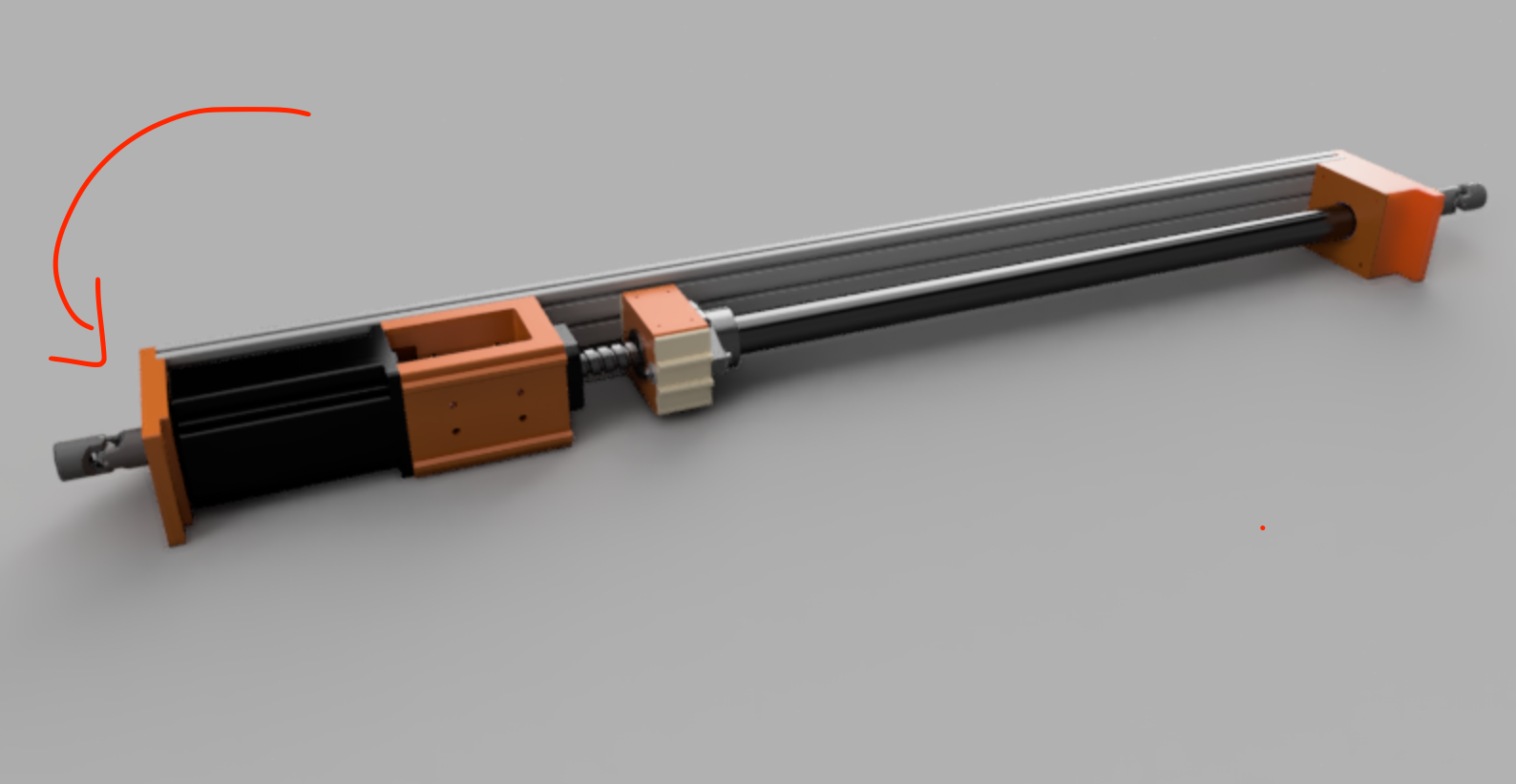

    Hi
    almost a first prototype is finished :
    but some people me doubt on discord : foldback design have a problem with the belt and wobble in some case ?
    could you confirm that or not ?
    thanks
    Edit : inline design :

    The Inline design is better recommended for 6DOF platforms, as you won't have to worry too much for collisions of the motor on the base during extreme angles positioning. This is important when using recessed 6DOF platform designs where the actuators angles are like this:
    If you use foldback you would have to make higher type platform like this:

    ok so the 200mm I loose with inline design is maybe good for the rest of the rig ?

    Hmmm,.... *scratching head*
    How do you come to this conclusion? Is this just a "concern" or are there logical arguments supporting this that I have overlooked?
    I have to admit, I've had similar concerns. But when I actually simulated different rig setups (Fusion360, forward kinematics) and checked for collisions, I found this: The angles I had to go to in order to make the foldback-motors collide with other parts were way outside anything that will ever be possible. More precisely: Every actuator has 5 brethren that will have hit their end stops long before the actuator itself can be in a position that will let the motor collide with other parts.
    Of course, if the lower joints are close together and you have the motors top-mounted, then they will collide. But if they are rotated outwards slightly having the motors off to the outside of the "lower circle", I found it virtually impossible to have them collide with anything.
    In that sense I agree: Using an inline-setup will keep you safe. Using a foldback-setup will require some considerations for the angle of the actuators.
    The bathtub setup (as I like to call it:) does bring it's set of problems, but I don't see any of them connected to foldback motors. As far as I can tell, the top part of the actuators are identical and that is the only part the bathtub will ever get to see.
    Cheers,... Dirty :)

    Go with inline.
    Simpler, less expensive, maybe stronger.
    What you loose at the bottom is nothing.
    I doubt you roll the rig to those positions, because with heave and a recessed cockpit you would touch the ground going so low.
    Edit: Unless you want to change rotation speed between motor and ball screw.

    Hi @dureiken looking at the last 2 pictures you posted i would say the Inline version is much simpler ,
    This could be done cheaply and would only need you to add one extra 5 -6mm plate at the base to mount either Universal Joint or other option ..
    i did a proof of concept mod on one of my 6 DOF actuator and found it very easy to convert from DC motor without encoder to all singing all dance AC servo setup .. So much so that im going to be selling off all my DC gear to re-invest in the AC servo route ( this is just my thoughts on the way i will do my 6 DOF upgrade...
    The 4 DOF sim i have built is absolutely brilliant for CAR simulation totally in awe of how its performing but think 6DOF is the way to go for Flight simming, im single so i can do both LOL China will be getting more business soon :)

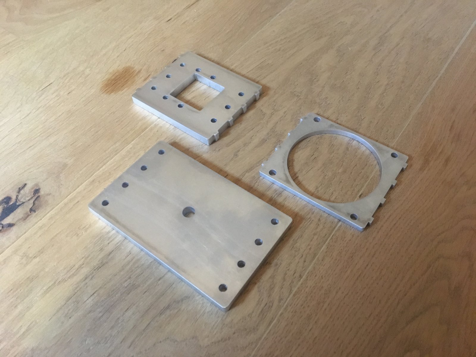

    It sure does! Speaking of design,...
    Do you intend to have all of the load of the actuator on this 3d printed part? Or will the back of the motor carry some of it?
    I am using 8mm laser cut aluminium. These parts were under 10$ a piece.
    And you don't just get a piece of aluminium. You also get "peace" of mind :grin:grin:grin
    • Agree Agree x 3

    Yeah I discussed about that on discord and I will replace this part with 5mm steel because it sees all the load.
