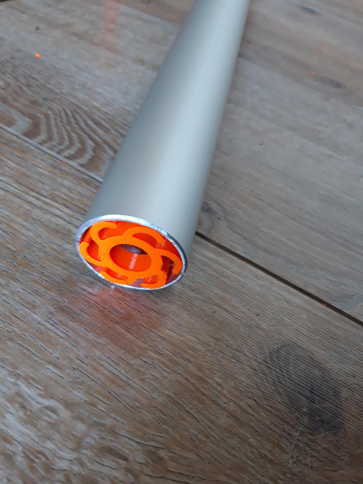

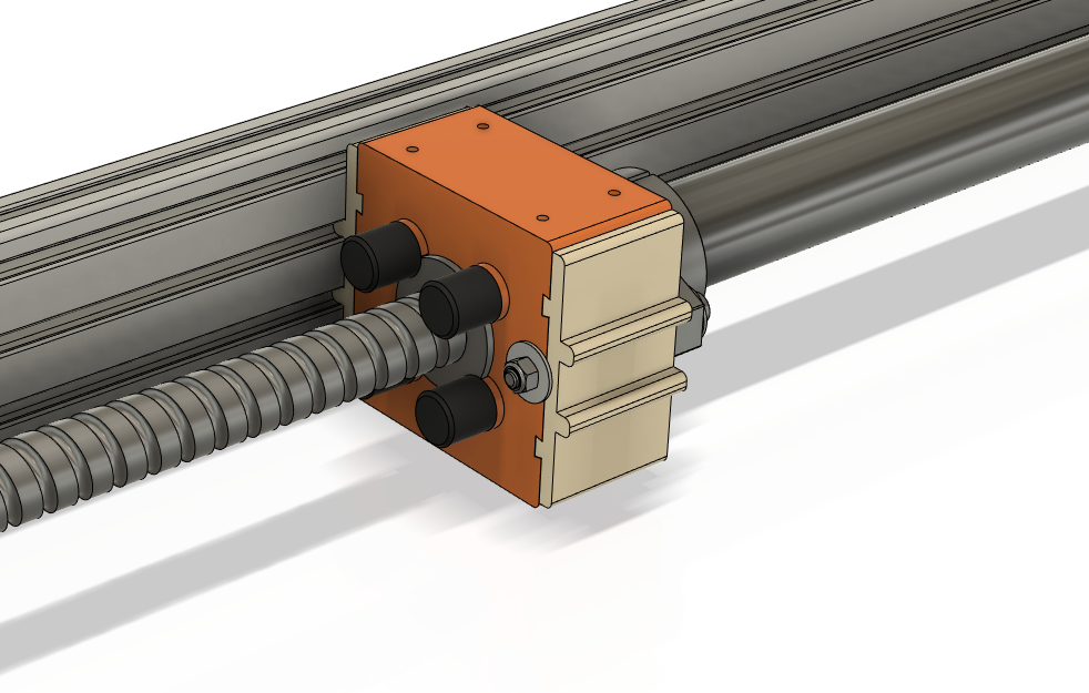

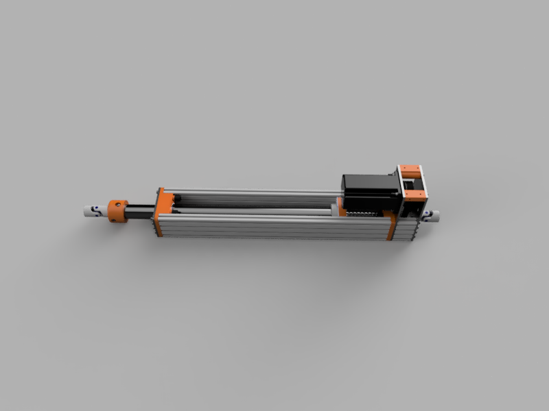

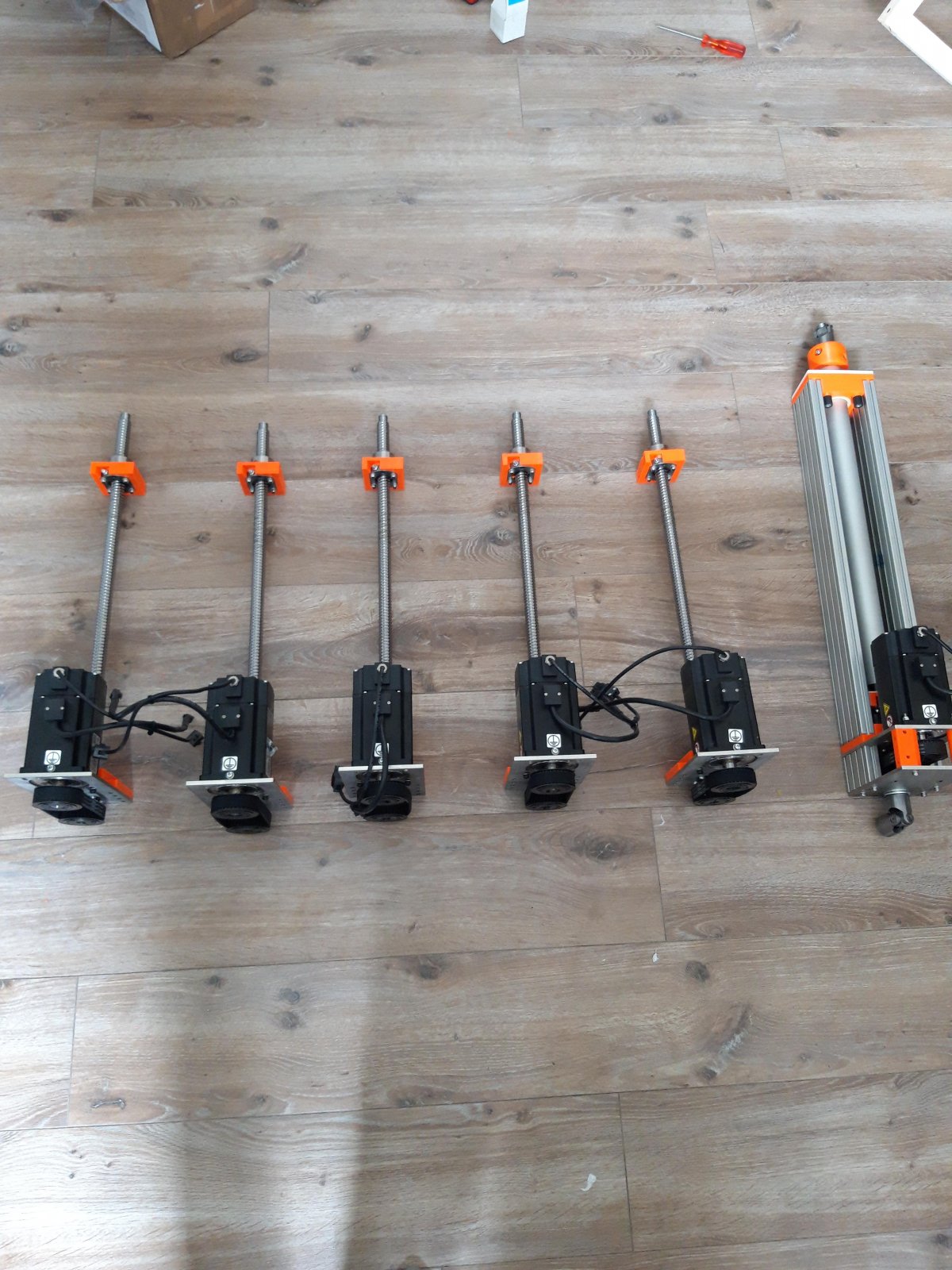

    Thanks to @thefost and @Peacemaker105, I changed design once again, really love this one, which seems to be strong !
    [​IMG] [​IMG]
    And I will try a new link method with collar (OD of nut is 36 and ID of alu tube is 36)
    It makes me win 30mm on stroke VS the previous design (I lost 12mm with DIam40 IGUS bearing)
    Don't hesitate to make advices :)

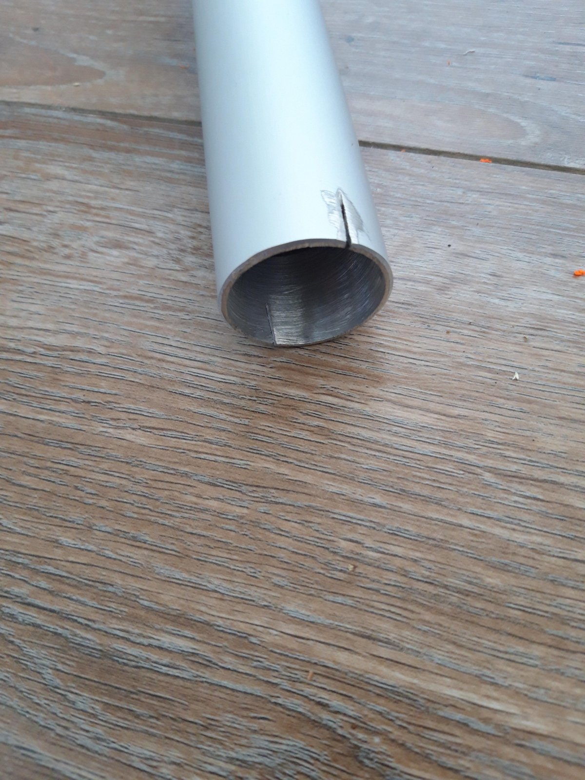

    I went to a local shop and realize that 5mm rod is very ... unstable :p
    So I made a new try with 10mm (tube or rod) and I discouple base and top rods.
    I had to go to OD120/ID112 tube for pulleys and belt to be ok.

    after a lot of discussions on discord with @Thanos @SilentChill @thefost @MagicMunkyNuts @Peacemaker105 @pmvcda (thanks to them), I choose to go with beam design which seems to me a lot easier to build. And tubular/cylinder design seems to be not very silent as it seems.
    [​IMG] [​IMG]
    Orange parts are PETG, white ones are IGUS filament and the bearing is a IGUS J https://www.igus.ee/product/66.
    And maybe because I already received all the beams :p
    Final stroke is 530mm, for 500mm used in rig.

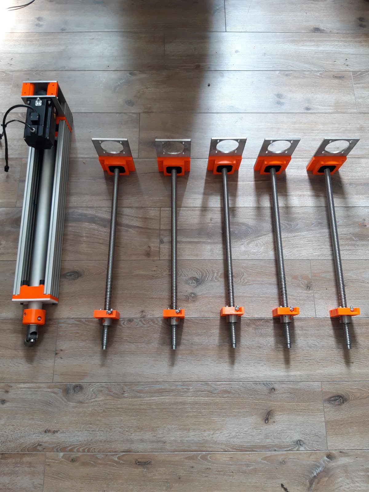

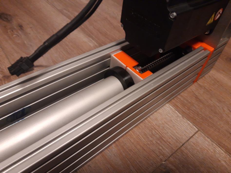

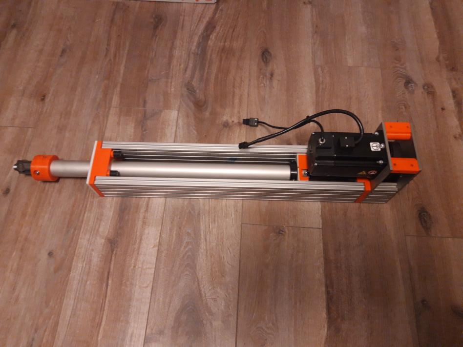

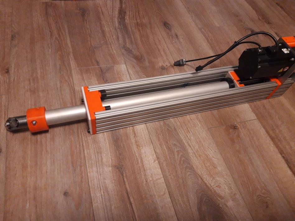

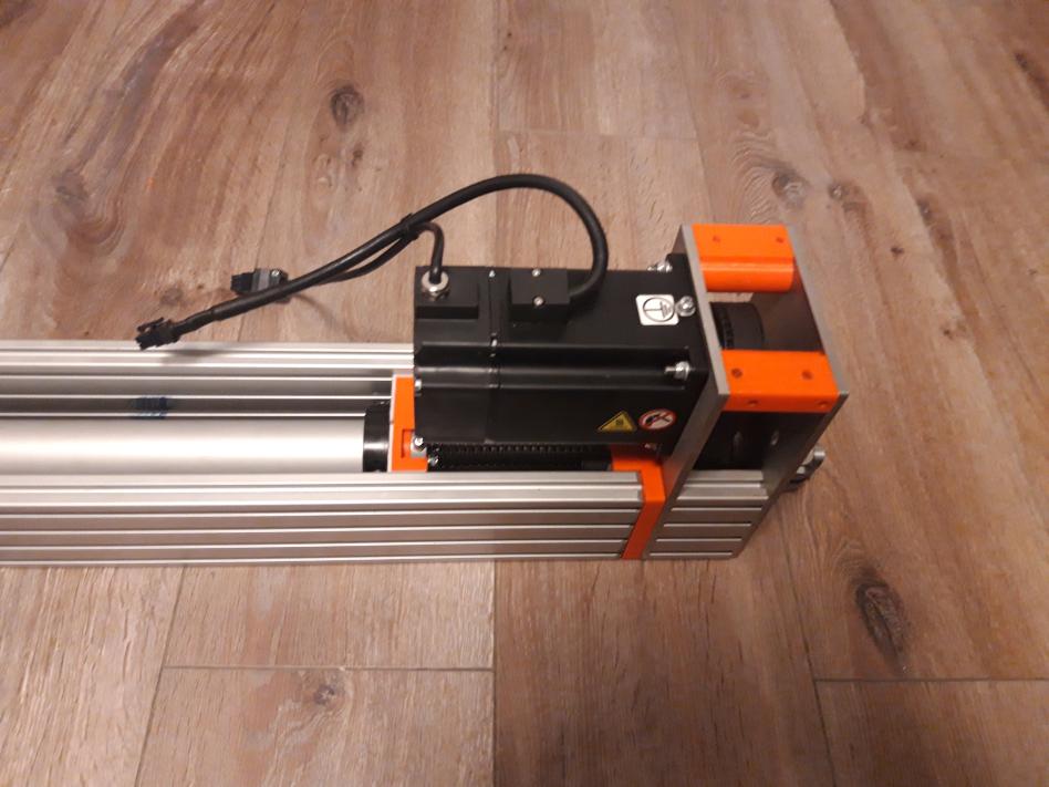

    First actuator finished :
    5b9086b5-65f6-4229-bfcd-31abcce92d26.PNG 20200419_222558.jpg 20200419_222602.jpg 20200419_222610.jpg 20200419_222613.jpg

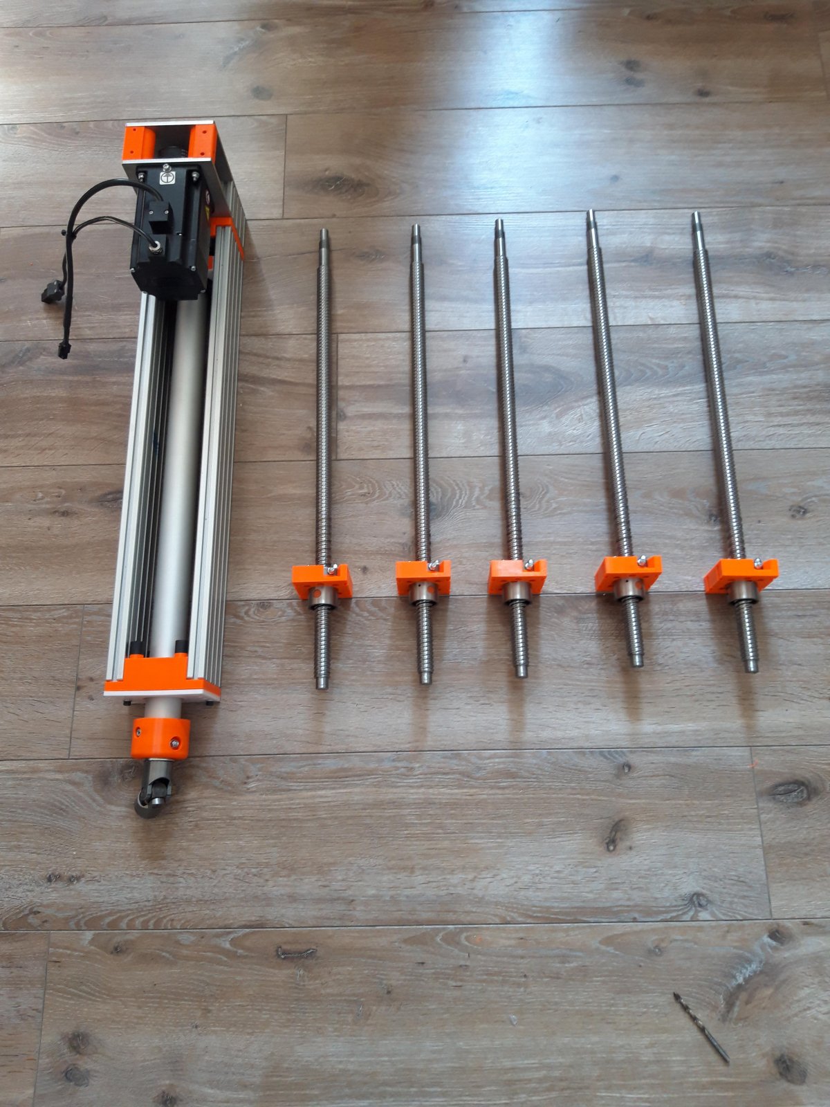

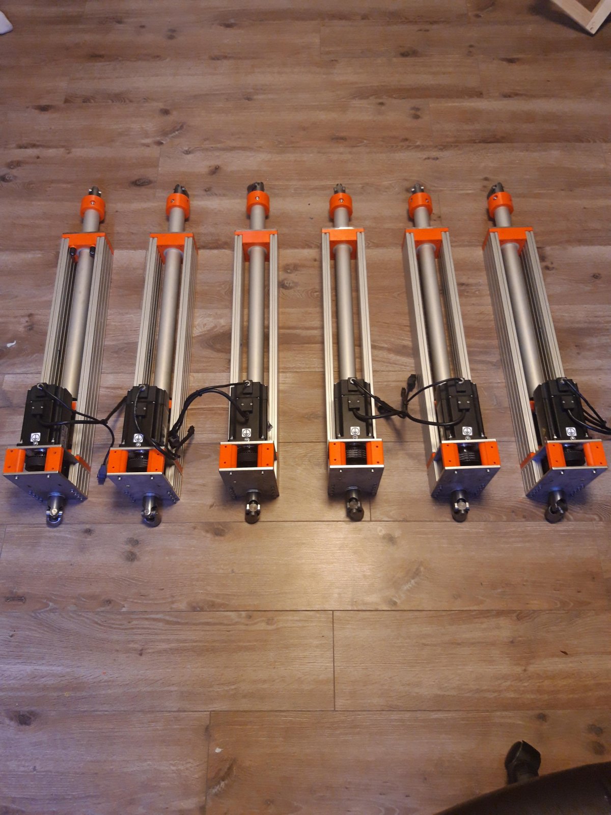

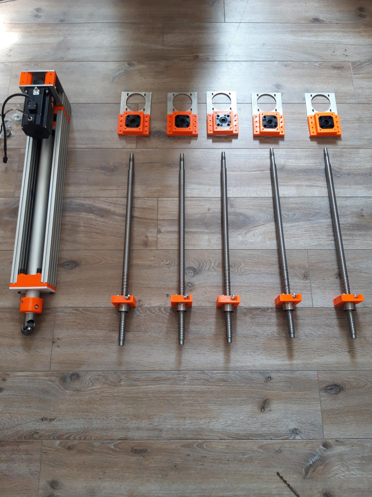

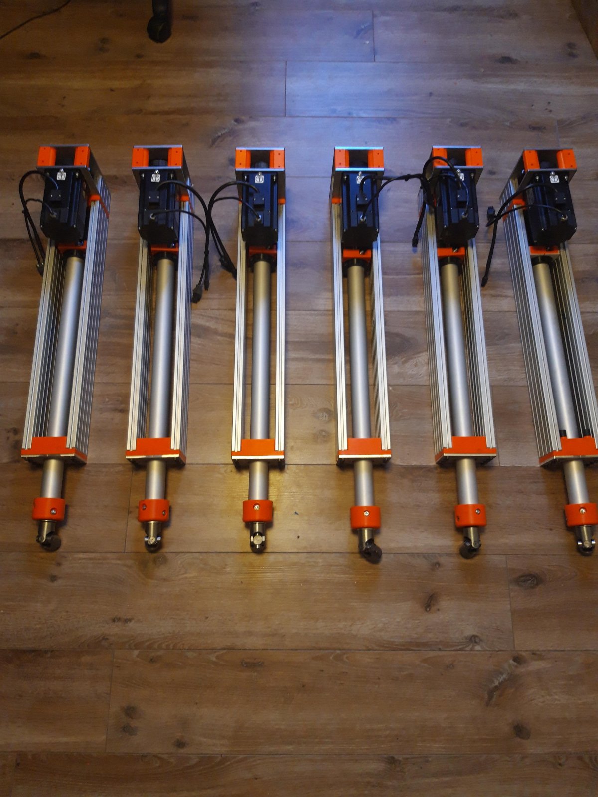

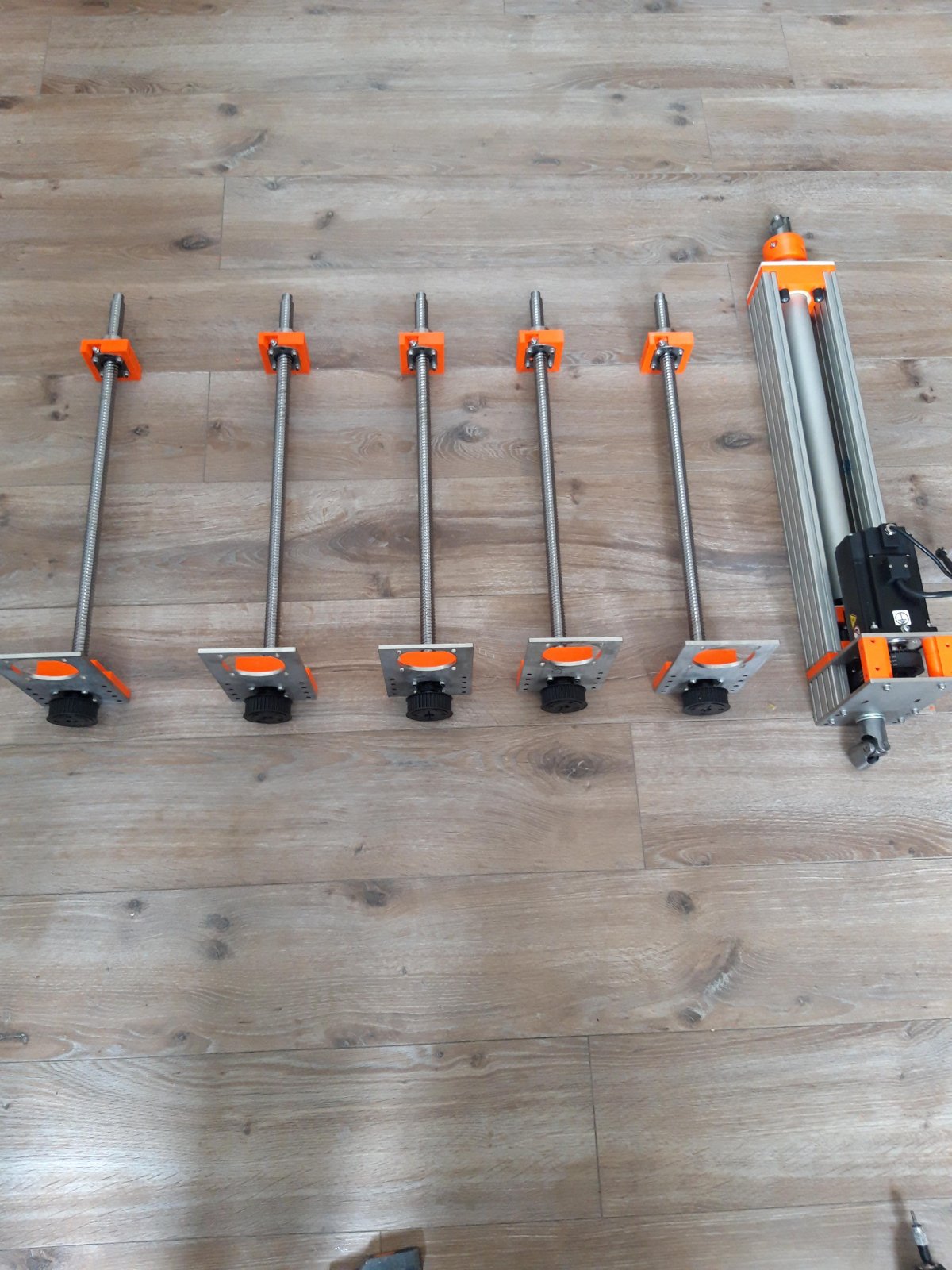

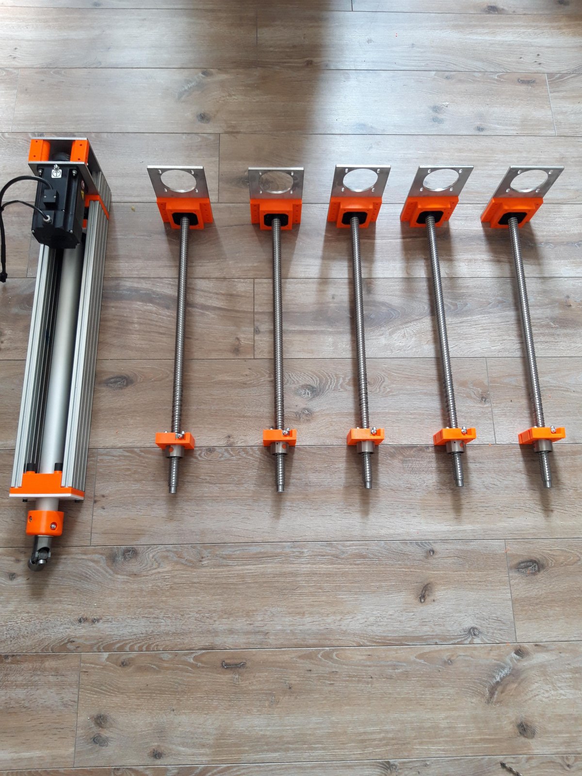

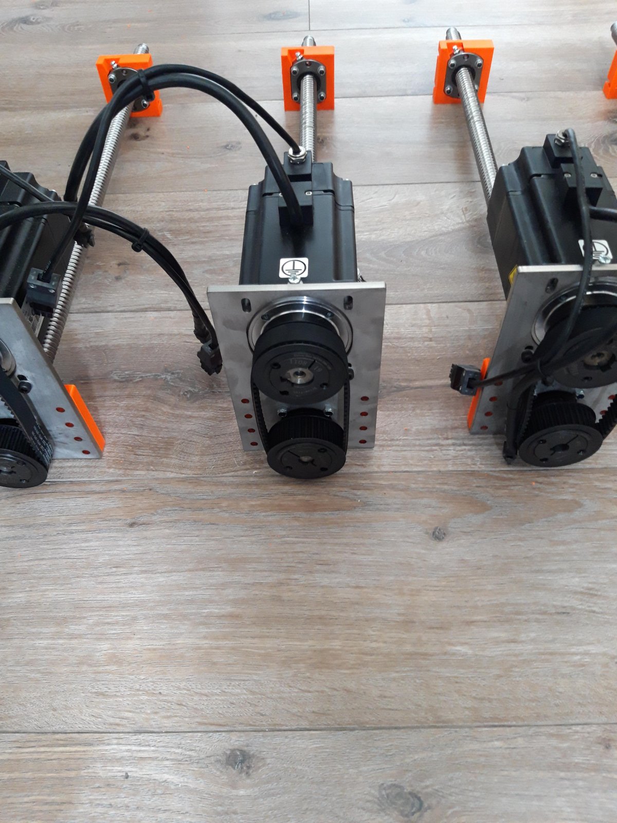

    Hi
    just a little update, I finally built my 6 actuators, seems fine :) need to test them now
    In chrono line, all majors steps :
    20200425_103259.jpg 20200425_104147.jpg 20200425_111124.jpg 20200425_111813.jpg 20200425_113313.jpg 20200425_120117.jpg 20200425_120145.jpg 20200425_154304.jpg 20200425_171843.jpg 20200425_201055.jpg 20200425_201116.jpg
    That's all :)
