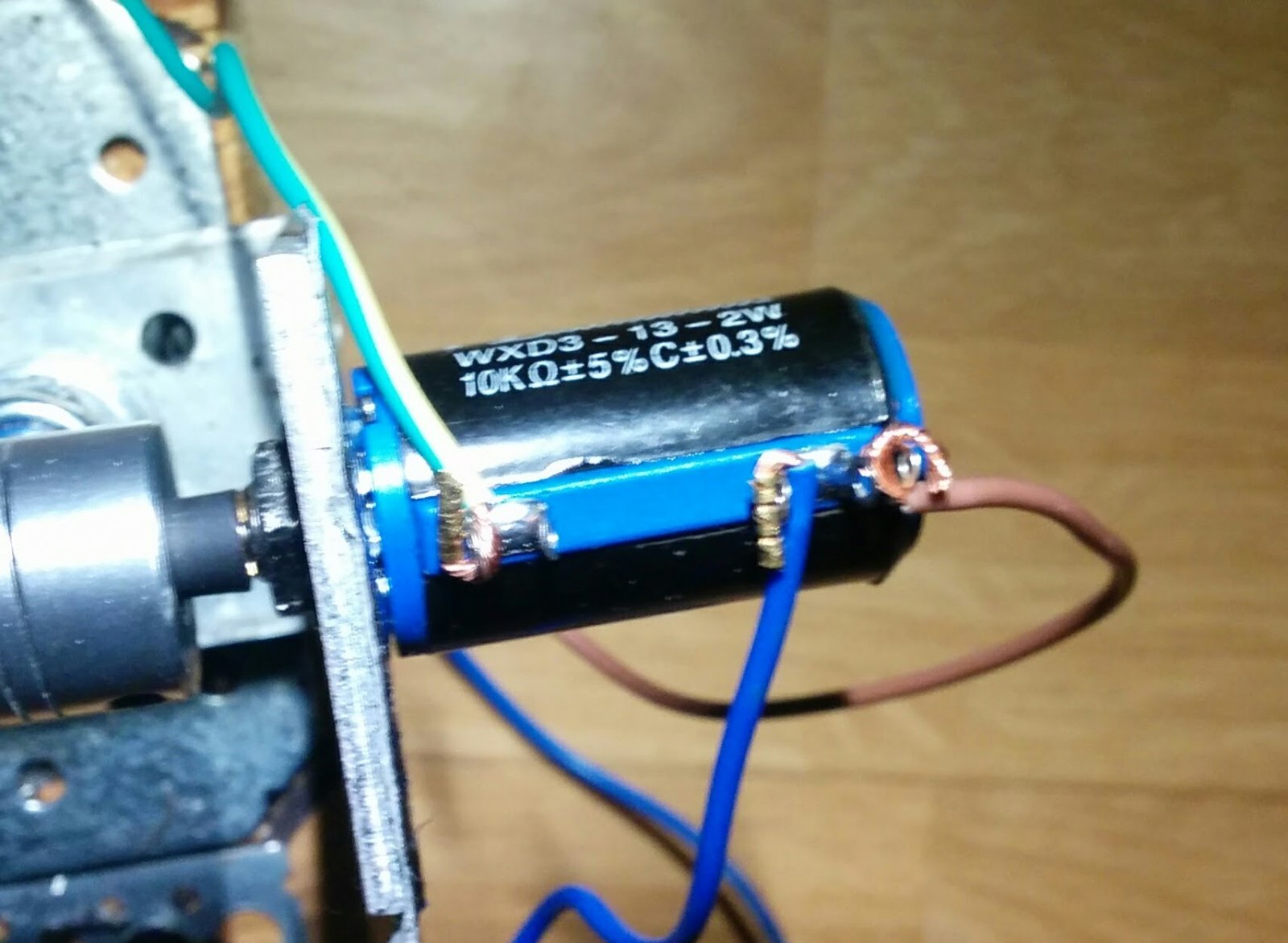

    I switched out the pots to 10 turn wire pots and the right motor is working, but now the left with the same type of pot doesn't. While testing it I see that it only changes direction at the pots maximum turn/value and doesn't stop in the middle like the code had it do before. It worked just fine before with the other pot on this motor and it behaved as expected the the right motor, but the left is messed up. Thought I was done lol.
    Here's the pot, ignore the wiring. The brown is the control and the blue is ground, yellow/green is 5v.
    Edit: Turns out the pot was broke. No problem, it was about $1.50 for two.
