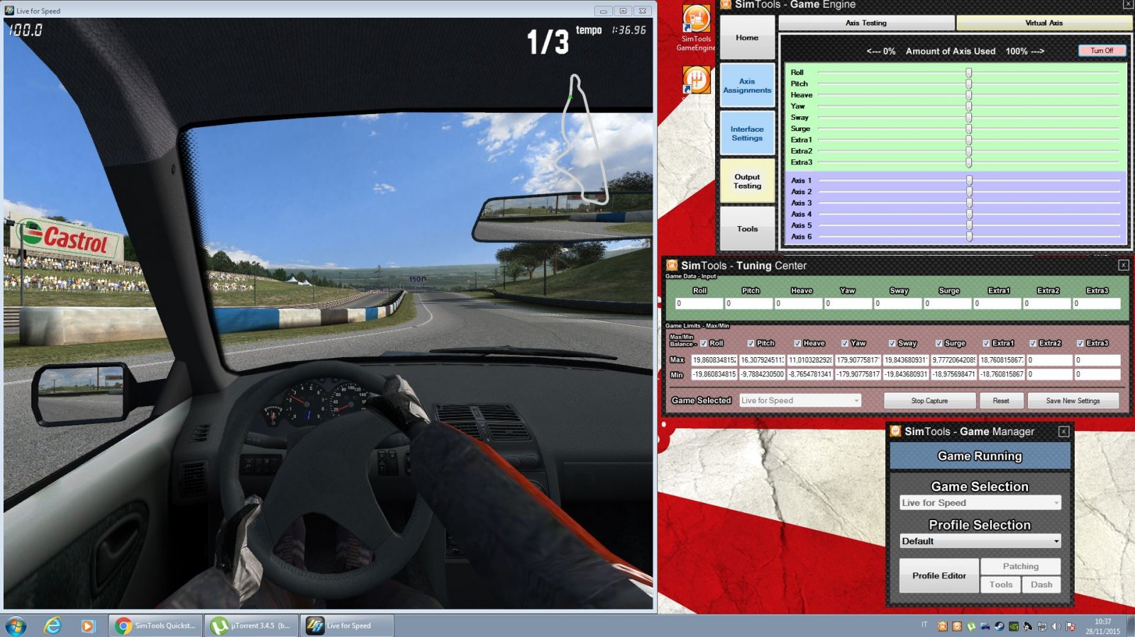

    Good morning at all. I'm trying to uninstall simtools and reinstalling it and follow all of the points of the guide. Try to unpatching... repatching... etc etc but the problem still the same.
    21,712
    151,979Coins
    +11,061 / 56 / -2
    There has been one report of the LFS config file causing a similar problem: http://www.xsimulator.net/community/threads/new-french-with-a-question.7265/#post-85277
    There is also a bug with SimTools and some language settings, try this: http://www.xsimulator.net/community/faq/udp-games-produce-no-output-data.181/
    Are you running any antivirus or firewall software that may interfere?
    If all else fails as the LFS plugin is bundled with SimTools you could try unpatching LFS, uninstall SimTools, do a reboot and reinstall SimTools.

    Hi @noorbeast i've solving the problems. I've select a "Live for Speed" profile in tuning center and re-launch Game Engine and Game Manager with admin rights.
    But now i having another kind of problem....
    When i test a track, the movements of my wipers is too high and too reactive... i've just trying to lowering the force and axis percentage. Any suggestion?
    21,712
    151,979Coins
    +11,061 / 56 / -2
    Use @bsft's guide to set each of the forces individually, starting at 20% with sway then surge: http://www.xsimulator.net/community...-set-up-simtools-jrks-and-write-profiles.112/
    When you have them sorted set base tuning values in the Tuning Center: http://www.xsimulator.net/community/faq/set-base-tuning-motion-values-in-the-tuning-center.122/
    You can the and then tweak the values further with` a bunch of other tuning and refinement tips: http://www.xsimulator.net/community/faq/simtools-settings-tips-and-tricks.18/category
    If you get stuck shoot a video that shows the movement of the rig and the game at the same time and post it here with screenshots of your SimTools Axis and Tuning Center settings, that way the members can give you further advice.

    Now it's all functionally. I've selected the "Save new settings" button and all goes fine. Thanks for support

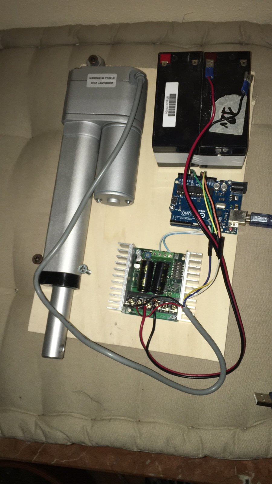

    Ciao @value1
    After many years I reinstalled LFS to do some experiments using a mini reference system (photo :grin) and SimTools 2.3.1.
    Game Manager changes to blue, but I do not receive data from the game (virtual axes do not move).
    Is it possible that the 1.0.1.1 plugin is not compatible with the latest LFS release? (LFS_S3_6U).
    Or Simply the plugin 1.0.1.1 is not compatible with SimTools 2.3.1?
    Thank you :thumbs

    Did you run a race in first person mode before patching LFS for motion?
  14. ilbiga
    ilbiga Active Member
    Apr 4, 2014
    233
    Network Engineer
    103Coins
    +139 / 0 / -0
    Ciao @noorbeast
    Thank you! You're right! :thumbs
    I had forgotten the need to "capture game data" before patching! The problem is surely this!
    I have been using only the RIG PC for many ears and I'm rusted! :grin
    I will check as soon as possible.

    Problem solved! It was very simple! o_O
    New tests started! :cheers
    Thank you @noorbeast
