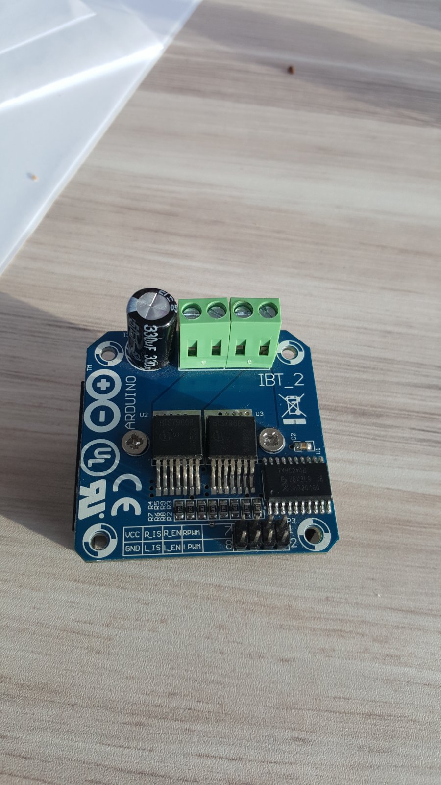

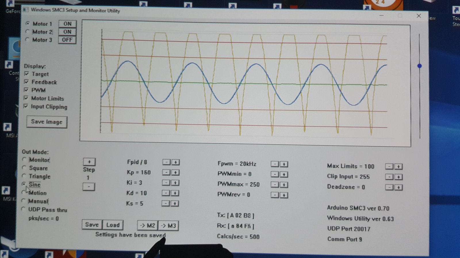

    Just thought I would provide a little info on a problem I had recently with my DofReality P3 rig.
    I few days ago I noticed my right hand motor wasnt moving. Pulled up SMC3 and the motor trace was showing as attached.
    After some swpping around of connectors etc to isolate the fault and discussions with Igor, the problem was traced (hopefully) to the motor driver BTS7960.
    Fortunately I was able to locate a place in Malaysia where I could buy Arduino stuff and was able to have a replacement motor driver posted to me.
    Fitted the BTS and tested the rig and all is well again.
    Thanks to Igor for helping me troubleshoot my problem.

    Thanks Andy for the input. I think you may be on to something. I tested both motors with the SMC3Utils based on DOF Reality guidance, and one of the motors is giving the jerky motion when trying to match the sine wave test. It also happens to be the motor with the extra weigh on that side (HOTAS and gear box). Will see what they come back with, just sent them my results.

    Looking at the trace on SMC3 the green line still doesnt follow the blue line but it's not far off.

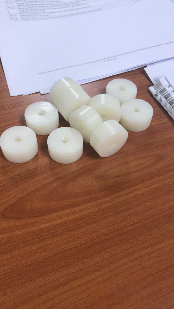

    Changing the subject completely.

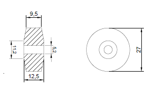

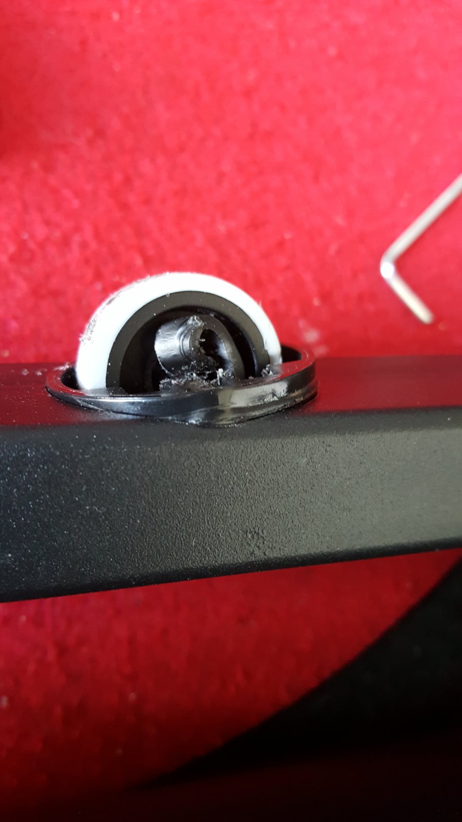

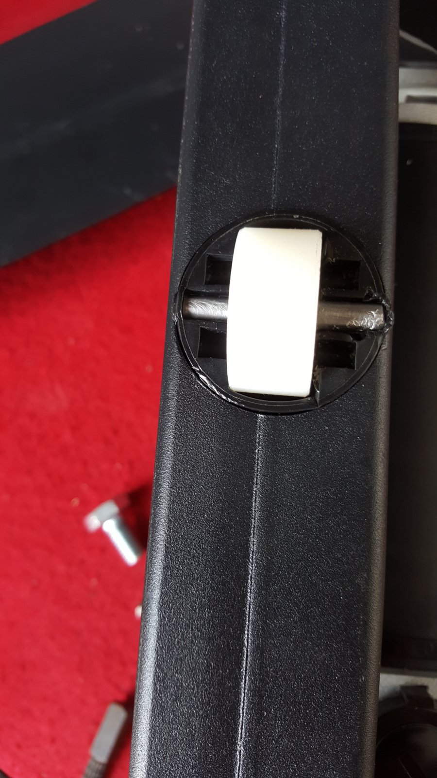

    Those of you with a 3Dof rig (and perhaps if you are a little heavier than ideal) please check your traction loss rollers.
    The 5 rollers supplied by DofReality (2 at the front and three at the back) are not really fit for purpose. They are wardrobe door rollers and not designed to take a lot of load.
    I had some new rollers made from nylon and replaced the existing ones. I used nylon because there was some available and the material is quick and easy to machine and doesnt need lubricating. Aluminium would also be good but some oil or grease between the roller and the axle would be needed.
    Rollers are (sorry Americans, this is in metric) 27mm outside diameter 12.5mm thick with a 5.2mm hole through the center.
    It's a bit of a bitch pulling out the existing rollers and pressing back in the new rollers but once refitted, and after a few weeks trial, I have to say it's a complete success.
    You will notice, in the third photo, the roller is rubbing a little against the side of the cutout. The roller width could be reduced a little but keep the width at the hole 12.5mm. Something like the diagram below:
    Hope this helps guys
