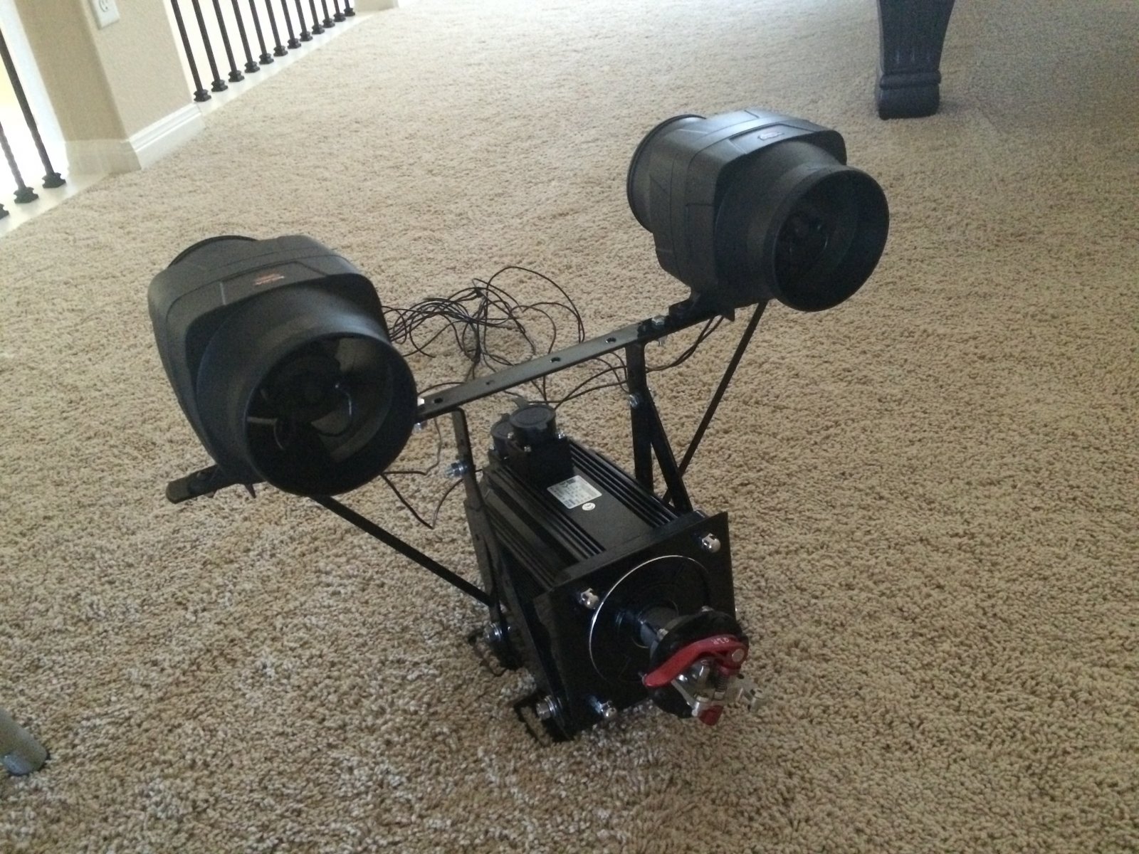

    Where can I get these fans please?
    Thank you.

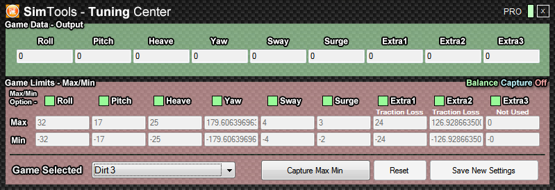

    so i just tried dirt 3 with the presets given by dofreality...
    i used the simtools plugins, and i first put it in the game's directory. It was not moving at all, so i saw a thread here saying i have to put it in my documents->my games->dirt 3
    i did and it is now moving, but it is SOOO messed up. I put the preset for dofreality dirt 3 profile (this worked perfectly when i added the presets from dofreality to assetto,PC2, and dirt rally) but for this not at all. i swear i thought i broke my motion sim because of how messed up and random ALL the movements were. The traction loss motor was swinging left to right and i was going up and down and swaying EVERYWHERE as soon as i entered the racing track.
    what could be causing this? i also tried my own settings and it would barely move...
  10. Radioproffi
    May 15, 2014
    133
    Lviv
    1,621Coins
    +88 / 1 / -0
    Did you change MIN/MAX settings in Tuning center?
  11. Mpmo
    Mpmo Member
    Oct 15, 2017
    230
    United Arab Emirates
    1,288Coins
    +27 / 2 / -0
    i never mess with that stuff. Don't even know how to use it heh...you got recommended values i should use..?
  12. Radioproffi
    May 15, 2014
    133
    Lviv
    1,621Coins
    +88 / 1 / -0
    Please change settings like on screen below. You can find this settings in GameEngine - > Tools -> Tuning Center.
    Press Capture Max Min, insert new value and press Save New Settings.
  13. Mpmo
    Mpmo Member
    Oct 15, 2017
    230
    1,288Coins
    +27 / 2 / -0
    oh my godddd thank youuuuu it's working now. How did you get the values? so i can do this for other games too. And do i NEED to do it with games that already work without me messing with these values like assetto corsa and PC2? like..will they make the motion even better than what it already is?

    ahaa thanks! Alright so i read everything. But, from experience, has doing the "capture live in game values" and using those settings instead of the base settings that come with the plugin been better or worse for you? Have they made it feel better than just using the base tuning centre settings?
  16. Radioproffi
    May 15, 2014
    133
    Lviv
    1,621Coins
    +88 / 1 / -0
    Personal values in MAX/MIN always better.
