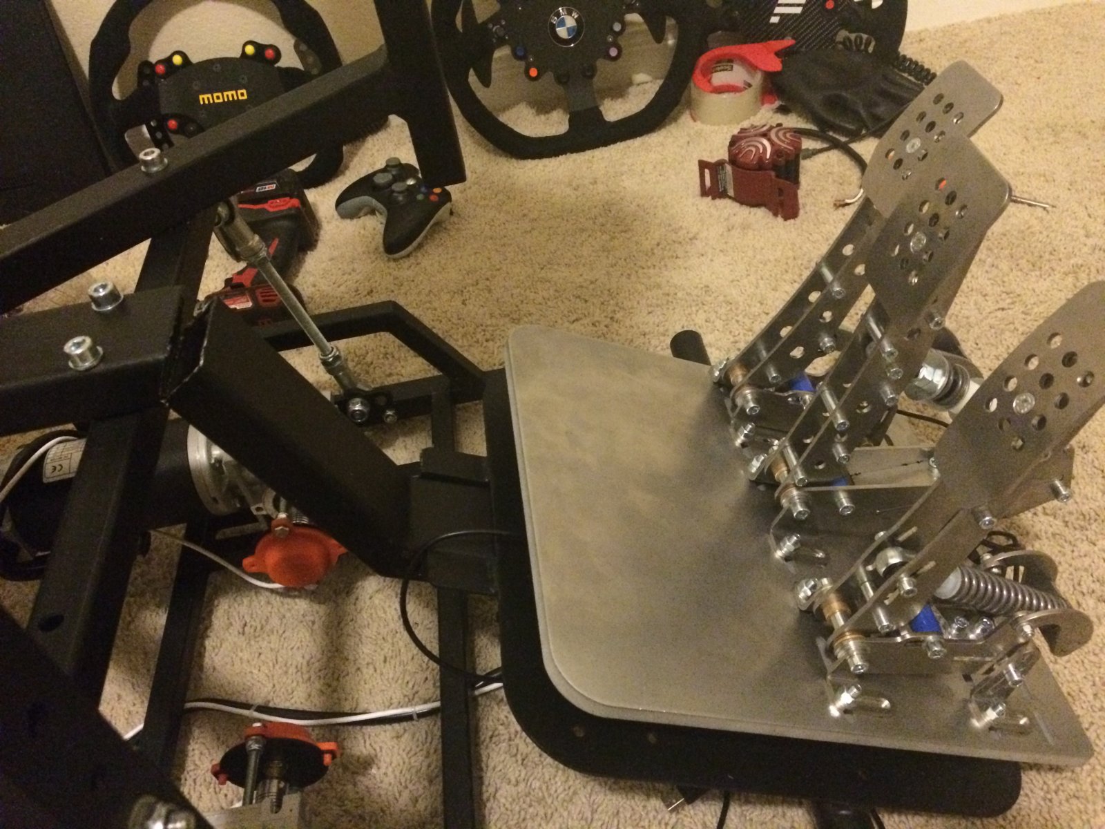

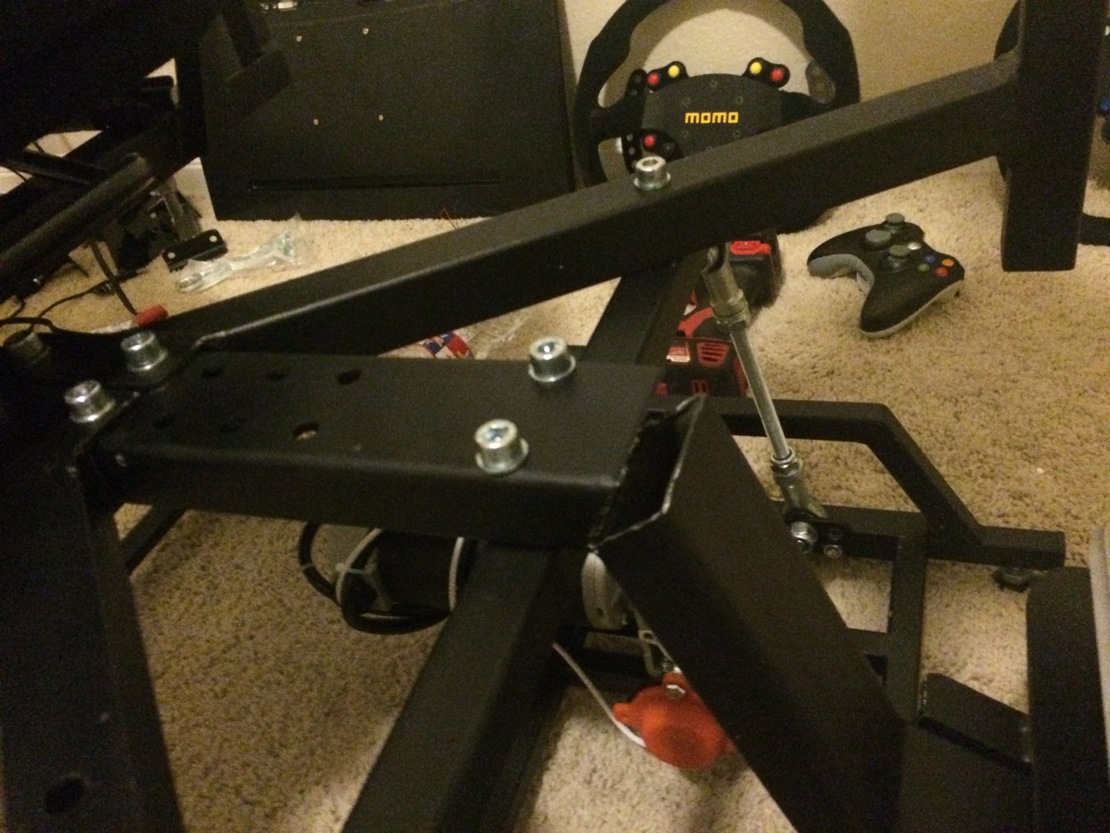

    image.jpeg image.jpeg Lol, no words left but to laugh, I was testing my new brakes and this happened.

    gosh.. i guess you set up the maximum brake force for he brake? mine is set on default but i have a different construction of pedals mount

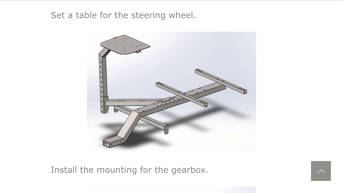

    Could you share how did you mount your pedals? i've been watching the pics you posted, and it looks that you inverted that part of the frame. could you share more pictures please?

    I bought the pro's vs the ultimates because I could see the rig was too weak and still this. I'm going to have to spend even more money again, to make a brace grin the wheel base, over the pedals, and to the front of pedal base. Only problem is I'm going to lose adjustability of pedal base.

    I built my rig just like the instructions. I don't know why it looks like I have something mounted inverted?

    The message was for Hazardic based on this pic...

    Concerning the hazardic pedal mount:
    1. It is massive and will cost a fortune to ship abroad. I is more than 3ft (1m) long and can't be dissembled.
    2. It tremendously complicates overall platform assembly with extra elements and fittings.
    3. There is no adjustment for the pedals angle.
    4. It can't be universal for different pedals brands and models. Even Hazardic had problems with T3PA-PRO

    That is how solid our platform is :
    we test extensively for stress each unit before shipping

    That's all good and well ... but it still broke.
    Maybe it was weakened by you guys jumping on it. ;)

    Yours is the special case, that we have taken full responsibility to fix.
    Now we hiring bigger Testers. That one was only 170 pounds...
    And actually from now on, to eliminate even slim chance of having same issues, we decide reinforce all critical point of the platform.
