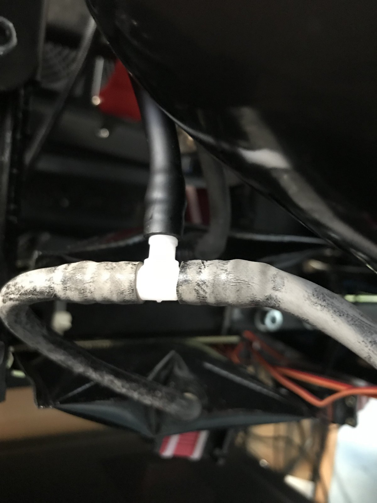

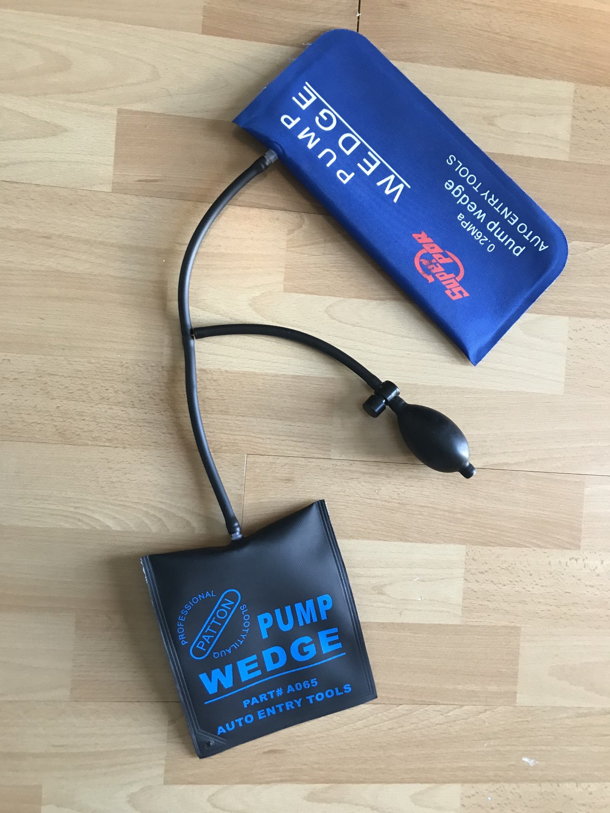

    To adjust pressure and refill I use the pump which is connected with a T. upload_2018-10-21_13-16-4.jpeg

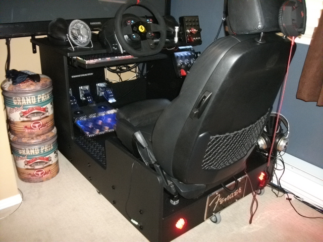

    Currently I have a pair (L+R) mounted to my T3PA-Pro pedal deck, as well as a pair down in the kidney area of my racing seat (again in an L+R configuration).
    I use Lepai A2020 amps to power each pair.

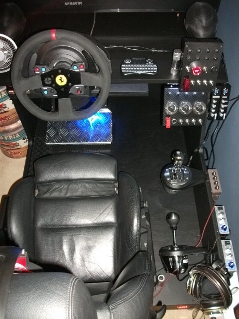

    Here's an old pic of my rig (a very old pic, and prior to adding my 2dof motion platform which I'm currently working on), and you can see the Lepai amps mounted along the right-hand side, along with a 4x headphone amp/splitter box above them.
    Easy to reach out and adjust everything, even in VR.
    Here you can see the two Dayton Pucks which are mounted in the area below the pedals,and just above the steel plate on the pedal deck.
    The two white dots are the 8ohm decals on the face of each puck.
    Because the pucks are located in areas which are in contact with the body (heels of feet + lower back) they don't require a lot of power in order to get their point across. :)
    Much more efficient than large transducers in each corner of the rig...I've never understood the point of that, especially on rigs with small surface areas.
    I've seen a lot of rigs that have their transducers so far away, and on such minimal structural area that the user is probably only actually feeling 25% of what's being generated, if even that.

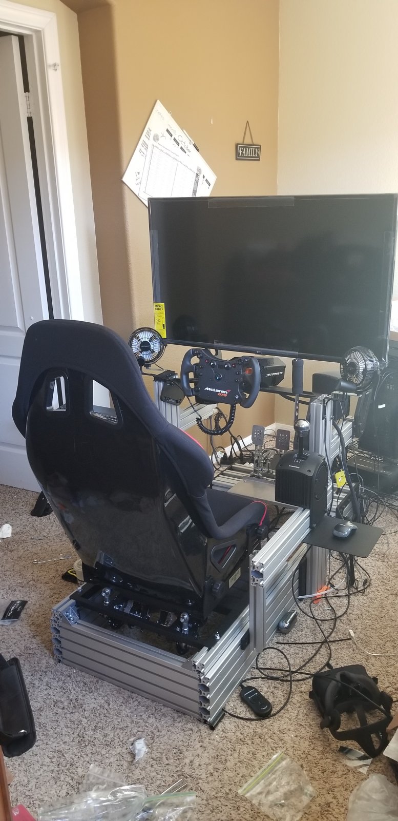

    2DOF, JRK
    What model of the M2 mount did you get? Im also interested in putting one of this on my aluminum profile rig. They have different options in their website and not sure which one fits best. looking at yours that looks perfect on aluminum rigs.
    Also can you do a review on it when you get everything to work?
    Thanks!
