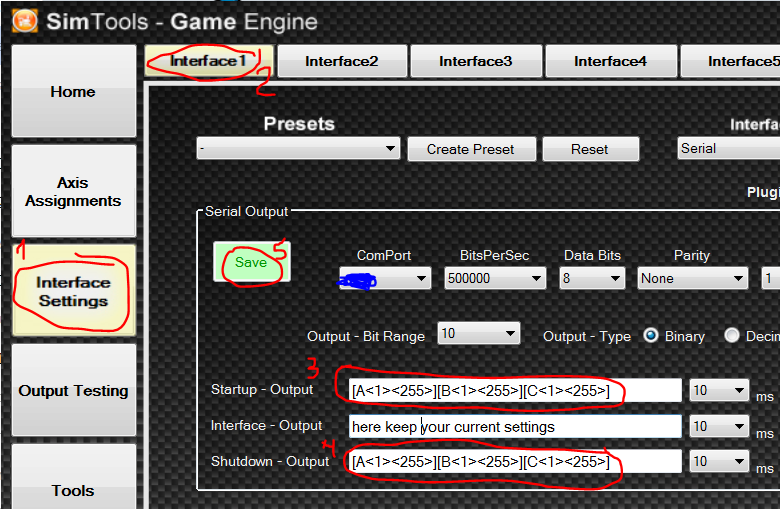

  14. DOFreality
    DOFreality Member
    Oct 30, 2016
    84
    Montreal
    343Coins
    +45 / 5 / -0
    to level platform while not active properly in the interface settings set for Startup and Shutdown
    [A<1><255>][B<1><255>][C<1><255>]
