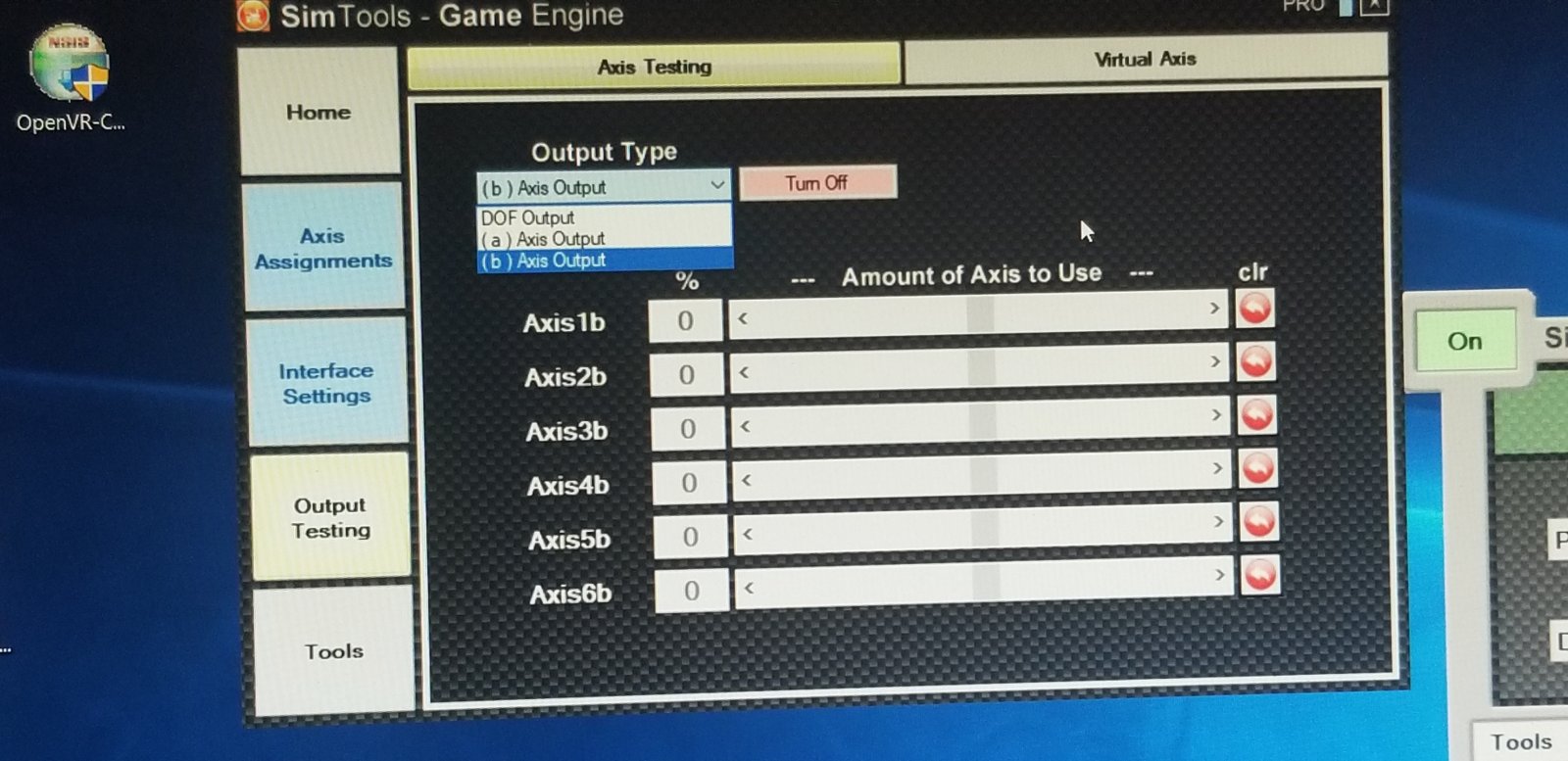

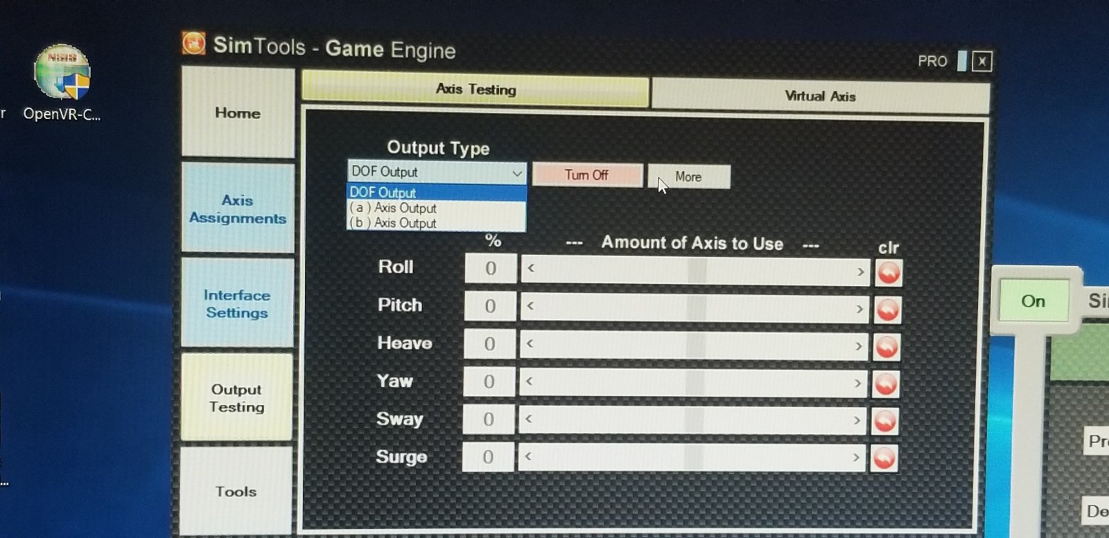

    Hi guys, what is the difference between (a) axis output and 6 dof output ?

    Previous P3 and H3 control box had 2 arduino cards in it and also 2 "com ports". 1 for axe (a) usually used for pitch/roll motors and 1 for axe (b) usally used for yaw (grip loss)

    But mine is a p6 and both "6 dof output" and "(a) axis output" , control my rig.
    "(B) axis output" does not control my p6
    Also when I turn "(a) axis output" on , to test the axes , the movements on the axes are much stronger than the movements with "6 dof output" .
    Why do I have both in there ?

    Because it's by default in simtools that you can test axis (b). But if you didn't setup a (b) axis with a second arduino by example, it wont work. Your P6 only use the (a) axis, that's all. When you test the axis in (a) axis output, it tests the full range of it, that's why it's much stronger. When you test 6 dof output, it gives you the range you've setup ( with the % in the axe assignment ) with the game you've selected to test it. I hope I've answered your questions

    Yes! That is so clear! Thank you so much !
    Great to know that it seems I can test the axis motion range of the game also this way. I did not know that (a) axis is actually the full range of the 6p. Some movements are so wild=cool and now indeed how much are limited in the game because of the low % assigned to the specific axe
