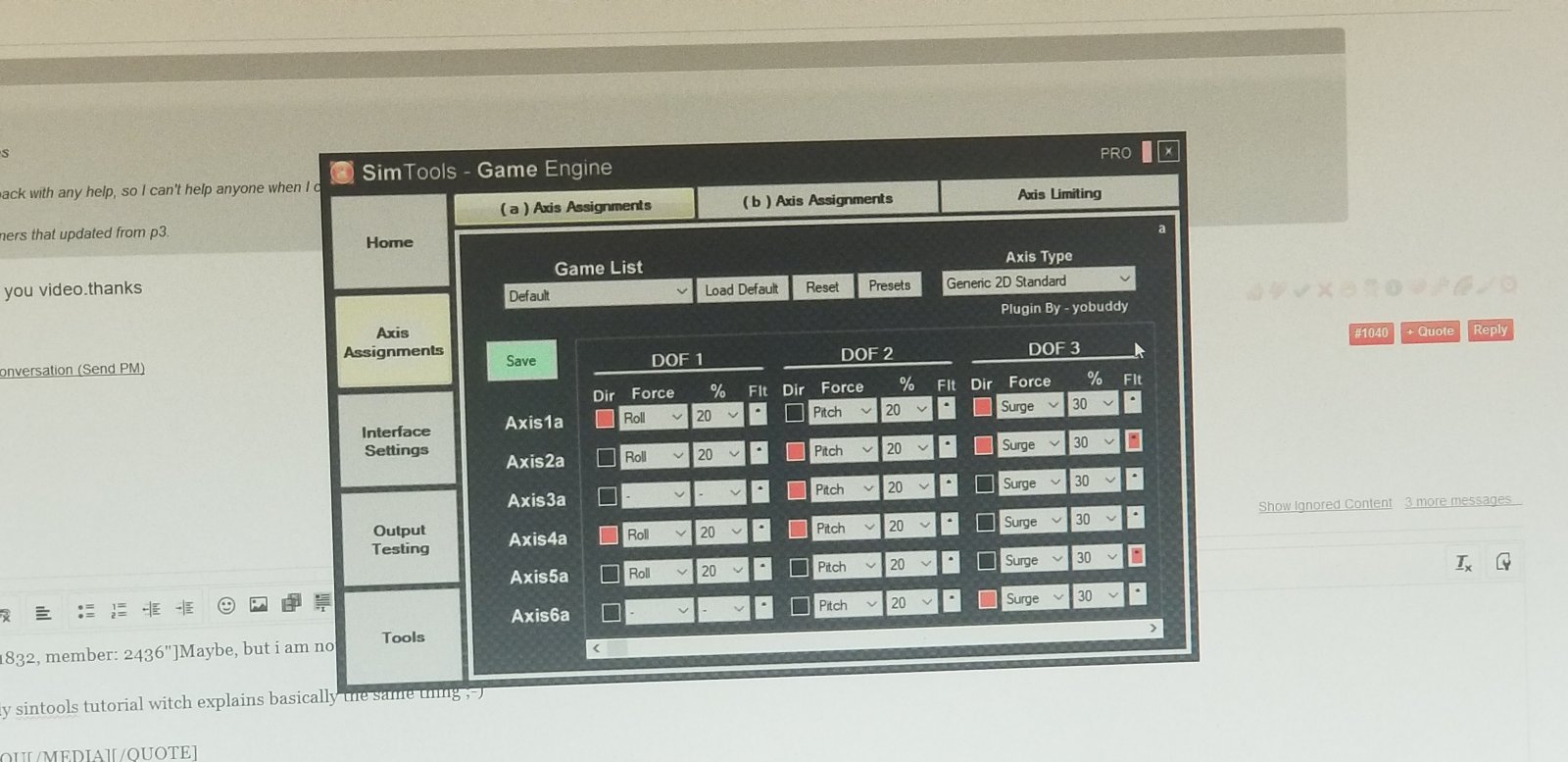

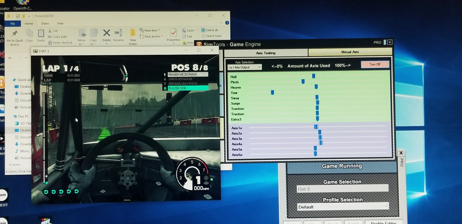

    Can anyone please tell me if it is normal that all these axes move this much when the car is not moving and also some are not in the center ?

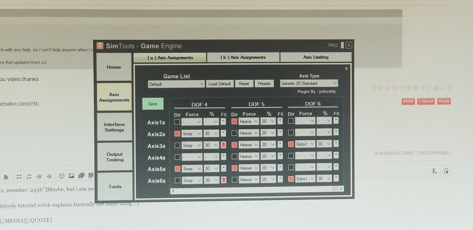

    The p3 setting is way less complicated than the p6.
    Look at the screencap
    The h6/p6 axes setting is much more complicated than the h3/p3 setting.
    See attached screen captures

    No its not normal, Try to patch the game again, and/or check the hardwaresettings config file in your documents/mygames/dirt3 folder.
    I had similair problem with dirt 3 in the past. Also, remember that the game motion goes away after one run, you need to run a special program to avoid that.
    Use this little program
    https://www.stryder-it.de/simdashboard/help_dirt3crash.php

    Just remember to also use the tuning center ;-) and go one DOF at a time

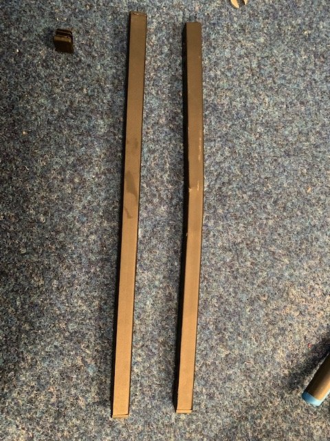

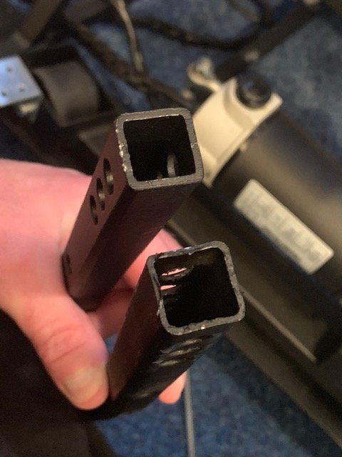

    I had the same issue, emailed DOF and got thicker replacements without any discussion.
    I must say, customer service is great !
    Here are some pics
