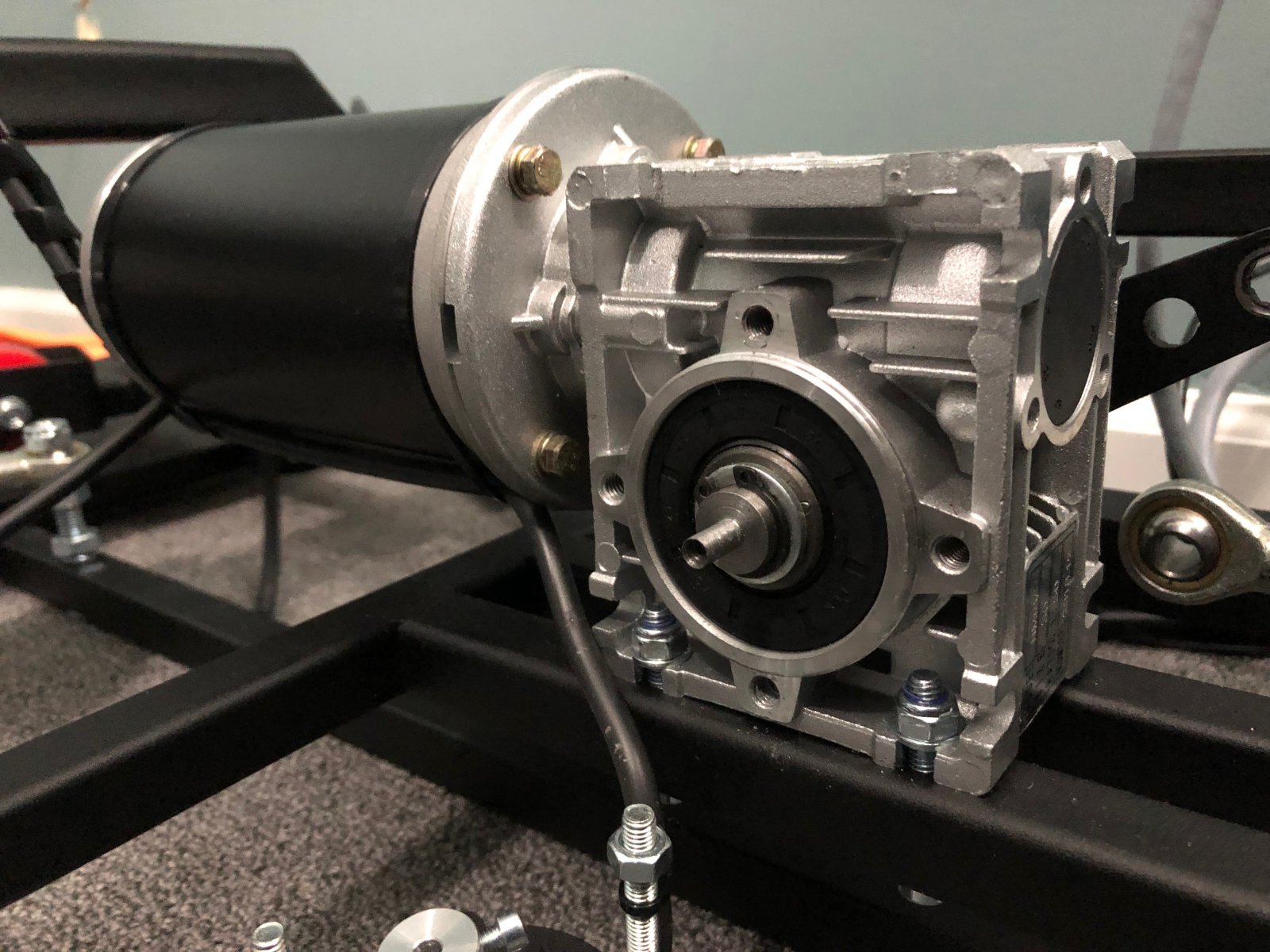

    I have an H3 and one of the gearbox's broke so they shipped a new one but I'm not sure how to replace it. I have most of the original gearbox unscrewed but I can't figure out how to remove the shaft that goes through the middle of the gearbox. Anyone know how to do this?
  12. mrfurious214
    mrfurious214 New Member
    Jan 3, 2019
    6
    51Coins
    Figured it out...there is a little black clip that needed to be slid off first :)

    Does anybody have a video example of this 'slack' - I can't figure out what is supposed to be normal and what is not. There seems to be a decent amount of play in the rig.
  14. mrfurious214
    Jan 3, 2019
    6
    51Coins
    I don't have a vid but the normal amount is quite a bit. It's a small movement at the gearbox but that translates into lots of slack for the rig in total. I got used to it quickly but it practically eliminates the fine/small movements of the rig :(.

  18. rsbell
    rsbell Member
    Mar 30, 2019
    34
    334Coins
    +11 / 0 / -0
    No.
  19. adgun
    adgun Active Member
    Jan 28, 2008
    532
    mechanic
    Netherlands
    5,769Coins
    +137 / 4 / -0
    There 6 dof has the slack thing to, all wormgearmotors have backlash!
    But because there design you wont feel it.
    There lowert COG and slow accel. under 1 G takes it out.
    when you go not to far off balance (there lowert COG helps with that) and stay under 1G there is no backlash.
    But there slow accel. takes a lot off fine movement out
