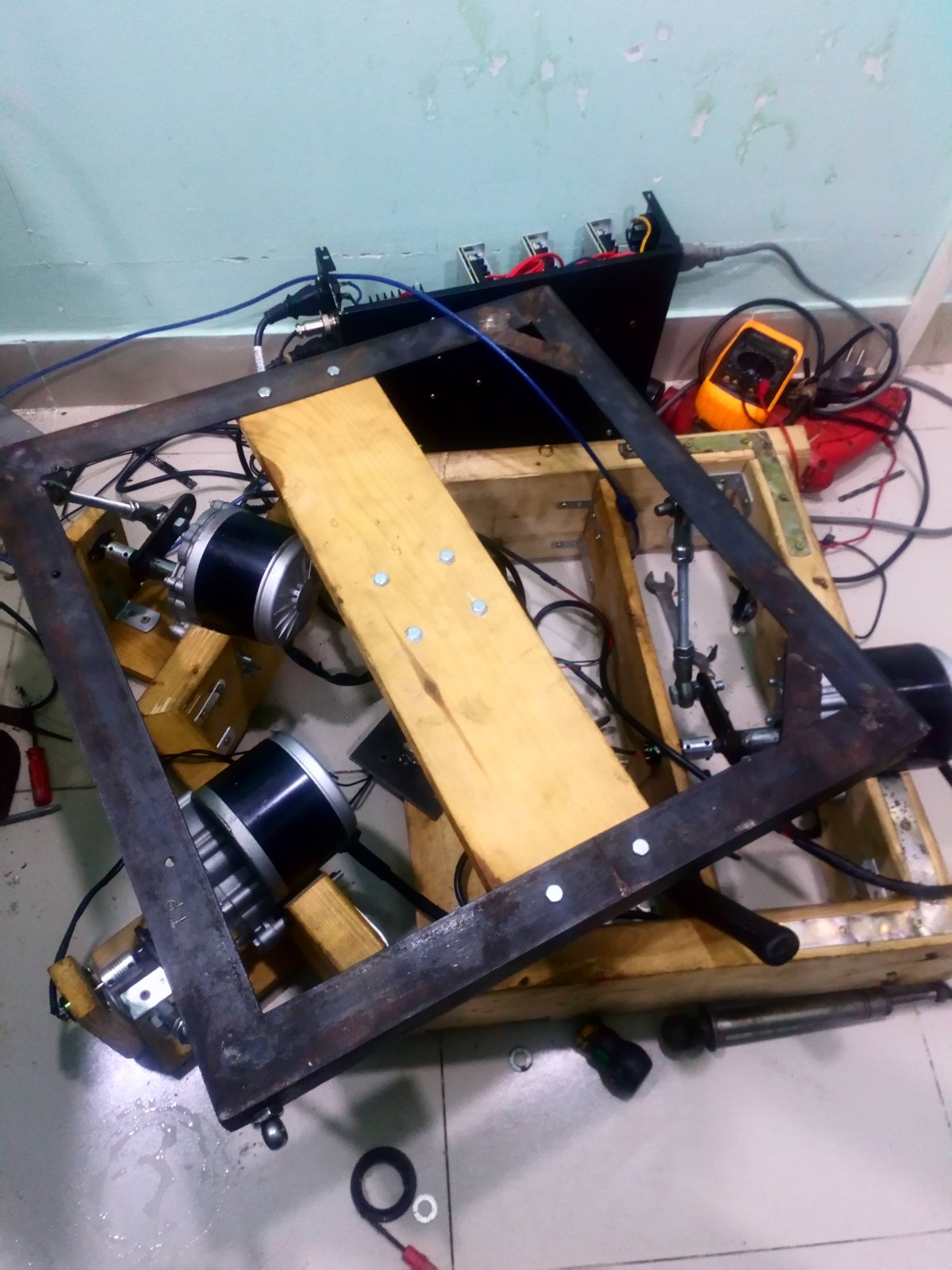

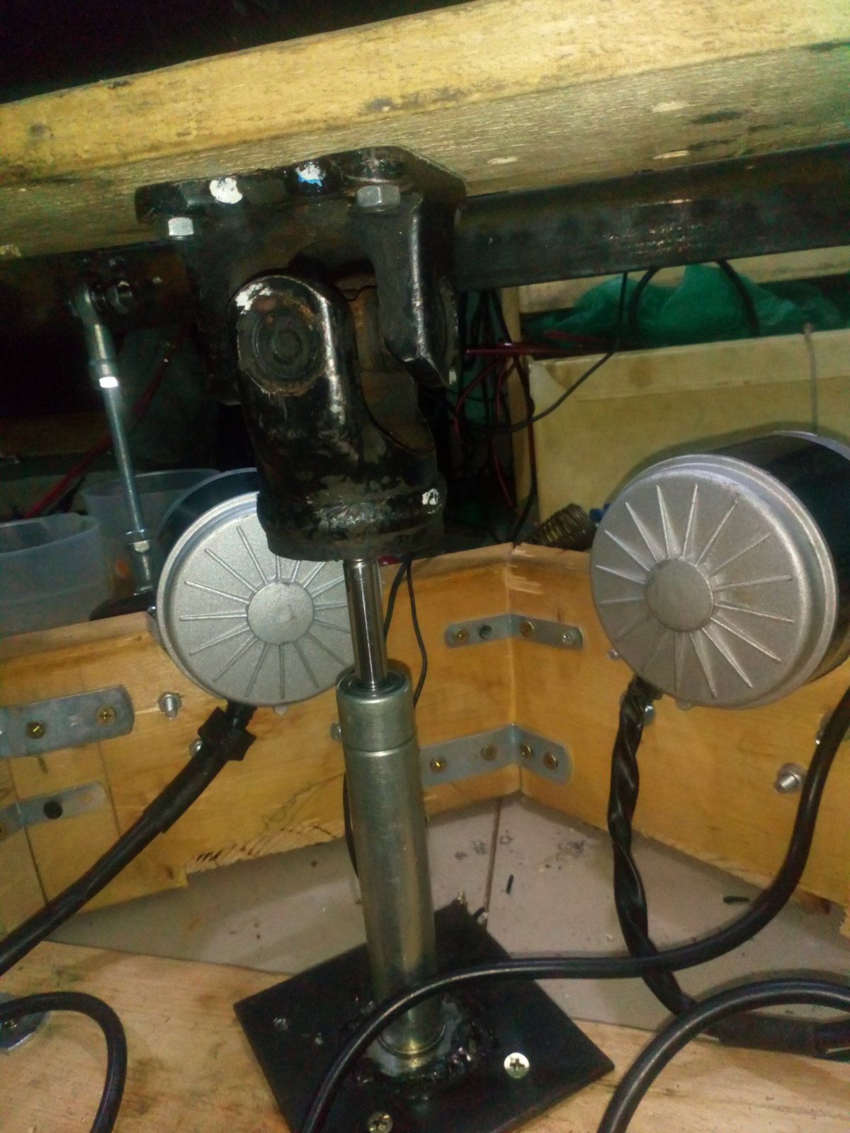

    -if 3 motors have such cardan joints in the article, will there be axis "heavy" in simtool? 3 motors will not be able to go up and down at the same time.

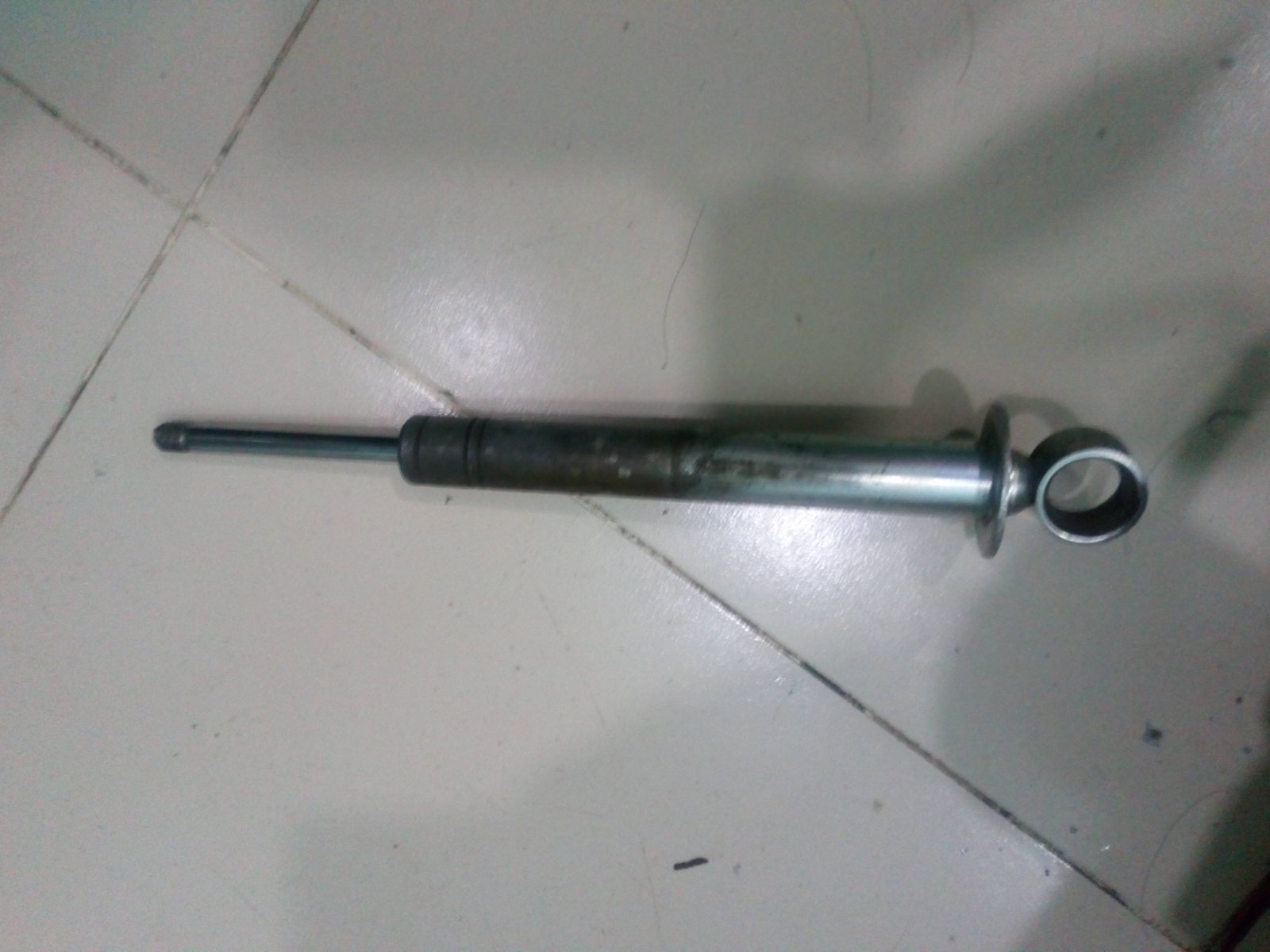

    -i am testing 1 spring inner core has damaged no oil inside to go up and down gently but the upper iron frame is tilted by rotuyn joints. Should I try 4 cores mounted below the cardan joint?
    - I use Google translate. hope you will understand

    1 axis will not hold the frame above it will tilt
