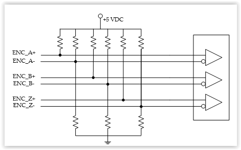

    Hi - do you have a picture or two of the exact way the pull down resistors were wired (or a drawing)? Thanks in advance, Allan
    "So with soldering iron in hand I added pull up 1k resistors to encoder inputs A , B and Z ( index ) , but no result , then tried pull down resistors as i think pull up is for an inverted signal , pull downs seem to clean up the RF a little while pull up seemed to make it worse. after scratching my head pulling apart both motors, moving cables , then finally decided there was to many unknowns in the existing cables so I will just put in new shielded cables to the encoders and bypass all the junction boxes and plugs I had spent hours testing see what happens.
    Seems Quadrature encoder inputs are very sensitive to RF noise , and after putting in new shielded cables it looks like the problem is now gone ( solved YAY ! )
    Now both encoders are getting clean data , theres a chance the teach tune may actually work , and it did :)
    And not to forget a big thanks to Dimension Engineering and their Help Desk for the fast responses and great suggestions that helped immensely with working out what was going on with the encoder problem, got to love it when you buy a product and can actually get some support, well done I recon."

    This is just an schematic i grabbed from the net but shows clearly the use of pull-up and pull-down resistors , I used 1K ohm .
    Also ground the cable shield on the cable to the encoder only one end prevents ground loops and reduces RF from motors.
    The encoder in the image has signals inverted and non inverted , the kangaroo worked with either but i used the non inverted set of signals.
    You can of course use both pull up and pull down, pull down means that the signal is grounded via a resistor of 1k to ground or negative , for a positive going signal that was all I needed.

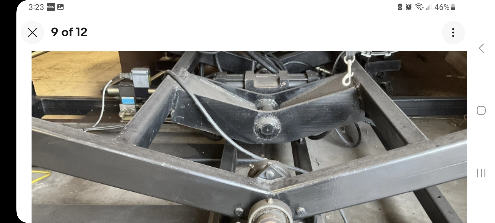

    I have an M4 motion theatre. How do I find out it's value

    problem with the M4 is its dangerous , gets stuck in the wrong position and then you cant open the door because of the frame , the balance on these machines is bad and the drum and cable for changing the angle is perhaps the worst type of design thought about changing it but we stopped working on it when xsim brought in stupid licencing.
