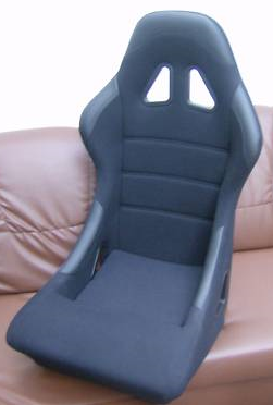

    And for the construction I got this fine seat:
    A nice bucket seat, second hand, merely used (from a car-aftermarket fair for 56€) that makes a comfortable place to be in whilst racing and/or flying.
    I hope in my next post I can present the soldered AMC and maybe the DSMhb as well.

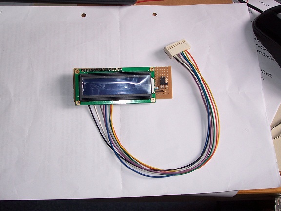

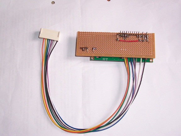

    Edit:
    Hi.
    I would like to present my first soldering-results:
    As blueprints I took this.
    Am I right in assuming the 10 thing is a 10 Ohm resistor?
    If, then I did it, if not I have to adjust.
    The PCB-plates for both the AMC and DSMhb should be arriving tomorrow morning.
    If so I'll present my work in progress again tomorrow evening.
    Cheers, Marco.

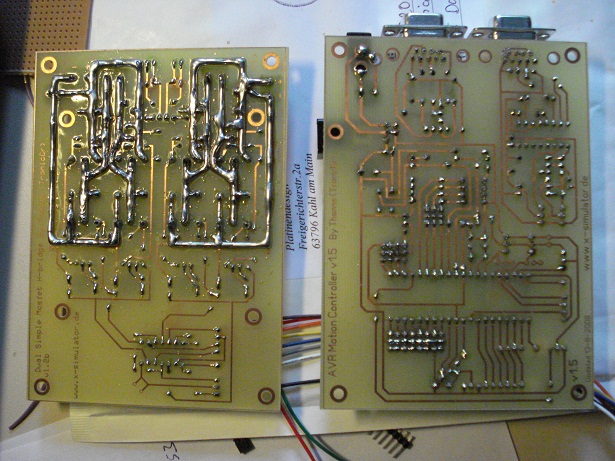

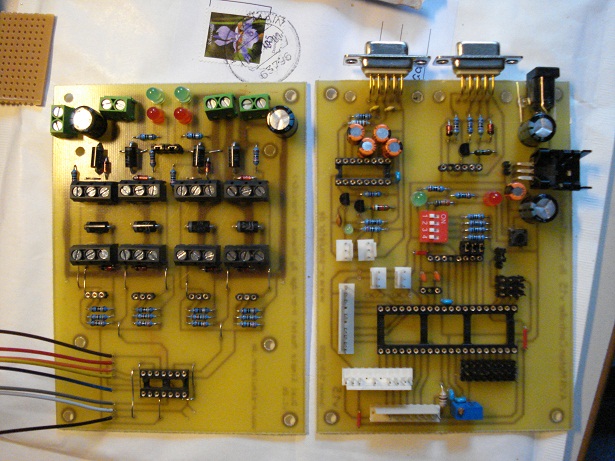

    Hi, unfortunately hotlinking is forbidden and the pics are to big to post via this site.
    I solderd quite a bit on friday and saturday, and these are the results:
    http://pic-hoster.net/upload/15411/oben.png
    http://pic-hoster.net/upload/15412/unten.png
    Now I'm looking for the potentiometers. I actually found them in all shapes and sizes, basically 500V, 300°, 4W from 2,5 to 25k Ohms...what should I get there?
    I searched in the AMC thread, but found nothing.
    Soldering wasn't too bad actually, only the extra on the thick traces made a few problems because they kept flowing into each other, thus creating short-circuits...
    next things for me are programming the ATMega and creating the cooling-system for the MOSFETs.

    Now I'm trying to connect the Force-Profiler, but I cant see the 3 last lines in the USO setup.
    They're just not shown on the the monitor. Did this happen to anyone else?
    Before I can't see this I can't define the output-axis, thus can't continue...
    But the LCD works, including the backlight.
    Nice!

    Last but not least I added the pix of the front and back of both the AMC and double-H, the chips are mounted and the ATMega is programmed (like written in the post above).
