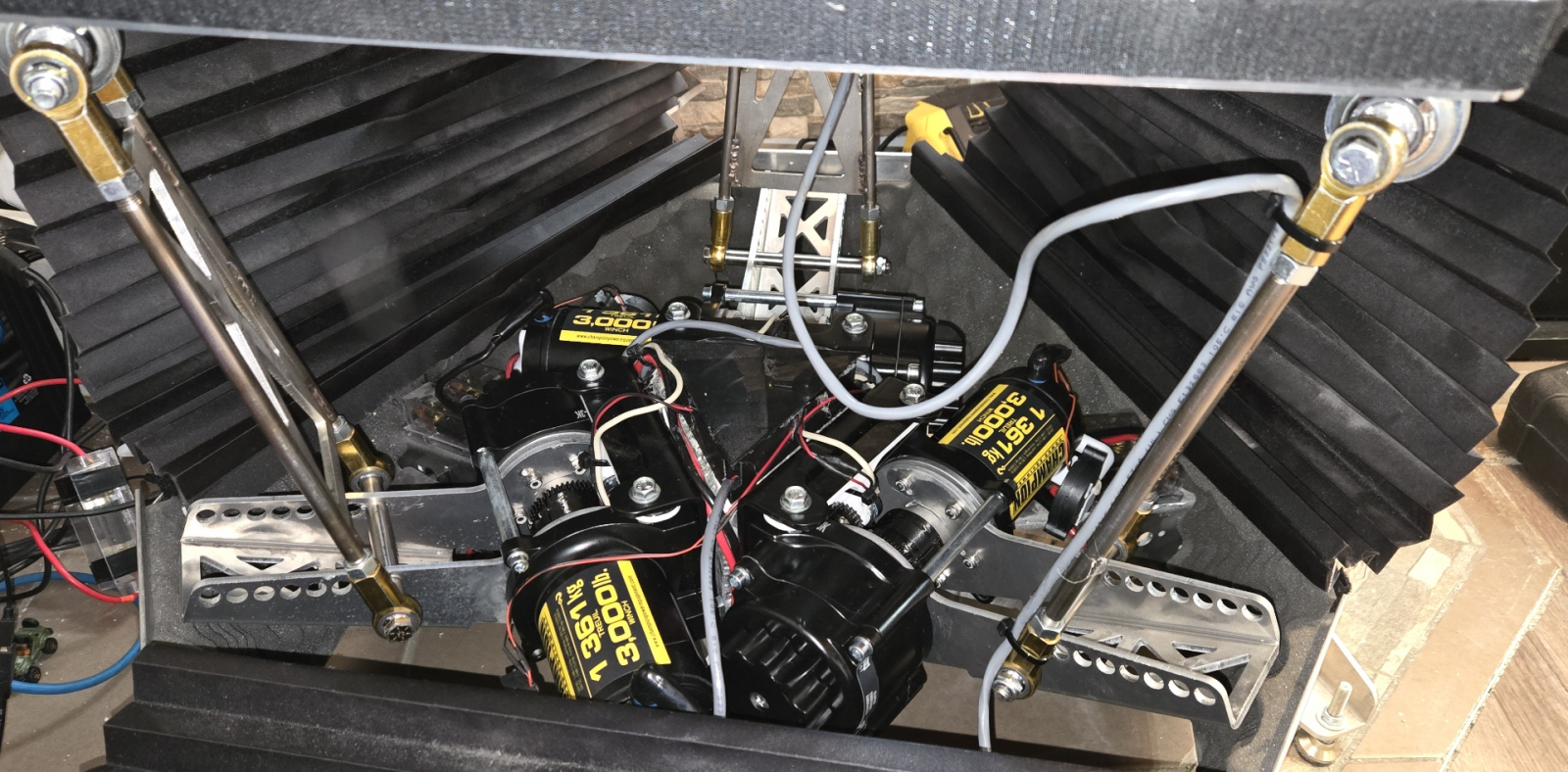

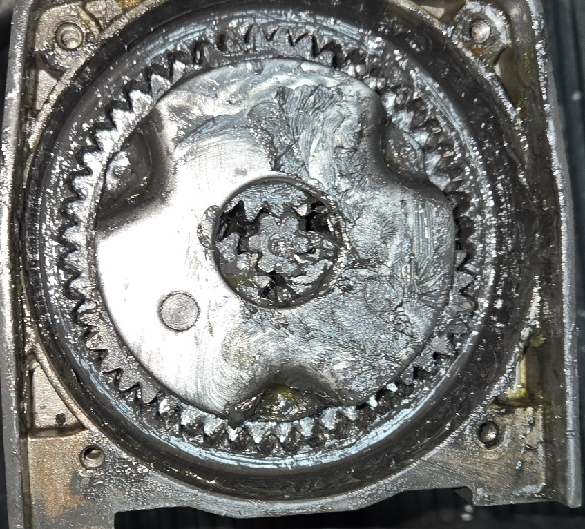

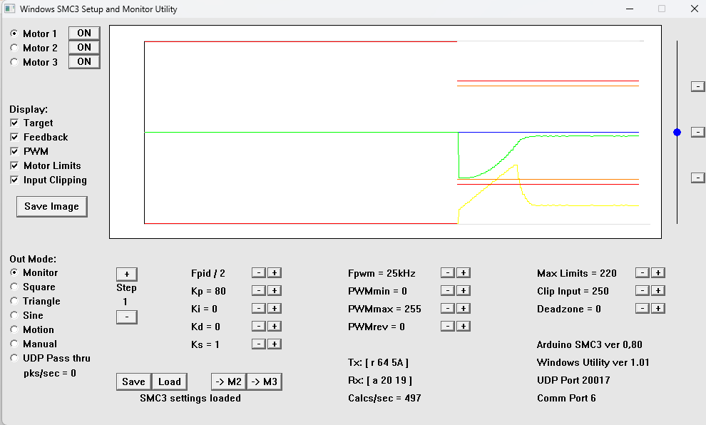

    Hello again! here is some news after 1500 hours on the simulator, the 2000lbs winch motors are dead, the planetary gear (aluminum) is completely worn out, it caused me jams and the 50amp fuses were blowing upload_2024-8-30_16-3-8.png
    I had to replace the electric motors with 3000lbs 1.3HP motors with a slower gear ratio 171:1. the movement is smoother and more precise upload_2024-8-30_16-3-40.png upload_2024-8-30_16-4-5.png

    I suggest you use an electric motor similar to the photo and on the contrary the electric motor is probably what costs the least, I paid $180 CND. each .
