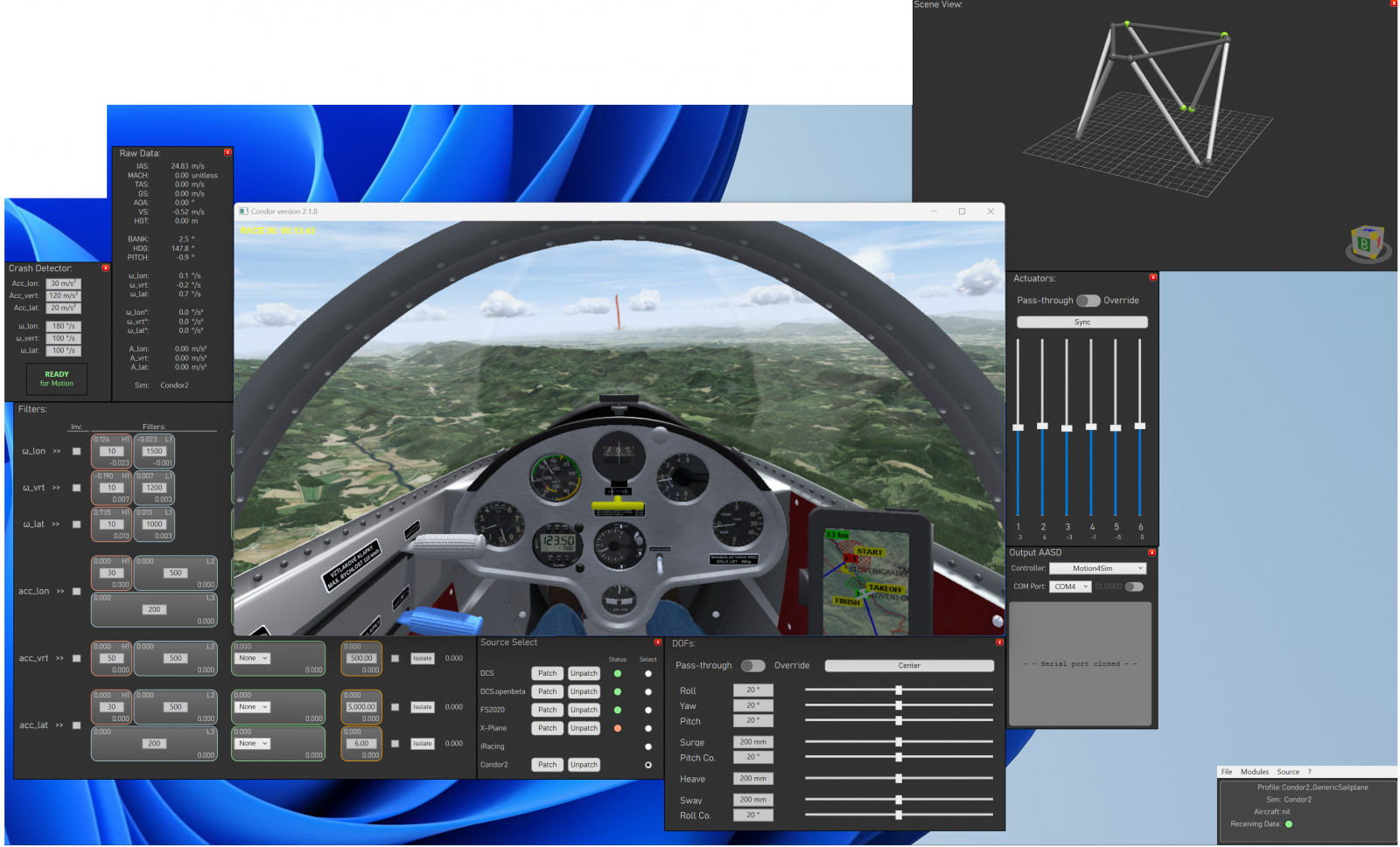

    I have added (very basic!) support for Condor2 :)
    Angular rates are available natively in Condor2. That's a good thing, for sure. :thumbs Accelerations are afaict world referenced, but I am hopeful that the proper accelerations (vehicle referenced with gravity) can be calculated from them.
    There's still one thing that puzzles me though: Sometimes the export interface gives me "pitch=NAN" at very high pitch values (+/-85°). NAN stands for "Not A Number" and is often used to indicate/prevent a division by zero. However, the quaternions in the export interface appear to be unaffected, so there might be a workaround there...

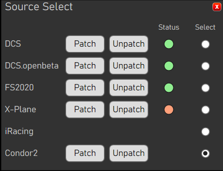

    All this took surprisingly long, because with 6 different sims supported now, I had to check every change I made against all the other sims and I had to add a "Source Select" window that lets users choose their source so that YAME knows what data to expect. Unfortunately YAME does not remember (yet) which setting the user last used or which would be most suitable for the vehicle profile, so the user will have to actively select it everytime for now. Hope to change that soon... [Edit: Done!]
    It also conveniently patches and unpatches Condor2 as well as all the other sims. Patching iRacing is not fully supported yet. Still some troubleshooting to do there.
    The software should self-upgrade on next start :)
