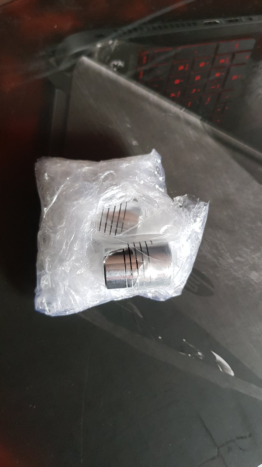

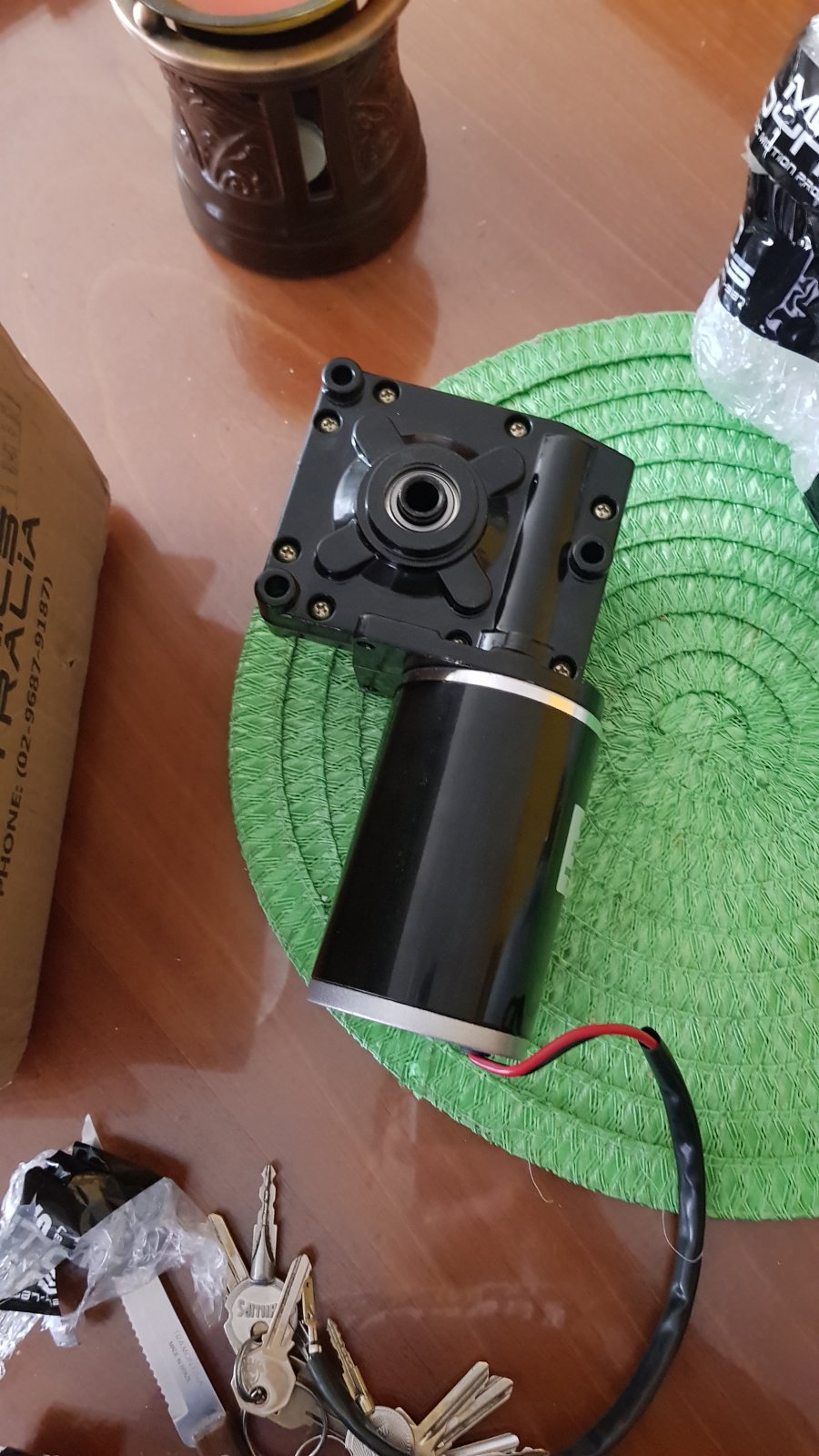

    Hello again everyone. today I received my engines after a long wait. I had the doubt to mount the arms of movement. some idea?

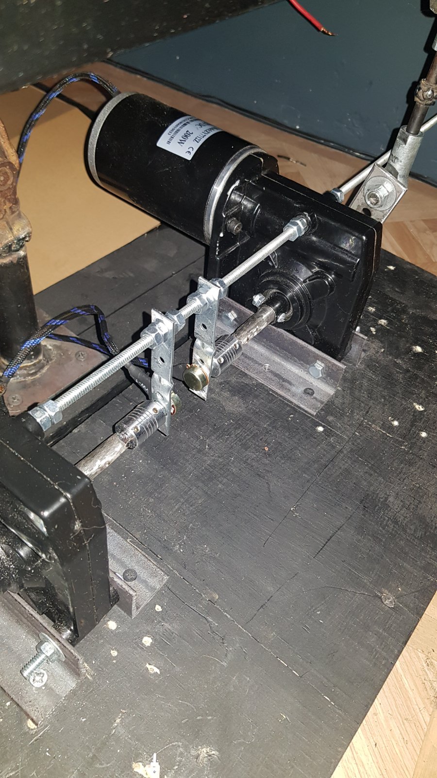

    This is my breakthrough with the arrival of the engines. I hope this weekend to adjust and test.

    Hello .what potentiometer, or what features do you recommend, I live in Mexico and not many send here thanks
  7. miguel
    miguel Member
    Dec 10, 2018
    52
    Student
    Mexico
    343Coins
    I have a doubt, because potentiometer of 10 k, and not more or less.

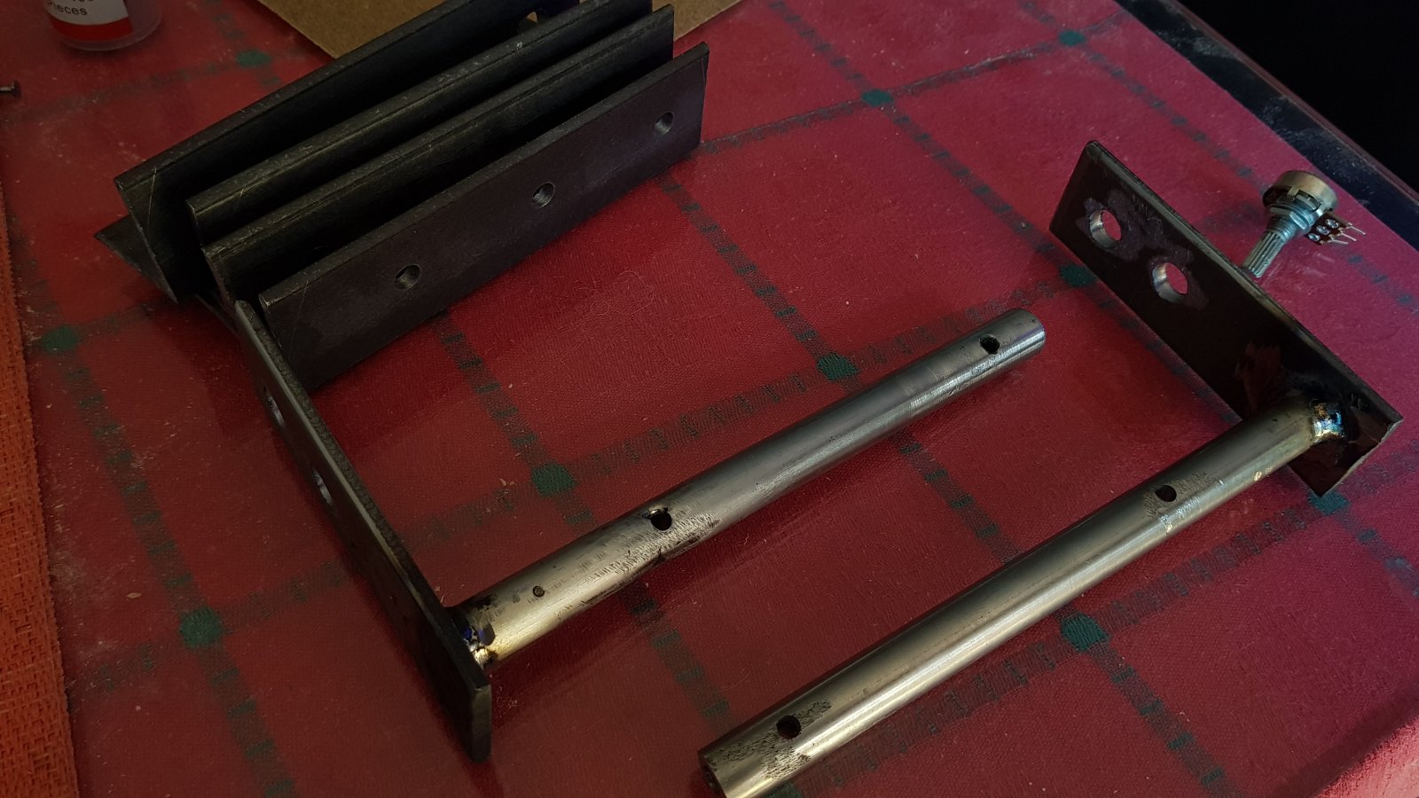

    Hello everyone, the project is going well already all the unions are, but I was wondering what code some of you use for 2 DOF, I already have one but I wanted to know you.

    Another doubt is that it has vibrations or noise when standing. I'll try a 100 nf capacitor, do you think it's a good idea?

    could you help me? I do not know why this happens I can not get them to stay still once they start. and it gets worse when I add the weight of the seat.

    What could be the problem . potentiometers, code, assembly. I thank you very much for the help.
  20. noorbeast
    21,721
    151,961Coins
    +11,061 / 56 / -2
    Can you please post pictures of all of your SMC3 and SimTools settings.
