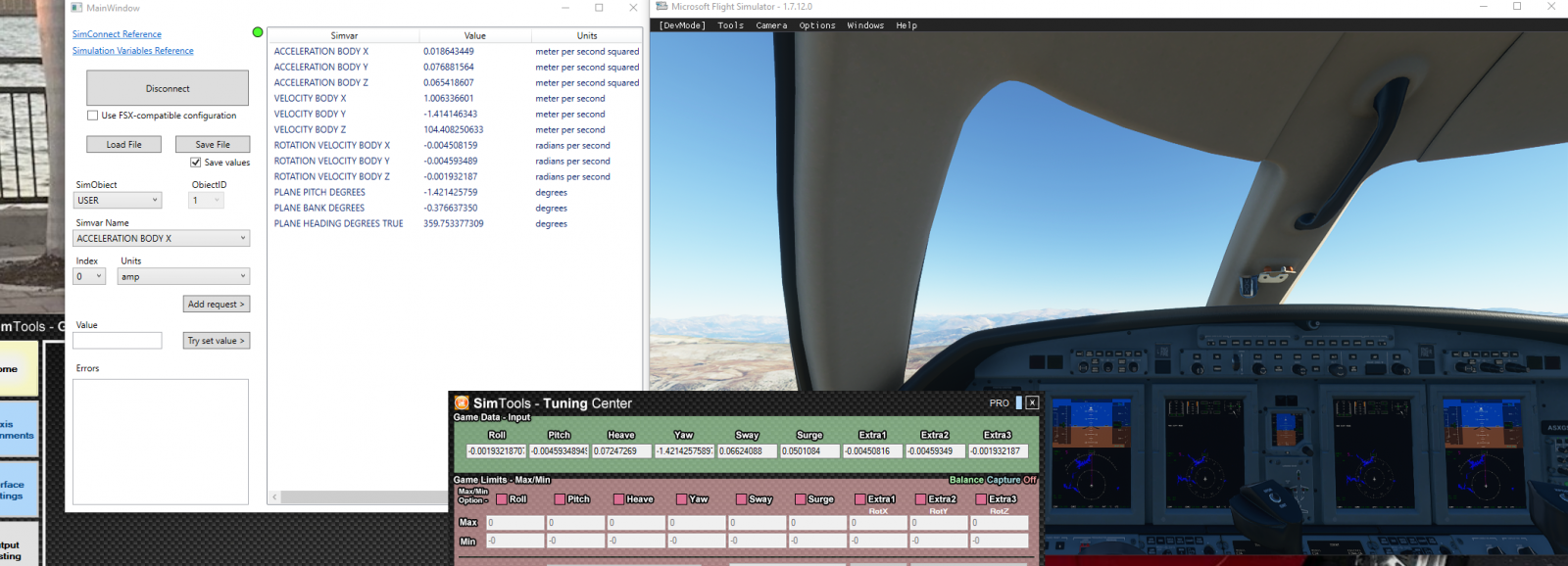

  17. knaufinator
    knaufinator Active Member
    Nov 16, 2017
    224
    Simulation Engineer
    akron,ohio
    1,955Coins
    +259 / 1 / -0
    AC motor, 6DOF
    I can see how to make a proof of concept using the SDK/Simconnect, I can see the values needed to derive all forces.... I may give it a try if no one else decides to dedicate some time.

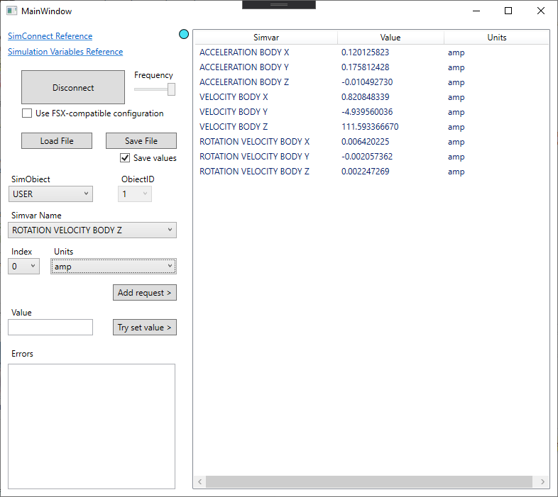

  19. knaufinator
    Nov 16, 2017
    224
    Simulation Engineer
    akron,ohio
    1,955Coins
    +259 / 1 / -0
    AC motor, 6DOF
    Proof of concept is done, I have not flow it, but am getting data to Simtools...
    Still need to figure out what they call pitch/roll/yaw but I have so far, heave,surge,sway, rot accel x,rot accel y,rot accel z.
    • Winner Winner x 4

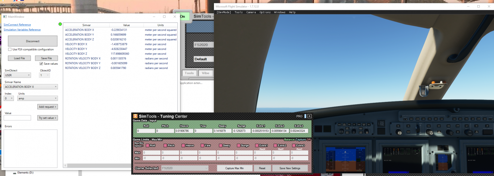

  20. knaufinator
    Nov 16, 2017
    224
    Simulation Engineer
    akron,ohio
    1,955Coins
    +259 / 1 / -0
    AC motor, 6DOF
    Ok, I was able to find pitch roll and yaw,... I can pick this back up after work tomorrow,... I'll do some testing
