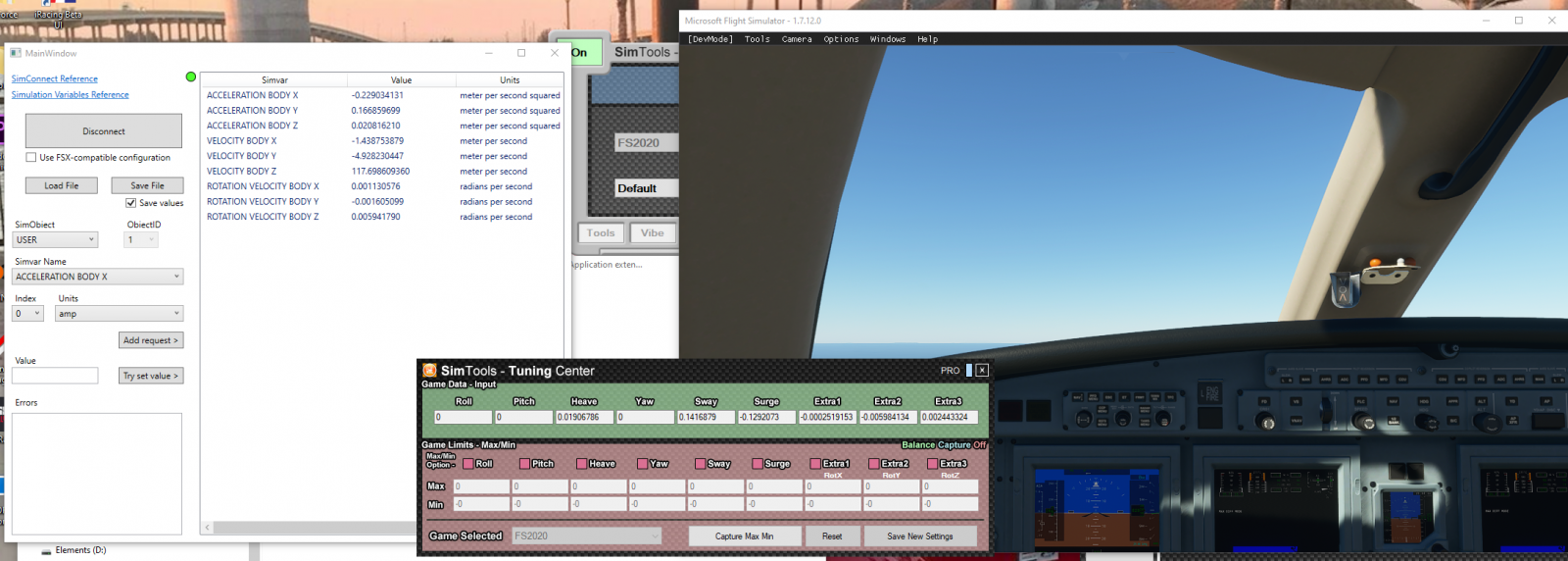

    Update: Ive been tuning it for a few hours and got it working good enough for a video. I will record one over the next few, and post it.
    I will also release the source code on GitHub to the project, along with a user guide,.. this is no where near DONE... as I am using a separate app to act as a telemetry server,... The server could be integrated right in the plugin... I may still do.... if no one does before me,

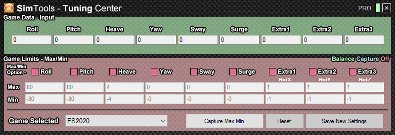

    I have released the source code to this so other developers can improve on it, I have spent 1.5 hours to get it working this far. Several more hours just making a video and posting it to GitHub. I may not invest more time in it, but by all means,... take it and ....Dare I say..... FLY...
    https://github.com/knaufinator/MS-Flight-Simulator---Simtools-interface-
    This is a VERY early release as QUICKLY as I could get it out so people can start flying around in a motion sim for Microsoft Flight Sim 2020
    This project includes 2 parts
    1. FS2020_GamePlugin = The Simtools plugin, compile this and drop the file FS2020_GamePlugin.dll into the SimTools plugin updater app to install it, patch it as normal.
    2. Simvars = This is a Server application, this connects to MS Flight Simulator when you hit Connect, it Queries the correct data from the game only at 10Hz, anything faster and it was slowing my PC down, so change that at your discretion.... this needs to be improved. take a stab...this is a modified app from the SDK, so it has a bunch more functionality in it than what we are using. dont hit anything else other than Connect.... after it opens up, and it should consume the data automagically..the simtools plugin should see the data as soon as you do.
    Limits I used, i did not touch sway or surge yet...

    @knaufinator I got it working somewhat lol. I have no idea what I am doing however. I took FS2020_GamePlugin.dll / FS2020_GamePlugin.pdb / and Game_PluginAPI.dll and zipped them and loaded them in simtools plug-in updater. Patched the game. Then executed simvars.exe and loaded all.simvars-- It actually sort of worked. Frame rate was like 2 frames per second lol....

    There's a bug in simconnect that causes the slowdowns in fs2020
    They are looking at it, might be solved next week.
    I have a solution working in unmanaged code, similar to what is posted here, it works but if you use other apps for joysticks or other programs that use simconnect, you are going to get the slowdowns.
    We have to wait some days...

    Nice, I will hold off then. It was killing my frame rate to. Thanks for letting us know

    I've been experimenting with converting @value1's FSX plugin into a MFS2020 plugin. In the FSX plugin, there is direct communication with SimConnect.dll using DllImport. The problem is that the MFS2020 version of SimConnect.dll is 64-bit. Since SimTools plugins have to be 32-bit, I can't get DllImport to work from a 64-bit DLL.
    Am I missing something straightforward, or will the plugin just have to communicate with a separate application like in @knaufinator's solution? Thinking @value1 might be able to provide some insight.

    From what I know so far, accessing a 64bit dll from a 32bit exe is not straightforward. It needs some additional intermediary (COM server) and tweaking of the registry.
    However I think the SimConnect dll that is provided with the SDK is a 32 bit library.
