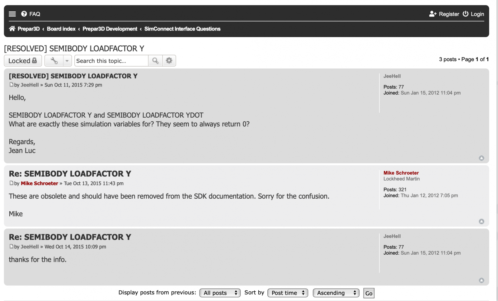

    The documentation you are referring to is from P3D :). But that makes almost no difference, given that FS2020 and P3D still share a large part of their code.
    I have done some searching: It looks like back in the days before FSX they had "SEMIBODY LOADFACTOR X/Y/Z" as a variable but when the code went to Lockheed Martin they eventually removed it from P3D. Here's a statement from a Lockheed Martin employee saying that it is obsolete and should be removed from the P3D SDK.

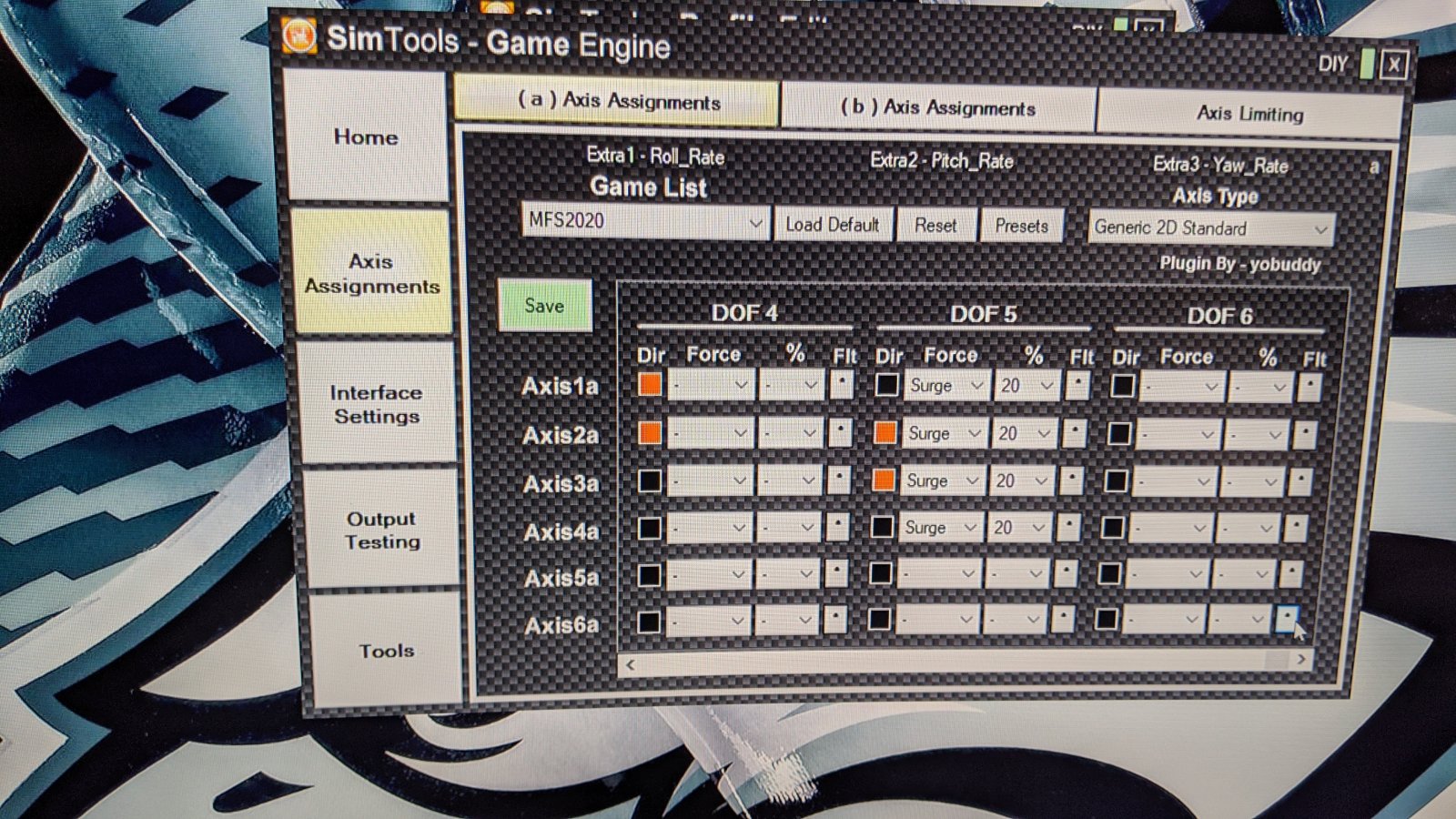

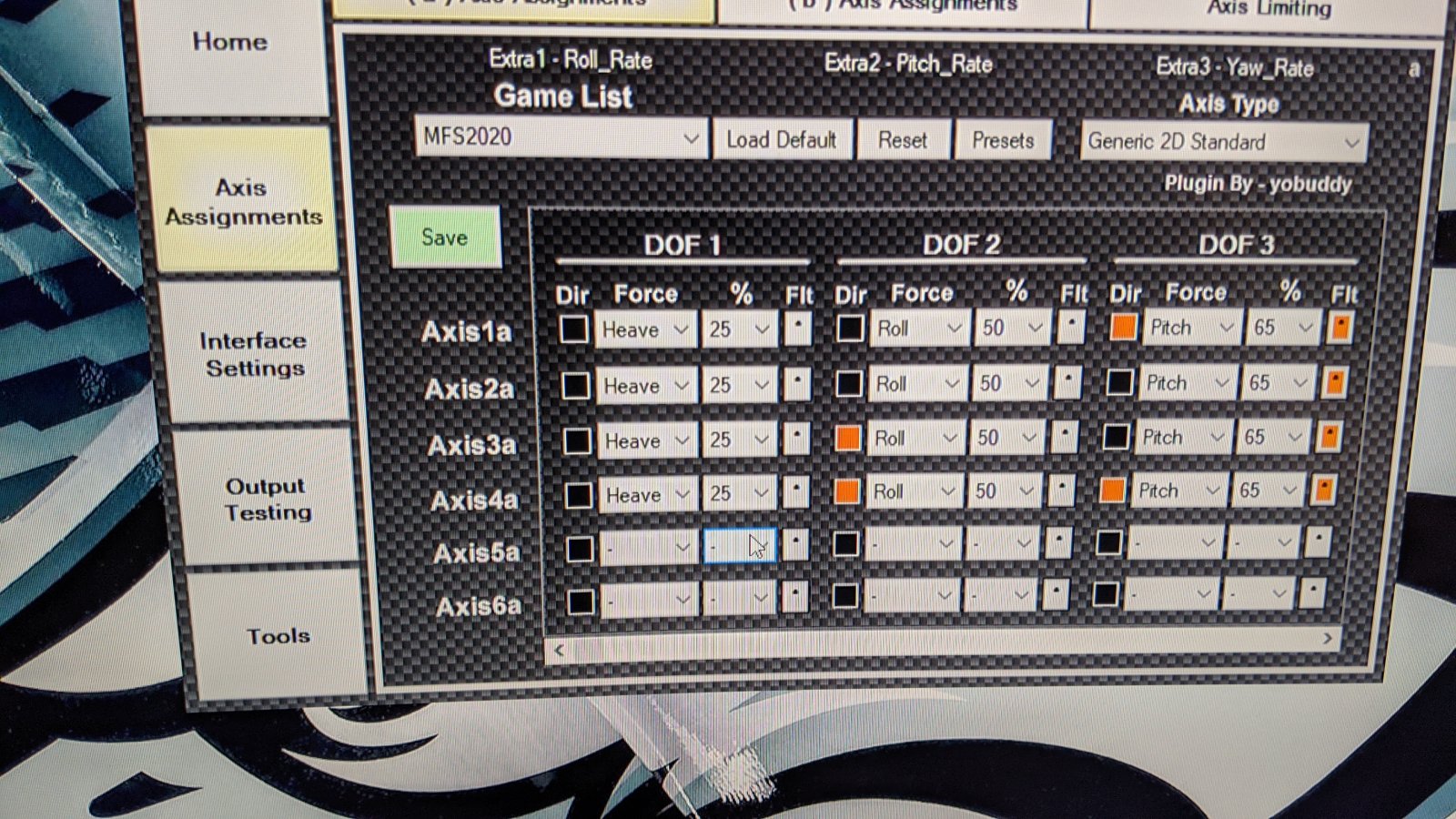

    @jaynnc
    I have a 3-dof motion-integrated g-seat, of Bergison's design.
    For the roll axis I mostly use "Extra 1" (roll rate) at with some Sway mixed in
    Pitch axis is just Surge
    Heave axis is just Heave
    For max/min roll rate I use +/-80 degrees/s
    Heave +0.3/-0.2
    Sway +2/-2
    Surge +0.5/-0.4
    Still refining these and as better outputs come along with hopefully refine further.
