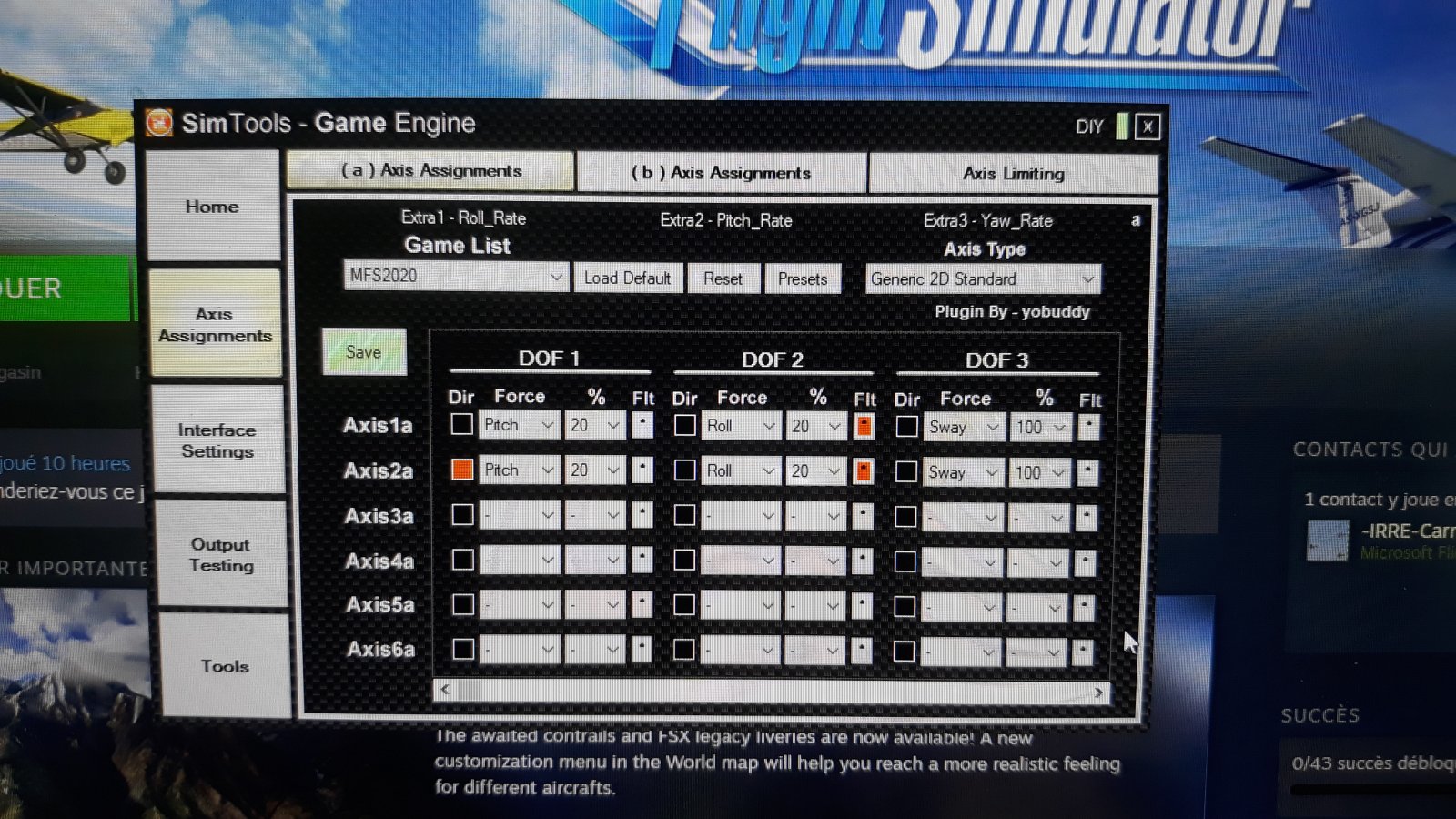

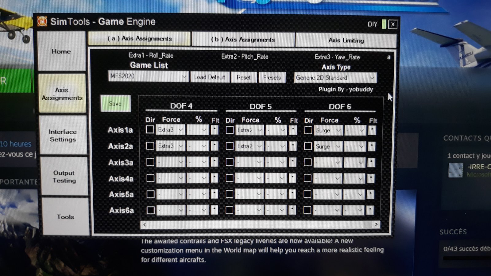

    Hi.
    I am French and I speak English very poorly.
    on MSFS2020 I downloaded the plug-in, the seat moves, it's ok.
    I would like to know what the axes correspond to for adjustment,
    I found two:
    -pitch = up / down gravity.
    -roll = right / left gravity.
    what the others correspond to (extra 1,2,3 etc.)
    can you send me a picture of your settings please.
  15. margolle
    margolle Member
    Jun 27, 2019
    34
    104Coins
    +8 / 0 / -0
    when I fly, head down, my seat completely to the right and then to the left.
    on another game when I am flying upside down, sitting and centered. is there a solution?

    If I understand your problem correctly, there are two solutions:
    1. Use the roll and pitch rates instead of the roll and pitch angles. The rates are provided with the Extra1,2,3 values. (I don‘t have in mind which is which, but I know it is written somewhere.)
    2. Configure „Anti roll-over“ in the Game Engine‘s Axis Assignment.

    hello
    my youtube video :https://youtu.be/9nw6QEL6_G8
    roll =brutal shake
    pitch no brutal shake
    I have the same problem with DCS.
    no problem with IL2 BOS
    thank you for your help, (make sentences easy to translate please)
    thank you.

    I deactivate all, I will test 100% extra 1
    then extra 2 one after the other
  20. margolle
    margolle Member
    Jun 27, 2019
    34
    104Coins
    +8 / 0 / -0
    after many test (2DOF)
    Simtools name = effect
    Pitch = earthly gravity movement (front/rear)
    Surge =earthly gravity movement (front/rear)
    Roll = earthly gravity movement (D/G) "brutal shake"
    Sway = earthly gravity movement (D/G) "NO brutal shake":thumbs
    Extra1 =centrifugal effect(D/G)
    Extra2 =centrifugal effect (front/rear)
    Extra3 =centrifugal effect (yaw D/G)
    Yaw = ????? the seat move extrem right or extrem left , i'm not understande ?????
    Heave = no effect
    how well configurat all ? how many % axis by axis ?
