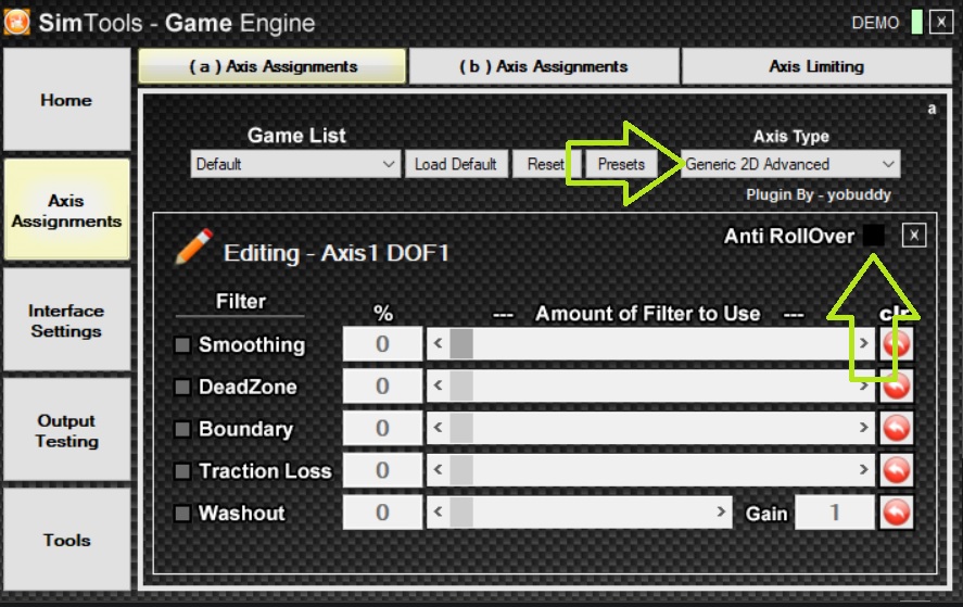

    You can use Extra1 and Extra 2, or Roll and Pitch, but not both. My personal preference is using Extra1 and Extra 2.
    If you do use Pitch and Roll in Axis Assignments make sure Axis Type is Advanced and in the FLT box of Roll and Pitch use the Anti-Rollover checkbox: https://www.xsimulator.net/community/faq/anti-rollover.327/
    As an aside, in a Flight sim motion profile you can use much larger Axis assignments for either pitch/roll or Extra1/Extra2, see the tips here: https://www.xsimulator.net/community/faq/steps-to-create-a-motion-profile.228/

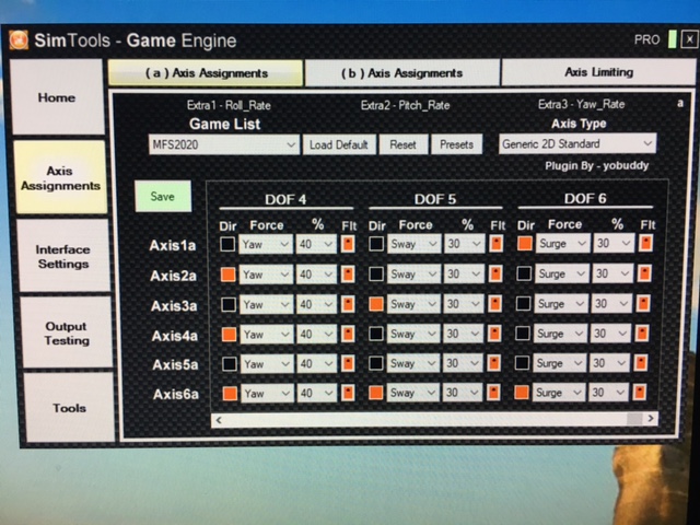

    Dear all, last week I received my seat mover (NJ Motion) and so far I'm pretty happy. My only issue with MSFS is that for short movements (both on the ground and in the air) the platform isn't moving smoothly but in steps. When I turn my joystick for a big turn or modify suddenly the altitude, then it works smooth.
    I'm using pitch and roll and have tried to play with the filters, but no improvement so far.
    Any idea how to remove or reduce this stepped movement?. Thanks very much in advance.

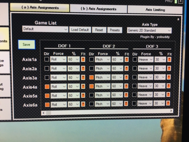

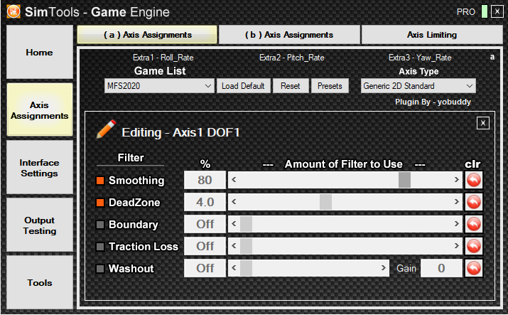

    It would help if you post pictures of all of your settings.
    If you can a video that shows the seat movement and game screen at the same time will give some context for members offering advice.

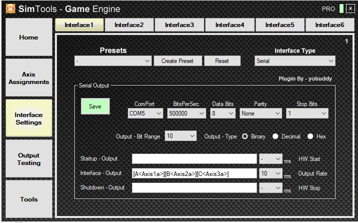

    Thanks for your reply. Attached you can find the pics of my settings. Let me know if you're missing something.
    Posting a video won't help a lot since the stepped movement more than seeing it, I can feel it in the seat.
    A good example of slow movements is auto pilot, by following a course, you can feel the stepped corrections in both roll and pitch.
    Thanks again for your support.

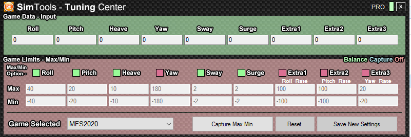

    What are your Tuning Center settings?

    Hi, attached the screenshot. Kind regards.
    22,230
    154,849Coins
    +11,228 / 57 / -2
    First up check the hardware, does the rig move smoothly in output testing, if not then it may need balancing or other hardware, which you should take up with NJ Motion.
    Assuming the rig moves smoothly the check each of the axis individually, do not initially enable smoothing or any other filters, those refinements should came last, do each axis one at a time and adjust as necessary, see the tuning tips here: https://www.xsimulator.net/community/faq/steps-to-create-a-motion-profile.228/
    When it comes to the Tuning Center first capture the Max/Mins then refine from there. The larger the value the smoother the response, over a greater axis range. If your rig is smooth in Output Testing my guess would be that your existing Tuning Center values are too low.

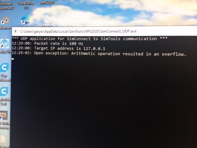

    i installed the SDK SimConnect.dll file but to progress but what I am getting is the message below. Any help?
  13. Wagnard
    Jan 30, 2017
    567
    Wagnardsoft
    Canada, Quebec, Mirabel
    5,385Coins
    +789 / 2 / -0
    Its normal to see this if the game is not running. Let it go through the main menu and it should connect

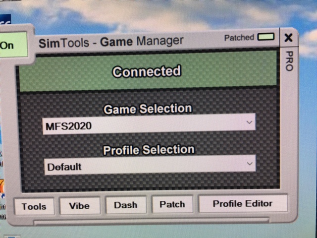

  14. Garyrv7
    Garyrv7 New Member
    Feb 24, 2021
    54Coins
    its working, thank you. i didn't realise you had to leave it in developer mode.
