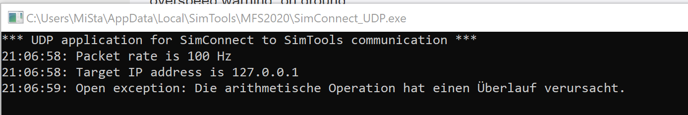

    why no motion? game patched, when i start the game the rig switch to neutral position, but no motion. tuning center capturing all zero values in green fields.
    when started fowing ecpotion will occur:
