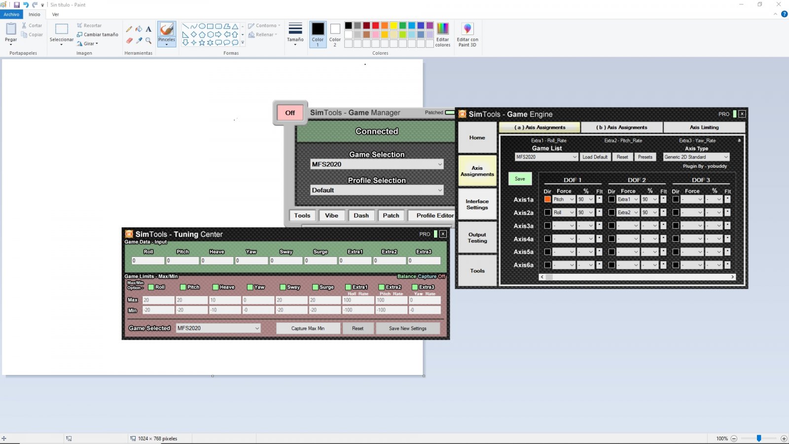

    Well, I can get it to roll correctly or with the same i`te`sity to the left as to the right, right rolls well but left very little, I have touched everything
    22,230
    154,849Coins
    +11,228 / 57 / -2
    This showing settings for Assetto Corsa, even so your settings seem odd.
    What physical design is your rig?

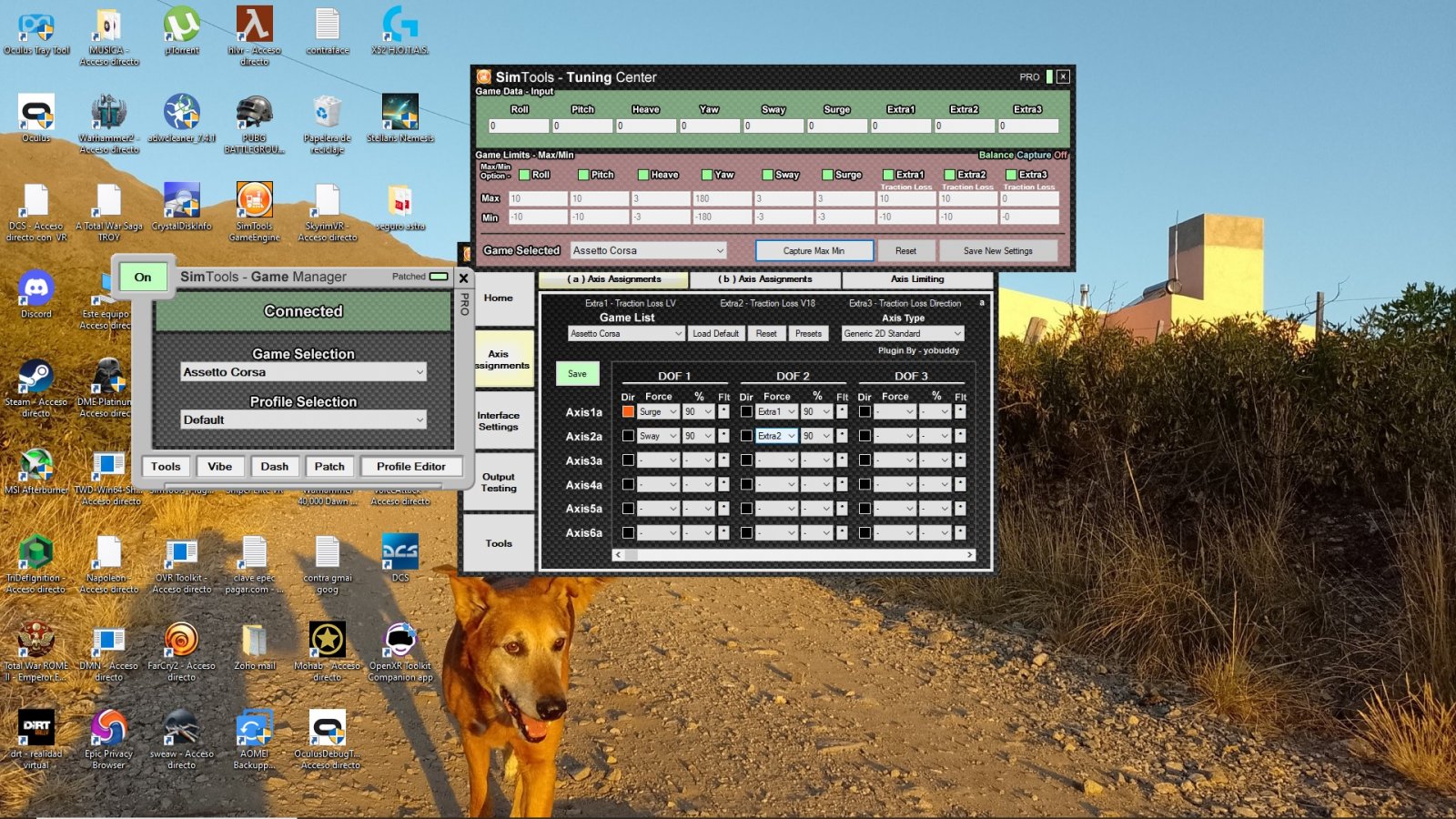

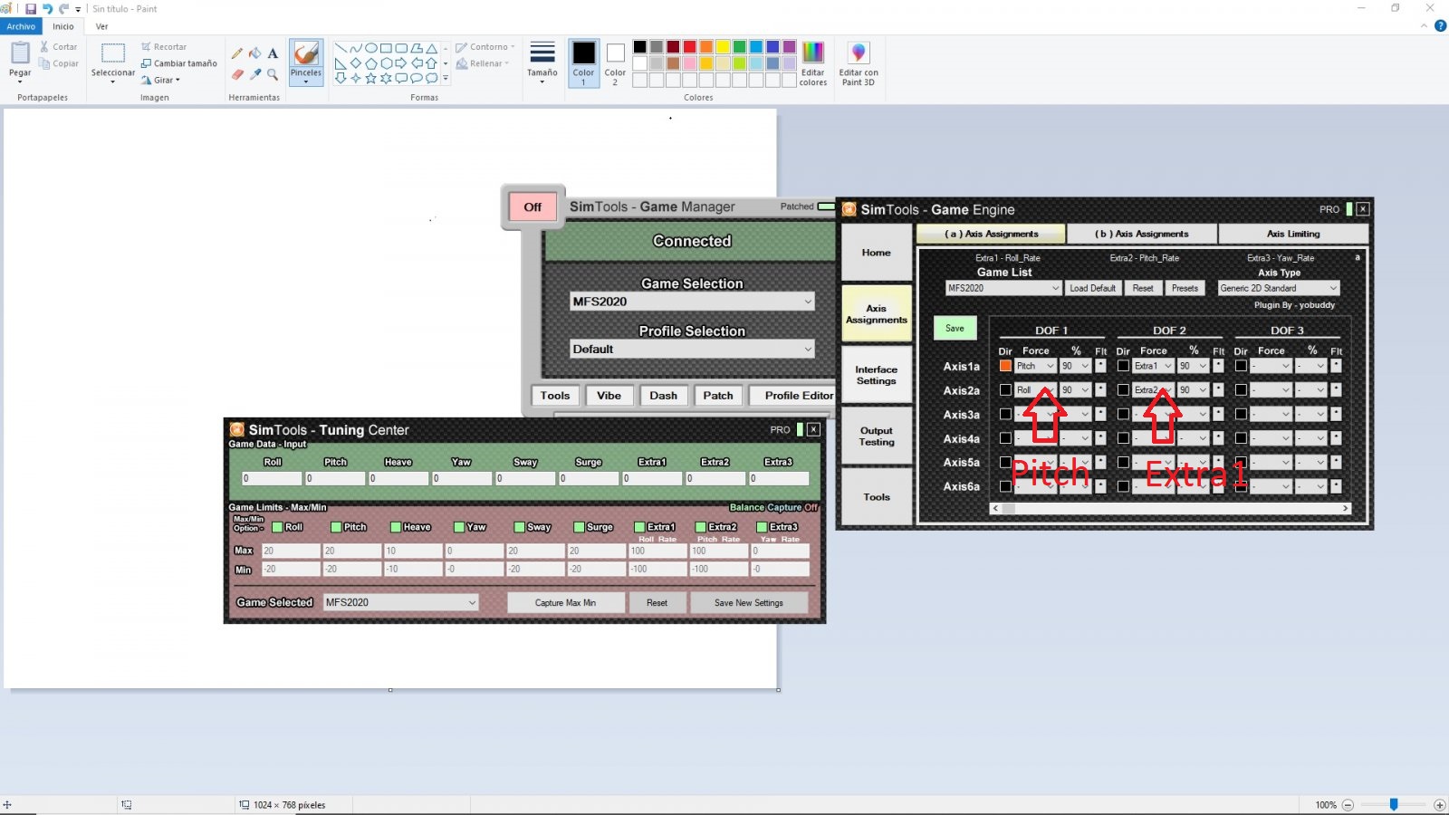

    I made the wrong photo, my rig is 2dof, I show the photo with the best cofiguration achieved, but the warping to the right is still weak
    22,230
    154,849Coins
    +11,228 / 57 / -2
    For a traditional 2DOF I would expect Axis2a to have the same axis configuration designation as Axis1a, with the DIR being checked orange or not determining which way each of the two axis moved.

    ok Noorbeast thanks you very much, i will modify configuration
    Greetings

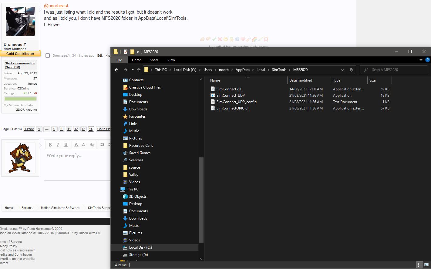

    The game does not connect, nothing happens. I have MFS2020_GamePlugin.dll in the Gameplugins directory as well as SimConnect.dll, but what should I do with SimConnect_UDP.exe and SimConnect_UDP_config.txt that I can't find anywhere? I specify that it is about the Steam version.

    There are specific instructions for MSFS2020, can you please verify you have followed each step:
    • This plugin installs and runs a separate application that it uses to get motion data from the game. This may require GameManager to be run as administrator when patching.
    • A config file is included with this application and is located in AppData\Local\SimTools\MFS2020. This file can be used to set the rate of data transmission, which by default is 100 Hz. It can also be used to change the IP address that the application sends data to, which is necessary when the game and GameEngine are running on different PCs. In this case, change TargetIP to the internal IP address (e.g. 192.168...) of the PC running GameEngine.
    • If you are having problems with motion data, try replacing the file SimConnect.dll in AppData\Local\SimTools\MFS2020. A different version of this file may work better on your system. Look for one in the game installation directory, or install the SDK and look in MSFS SDK\SimConnect SDK\lib.

    Thank you Noorbeast for your answer.
    After patching the game with SimTools_pluginUdater:
    1) Game menager is well executed in administrator mode.
    2) I don't have MFS2020 folder in AppData\Local\SimTools\
    3) I replaced the SimConnect.dll from the AppData\Local\SimTools\GamePlugins folder with that of the MFS2020 SDK.
    Thanks.

    @noorbeast,
    I was just listing what I did and the results I got, but it doesn't work.
    and as I told you, I don't have MFS2020 folder in AppData\Local\SimTools.

    Try creating the folder and locate files like this:

    Ok, thanks This works after manually creating the MFS2020 folder as instructed and unpatching and repatching the game.
