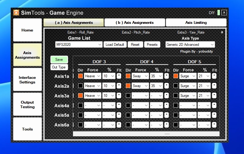

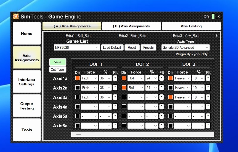

    Good afternoon! Here is a screenshot of my settings

    What are your Tuning Center settings, can you please post a picture while the game is running?
