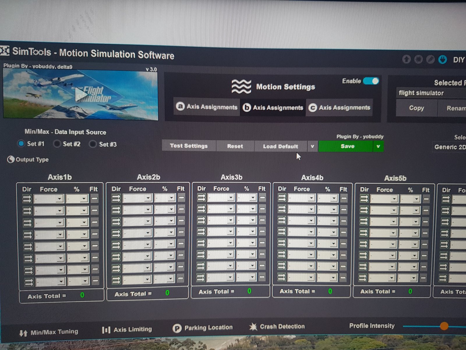

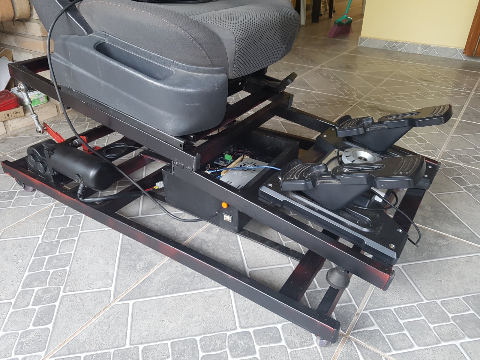

    I'm using flight simulator in dof2, I can only move pitch and roll, on the runway the aircraft doesn't make any movement, if there's anyone in the group who can help me, I'd be grateful.

    I have simtools v3

    You have no Axis Assignment values configured.

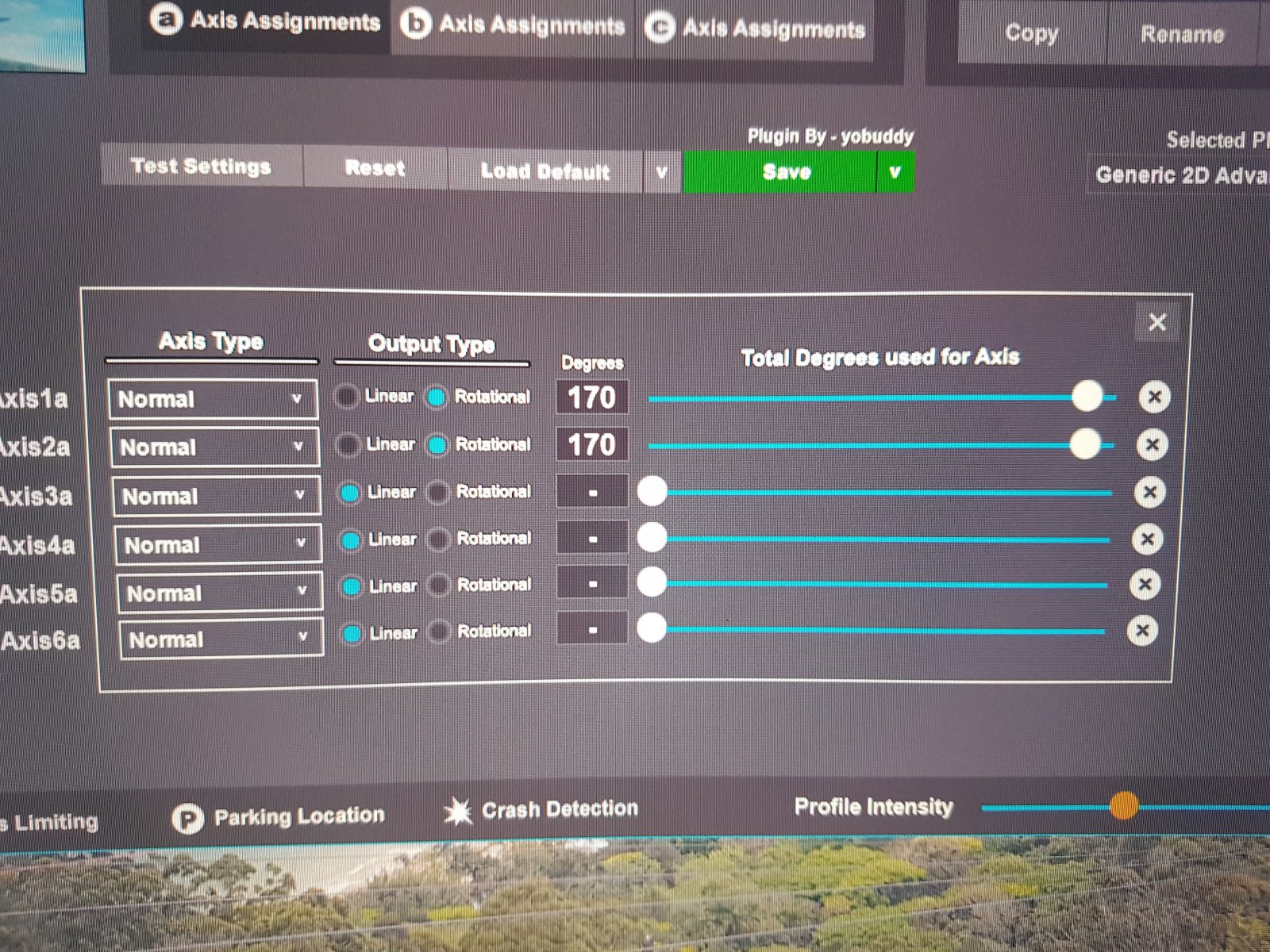

    only assigns to axis (a)

    Actually I don't know how to configure it in a and b

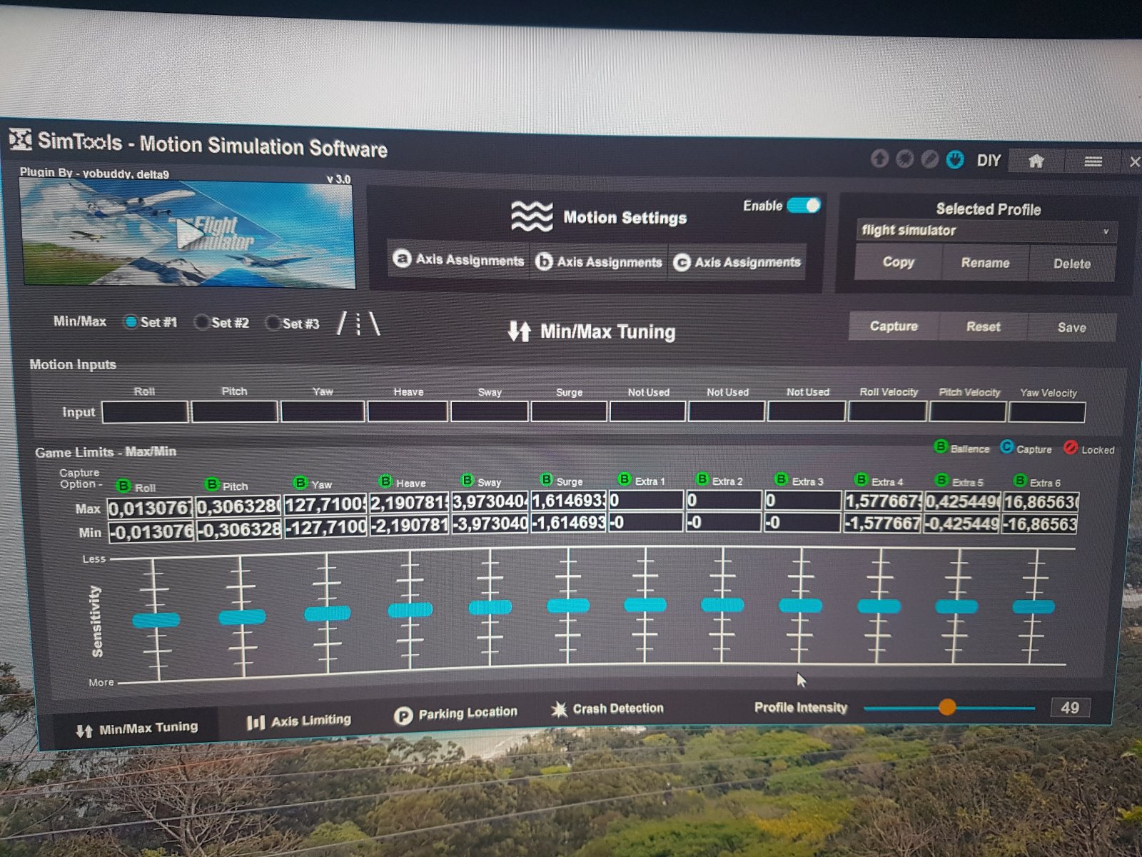

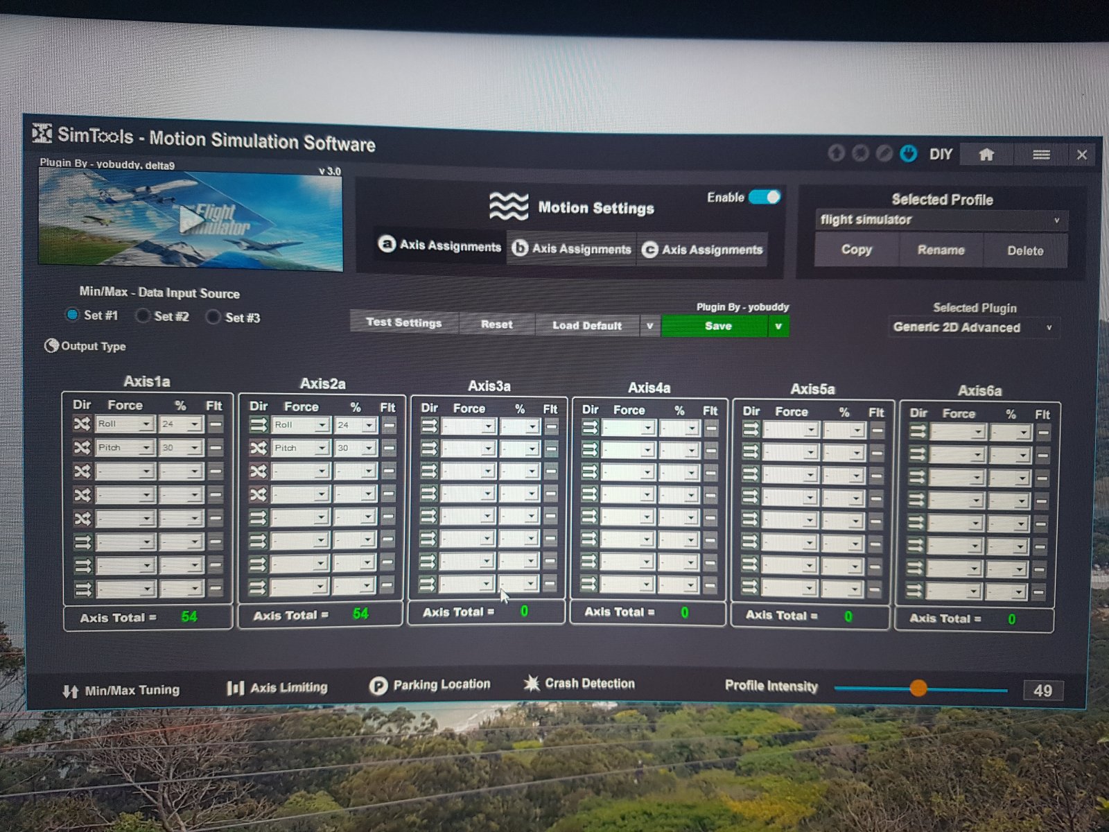

    In flight it works well, but on the runway it doesn't make any movement.

    B should not be necessary if you are using 6 or less axis, bit please post your configuration for A.

    Try adding a little heave for runway effects.
