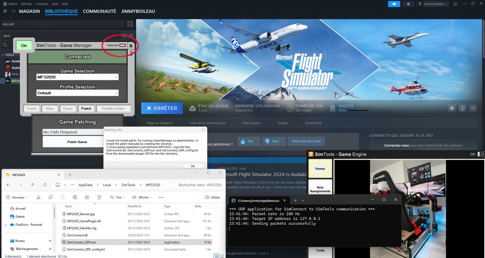

    Hello.
    I need help. My simu works fine in simracing but I can't get it to work for MFS2020. I launch it via Steam and the status remains "No Patched". I launch Simtools Game Manager in administrator mode.
    If anyone can help me. Thank you.
    See my screenshot.
  6. Jimousse
    Jimousse New Member
    Nov 1, 2022
    - 10Coins
    I don't know why, but after 3 hours of trying, it started working properly. Maybe SimConnect_UDP.exe had to be closed to start the patch installation.

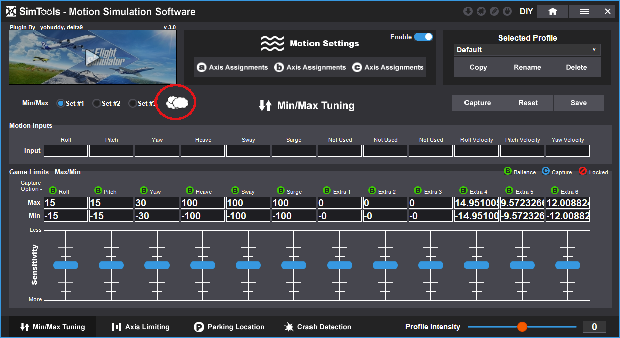

    Hiya
    Appolgies for sounding a bit dense
    Cannot get this to work
    Simtools v3. New install new PC etc
    All ok at Simtools v3 startup scn6 actuators move etc & now fine under testing
    The mafs2029 plug in clicked twice does start mafs2020 but zero motion
    I’ve assigned basic axis pitch roll now turned up but zero movement
    msfs2020 does run motion when I try using sim commander software so it does output but sim commander not great for flight sims
    any ideas of how to get it to work using Simtools v3 ?
    22,230
    154,849Coins
    +11,228 / 57 / -2
    Simtools v3 does not support this old v2 plugin, but does support MSFS2020 via the dedicated v3 plugin: https://simtools.us/plugin/?varname=358&color=0e97dd
    Best to post Simtools v3 issues to the dedicated v3 Beta thread, along with all relevant information and pictures of all settings: https://www.xsimulator.net/community/threads/simtools-v3-public-beta.17329/

    Also try to find cloud icon and car icon when u assign max min:)

    Simtools 3 downloaded the plug in from its plug in page in the the Simtools 3 interface
    ok thanks I’ll post problem there
