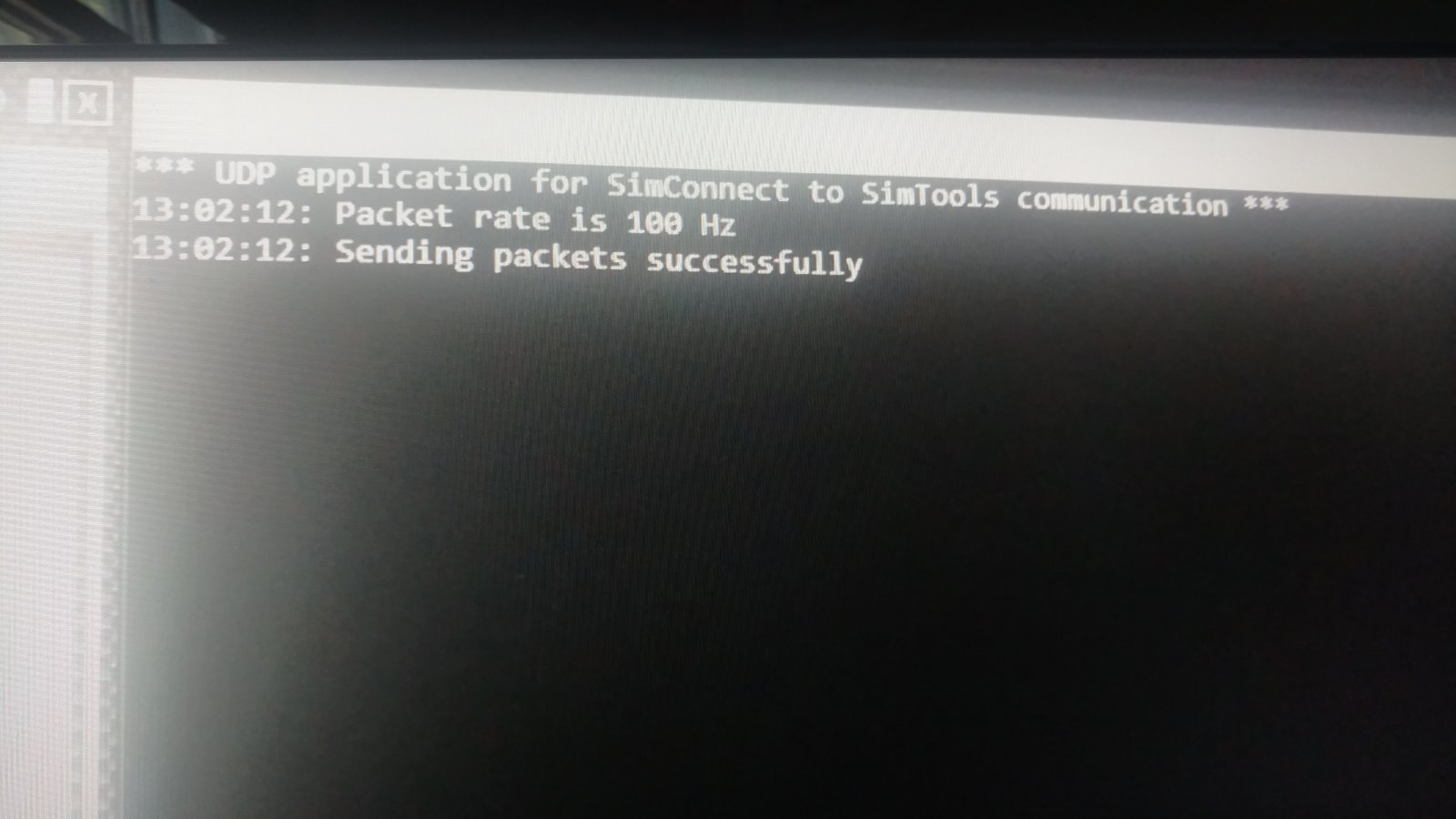

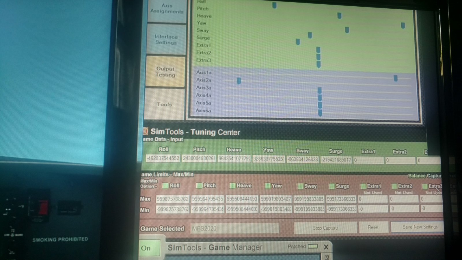

  12. Leandro Kemp
    Leandro Kemp Active Member Gold Contributor
    Oct 14, 2015
    161
    Brasil
    - 10Coins
    +34 / 0 / -0
  13. Icy7CE
    Icy7CE Active Member
    Feb 10, 2018
    119
    USA
    2,907Coins
    +231 / 3 / -0
    That's very strange. Those numbers are way bigger than anything I was getting. Maybe this is another problem related to SimConnect differences - which version of the plugin are you using?
  14. Leandro Kemp
    Oct 14, 2015
    161
    Brasil
    - 10Coins
    +34 / 0 / -0
    Can be it.
    I didn't check the version.
    I saw that you already have a new one.
    I just downloaded it to test.
  15. Leandro Kemp
    Oct 14, 2015
    161
    Brasil
    - 10Coins
    +34 / 0 / -0
    I downloaded the last plugin, installed it, redid the Patch and continued the same thing.
    Am I skipping a step?
  16. Icy7CE
    Feb 10, 2018
    119
    USA
    2,907Coins
    +231 / 3 / -0
    You installed it correctly. I'm not really sure what the issue is. Out of curiosity, how many digits are those numbers you're getting, and are there any decimal places on the end? The only thing I can think of is that it looks kind of like a data type error.
  17. Leandro Kemp
    Oct 14, 2015
    161
    Brasil
    - 10Coins
    +34 / 0 / -0
    15 digits without decimal place.
  18. noorbeast
    22,230
    154,849Coins
    +11,229 / 57 / -2
    Could this possibly be related to the language settings bug, which manifests for a small number of SimTools users for no known reason, what language is your computer set to @Leandro Kemp: https://www.xsimulator.net/community/faq/simtools-language-setting-bug-change-to-english-local.233/
  19. Leandro Kemp
    Oct 14, 2015
    161
    Brasil
    - 10Coins
    +34 / 0 / -0
