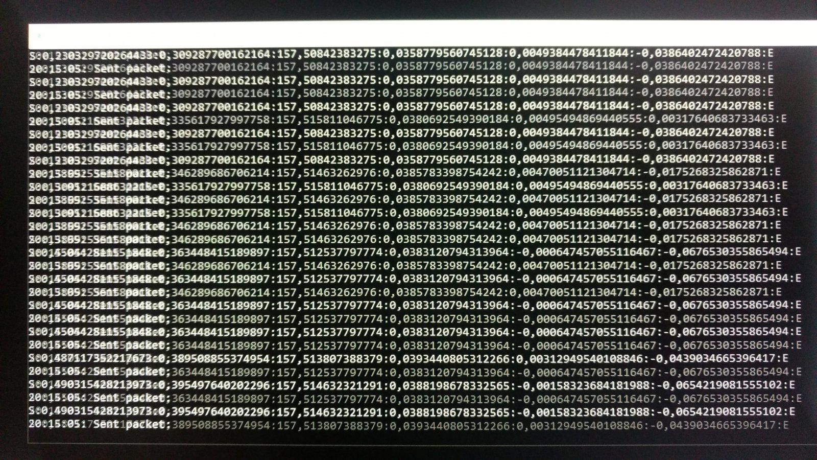

    I've attached the debug version of SimConnect_UDP.exe, which prints to the console the data sent in every UDP packet. You can replace the file in AppData\Local\SimTools\MFS2020. Let me know what it prints out - this will tell me whether the problem is in the sending of data from the game to SimConnect_UDP, or from SimConnect_UDP to the SimTools plugin. If the print statements are too fast to see, you can lower the packet rate in SimConnect_UDP_config.txt.

    Can you send a picture of the console window for SimConnect_UDP.exe, using this debug version? It will be helpful for me to see what data is being sent.

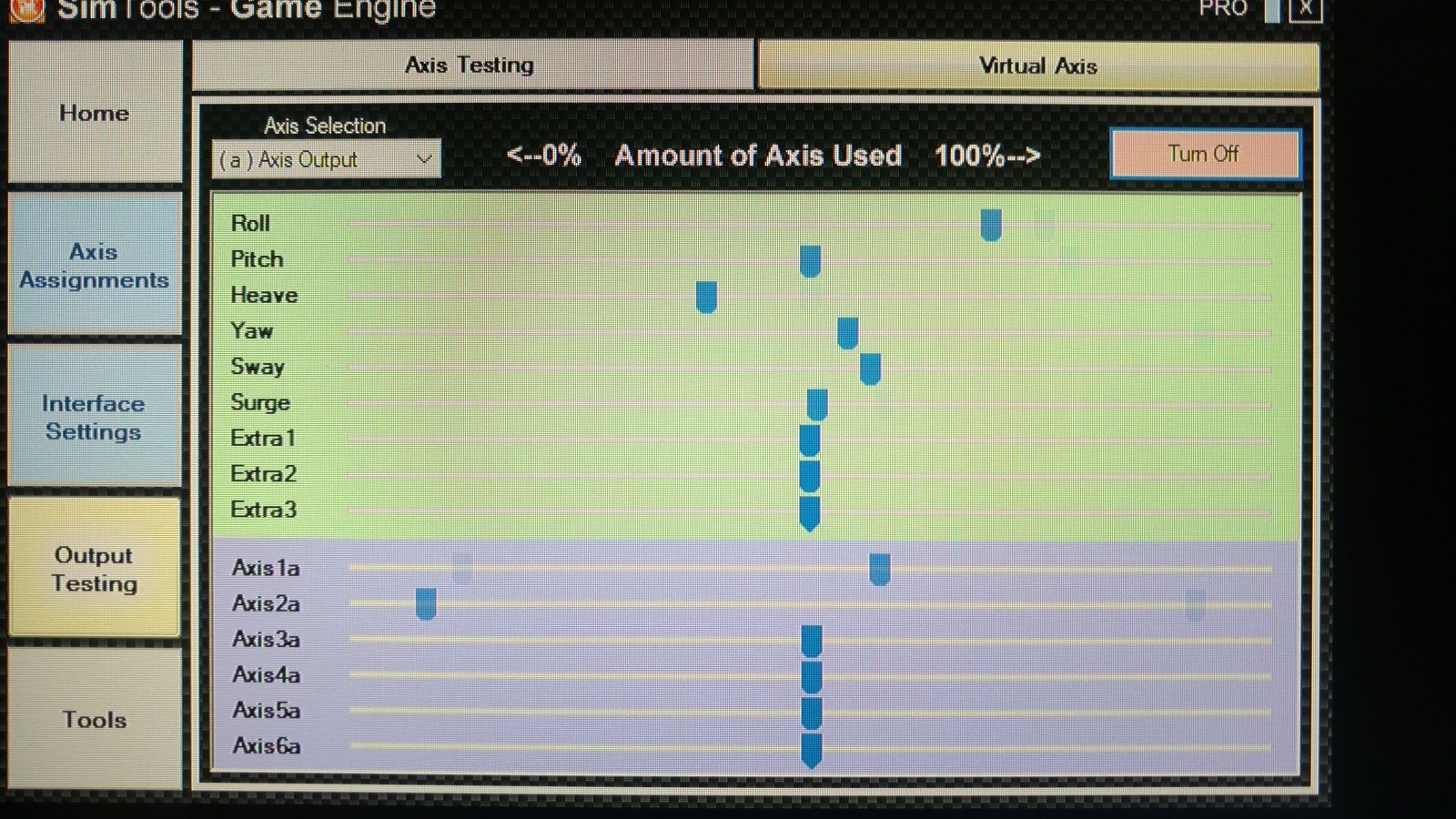

    Ok.
    Unusual movements.

    Ah, I think that solves it! Your locale (Brazilian Portuguese?) is using a comma, rather than a period, to separate the integer part of the number from the decimal places. The UDP application sends numbers in this form. The SimTools plugin then interprets them in the English standard, where a comma is used to group digits, so is just ignored when determining the value of the number.
    Is there a mismatch between the locale that the game is set to and the system locale? It might fix the problem if they were the same, or maybe they both have to be English. I could also post an update to the plugin that corrects for this, if that would be more convenient.

    If it is possible to adjust the plugin it would be perfect, as I have already tried to change the location and it has not resolved.

    Solved.
    I made a mistake in the language settings.
    Now it worked.
    You could make a plugin so you don't have to change the language.
    It would be useful.
