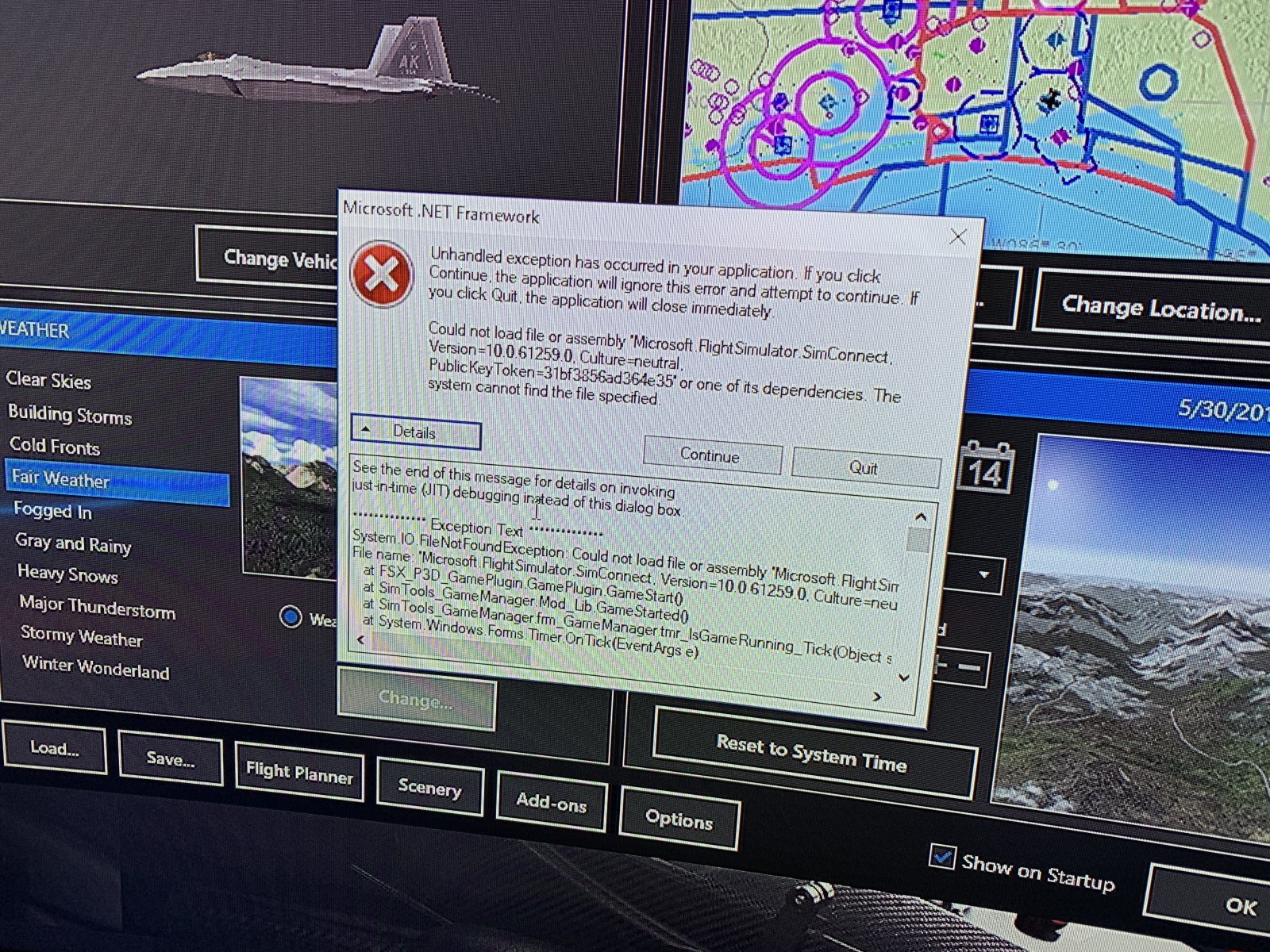

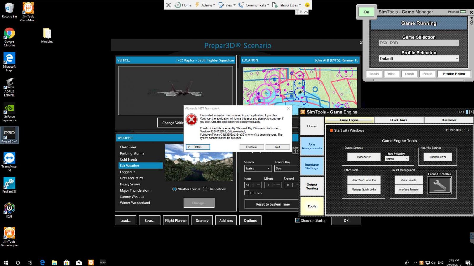

    We have Prepar3d v4.4 setup and have installed Simtools v2.2
    I have already removed FSUIPC and run the SimConnect installer as advised in https://www.xsimulator.net/community/faq/fsx-prepar3d-net-error.156/
    I have also installed the DirextX June 2010 as advised in another post, neither of these have helped.
    Upon launching game manage + game engine and prepar3d the error:
    "Unhandled exception has occured in your application. ..."
    "Could not load file or assembly 'Microsoft.FlightSimulator.Connect.Version=10.0.61259.0.Culture=neutral.PublicKey.Token=31bf3856ad364e35' or one of its dependenceies. The sytstem cannot find the file specified"
    Any help would be greatly appreciated.

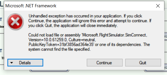

    Hello there,
    i am facing the Microsoft .Net problem while running the FSX.
    i installed SimConnect sdk as well but problem still exist.
    Error picture is attached.
    Waiting for the kind reply.
    TIA

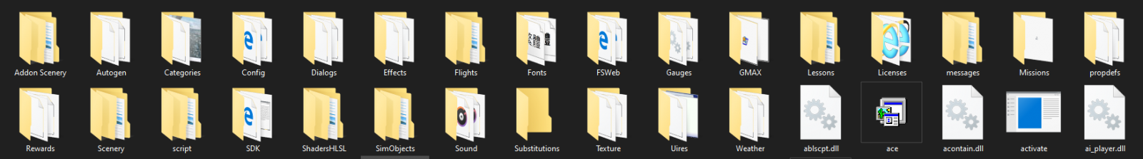

    i have following directories in FSX

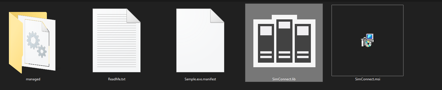

    Have a look in the SDKfolder for SimConnect.msi
  19. Kashif Saeed
    Kashif Saeed New Member
    Nov 23, 2019
    16
    49Coins
    2DOF, 3DOF, 6DOF
    thanks for the kind response @noorbeast
    Following files are available in the SDK folder and i opened SimConnect.msi but nothing happend.:(

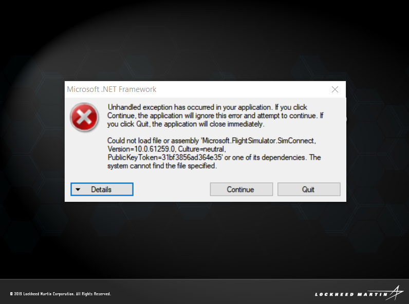

    hey @noorbeast
    i have installed P3D and the same thing is happening into P3D as well.
    i follow the instructions for SimConnect and install them but the problem still exist.
    problem screenshot is attached in this post and i am getting the following text in exception
    System.IO.FileNotFoundException: Could not load file or assembly 'Microsoft.FlightSimulator.SimConnect, Version=10.0.61259.0, Culture=neutral, PublicKeyToken=31bf3856ad364e35' or one of its dependencies. The system cannot find the file specified.
    File name: 'Microsoft.FlightSimulator.SimConnect, Version=10.0.61259.0, Culture=neutral, PublicKeyToken=31bf3856ad364e35'
    i am working on my 6-DOF flight simulator project. i need your help for this matter.:(
    TIA
