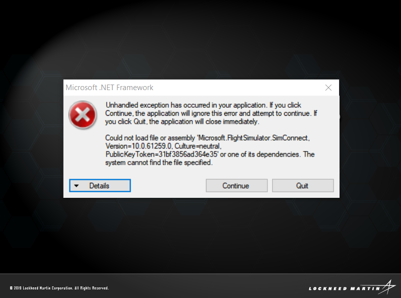

    Please hit the Details tab in the error message and post the full thing, perhaps @value1 can then work out what is going on.

    hey @noorbeast
    i have installed SimConnect.msi again and restarted my laptop and my error is gone now.:)
    Now, P3D providing the data but there is still no data of FSX.:(
