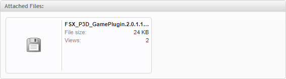

    You can try this new version of the plugin. I have magnified heave 10× when on concrete, asphalt or tarmac. However the surface type doesn't seem to be very accurate in FSX. Dunno about P3D.
    Note: You can also see the surface type in Game Dash.

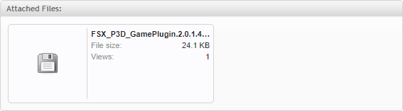

    Try this version (2.0.1.4). The old one (2.0.1.1) didn't factor in if you actually were on ground or airborn (heave was always magnified). In this version heave is only magnified when actually on ground.
    GameDash is not needed for this function. It's a nice add-on.
