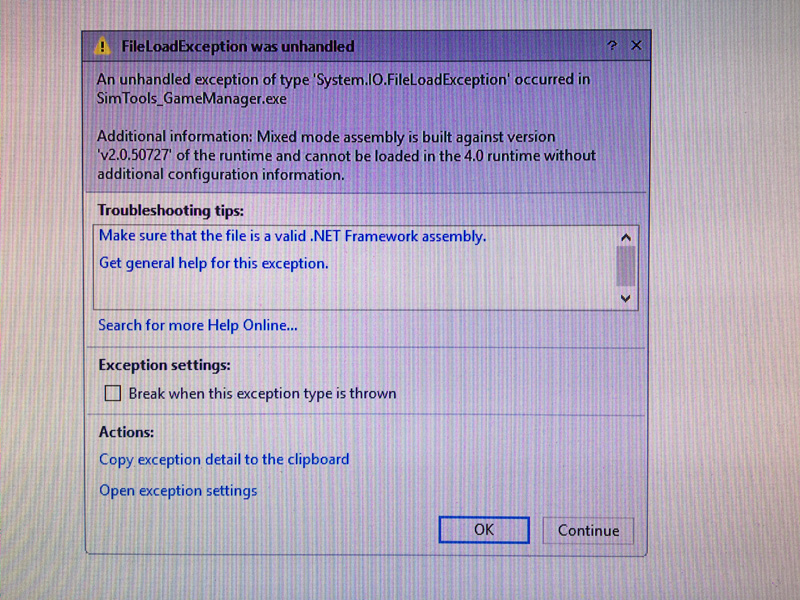

    I have a problem with Simtools GameManager crashing on startup in my FSX original install. (Not steam nor P3D). After closing the dialogs FSX continues to run. (Plugin 2.0.0.1 used).
    I read about the issue with installing SimConnect. All three .msi's were installed. The pc rebooted and everthing brought back up.
    Now I get a .NET Framework exception error, Simtools_GameManager.exe [7060]

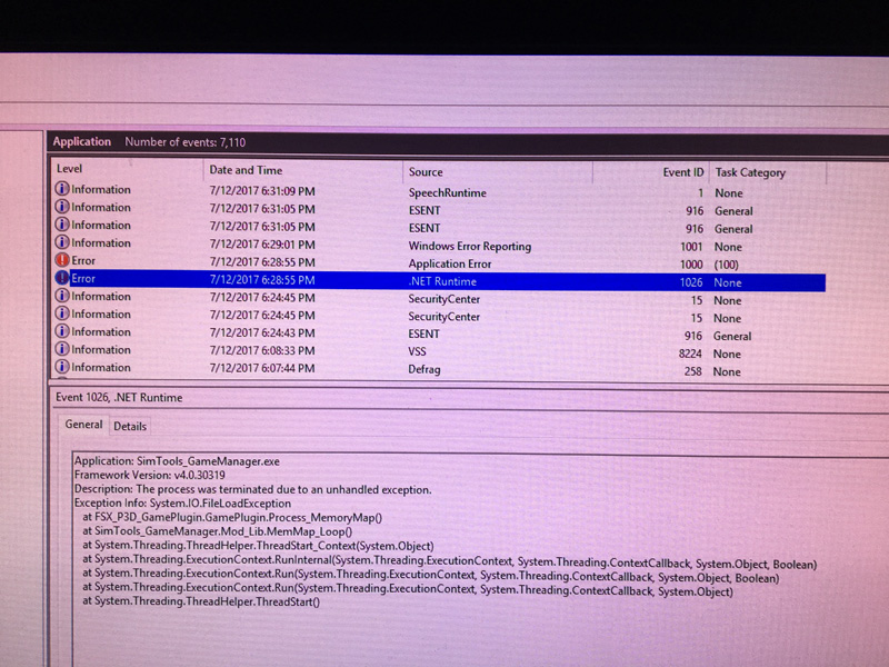

    Event viewer:
    Framework Version v4.0.30319
    System.IO.FileLoadException
    When I patch/unpatch the game in GameManager what files are altered? When I do a search of C:\Users\Dave\AppData\Roaming\Microsoft\FSX none of the files are altered that I can see?

    Can you please post a picture of the full .NET error message @BrassEm .

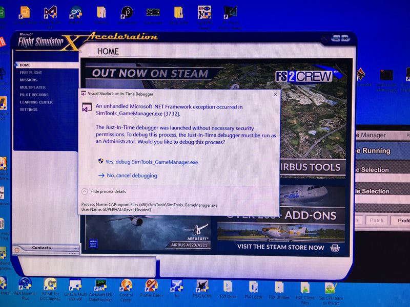

    I havent got an image host yet. The text is;
    An unhandled microsoft .NET framework exception occurred in SimTools_GameManager.exe [7060].
    The rest of the dialog gives the option to then select a Just In Time debugger. In my case it would be MS Visual Studio 2013. I didn't click on the view process details dropdown right at the very bottom. Will post that text tomorrow.

    Thanks noorbeast,
    I've worked out the number in the [ ] is simply the process ID at the time it is loaded in, which is why it keeps changing every time I try this.
    Directories;
    C:\Program Files (x86)\Microsoft Games\Microsoft Flight Simulator X
  12. yobuddy
    51,780Coins
    +5,206 / 19 / -0

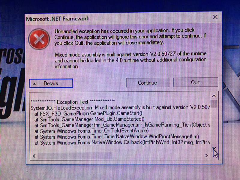

    Looks like whatever happened is blocking the memory map file from SimTools?

    Game Engine is obviously not interfacing with SimConnect via the .NET framework. User created mission content using SimConnect is working in FSX.
    I mentioned that my FSX install is not Steam or P3D. Is the pathing to .dll's set for all 3 versions? Steam and P3D have different pathing than the original?
    I take it from the error that Simtools is using memory mapping, kind of like FSUIPC, to get at variables?
    What changes are done when patching FSX with Simtools? (This will give me a clue on where to look.)

    @ yobuddy,
    Just tried Simtools V2.2. Same error. But this time Game Manager did not close. (No output to game engine of course.)
    After a bit more study it appears tha Simtools is using some .NET2 code that is being picked up as not being configured for in .NET4. From what I've read using google, I think the Visual Studio compiler needs an entry in the [application i.e. game_manager].exe.config file to accomodate this legacy.
    <startup useLegacyV2RuntimeActivationPolicy="true" ><supportedRuntimeversion="v4.0"sku=".NETFramework,Version=v4.0"/>
    </startup>
    Would you have something like this entry in your config file?

    SUCCESS!!!!
    It turns out that the .config file was the issue.
    I install Simtools on two PC's. Using the GameManager install on the Game PC and GameEngine on the Seat PC.
    The install script is installing SimTools_GameManager.exe.config to the GameEngine (Seat) PC directory Program Files(x86)>SimTools and not to the GameEngine (Game) PC directory Program Files(x86)>SimTools.
    This is confirmed due to the many uninstall and re-installs. (Hence my multiple firewall entries.)
    I copied over the SimTools_GameManager.exe.config over to my GameEngine (Game) PC directory Program Files(x86)>SimTools and it works like a charm.
    VERY HAPPY NOW!

    @BrassEm,
    Your right buddy!!
    I believe I have them installing for GameEngine and not GameManger!
    There are actually 2 files going to the wrong side i believe.
    "SimTools_GameManager.exe.config" and "wow64ext.dll".
    (with a single PC install, you would not see this problem btw)
    Can you remove them from the GameEngine side of things and confirm that things still work?
    (there is no reason for them to be on that side of things I believe)
    Once you test the idea, I will fix the installer.

    @yobuddy,
    I've deleted both "SimTools_GameManager.exe.config" and "wow64ext.dll" on my second Window7 64bit PC running Game Engine.
    FSX is working without issue as far as I can tell. (I am only at the initial point of setting up the axes but what I'm getting seems logical.)
