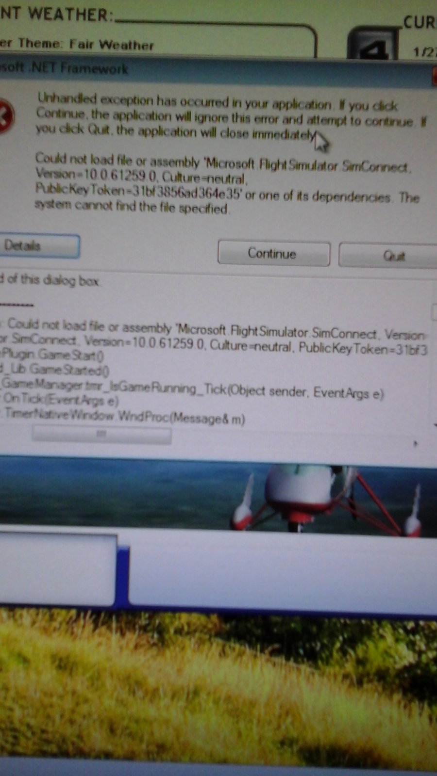

    Im having same issue, I think I just found out via FSX web site you have to have Deluxe and or GOLD to motion sim, the missing file comes with those versions, I have these version but this was a fresh loadedcomputer and fsx was working last week, Im betting this is it??

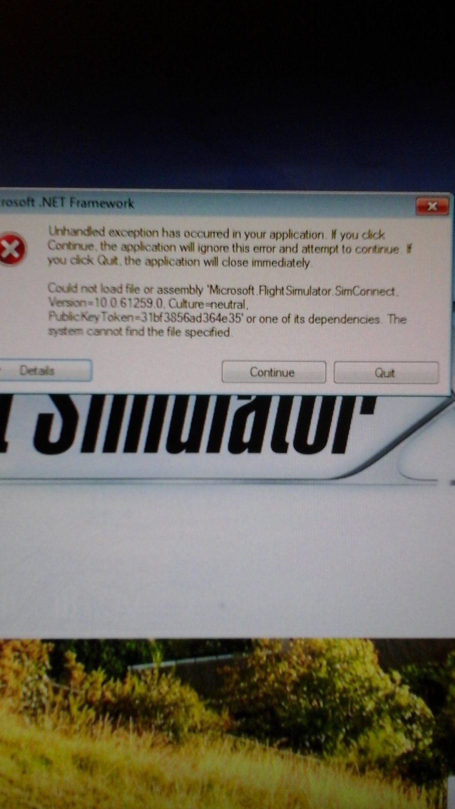

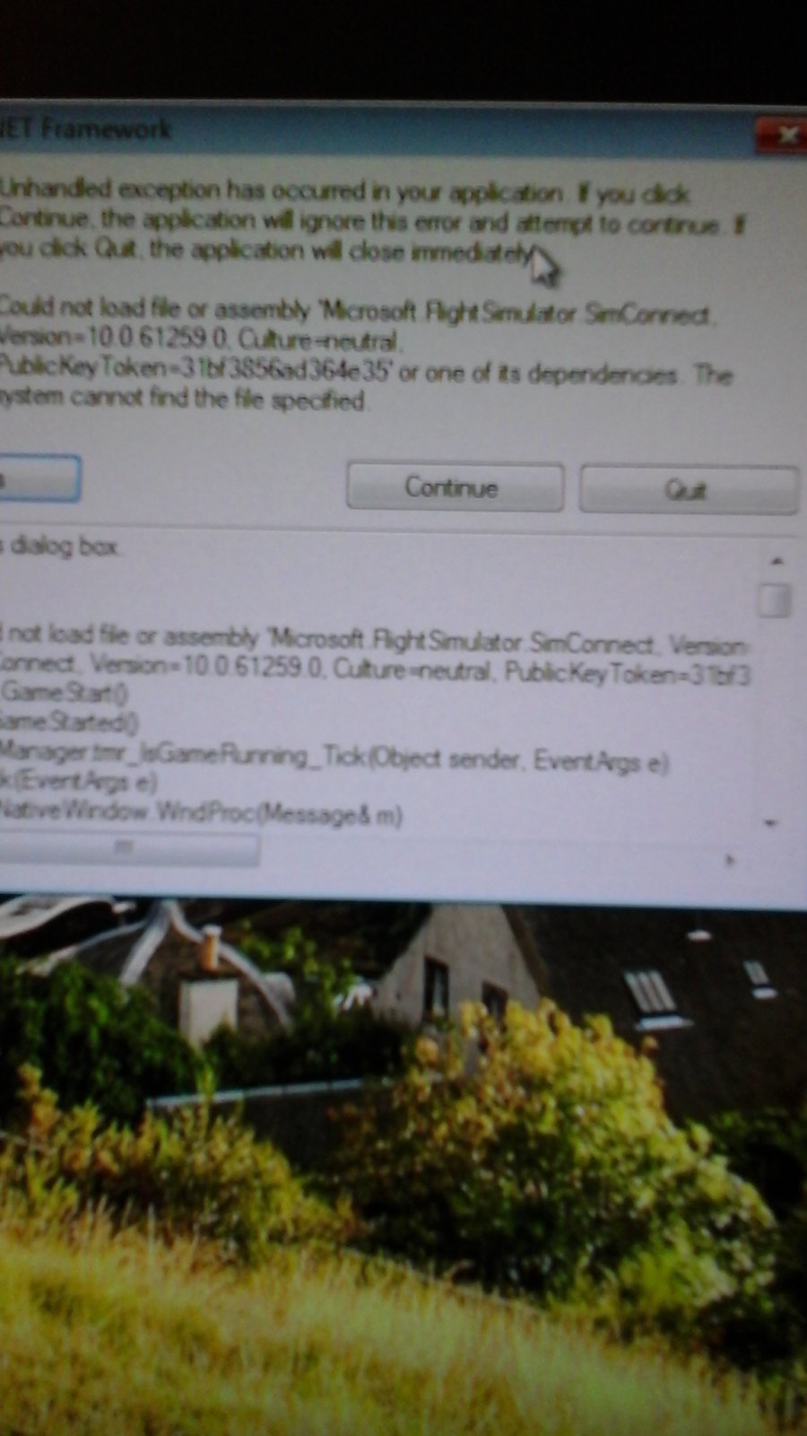

    I am unable to launch fsx, I get missing file error from simtools a Microsoft error, patch says successfull,
    I can select close on error, fsx will run with no game data passed.
    If I close out the rest of game manage n game engine error shows again.
    My setup runs race 03 pefectly.
    I have tried two pcs, new fsx load, new simtools 2.2 load, same results
  13. noorbeast
    22,230
    154,849Coins
    +11,229 / 57 / -2
    If you get an error then please post a picture of it, that may help narrow down what the issue is.

    I download a sdx zip file from FSX with 3 .msi files to install in order, and now the error is gone, I may have to re-install fsx now, That was part 4 of the zip, because I get no game data passed but says connected in Blue.

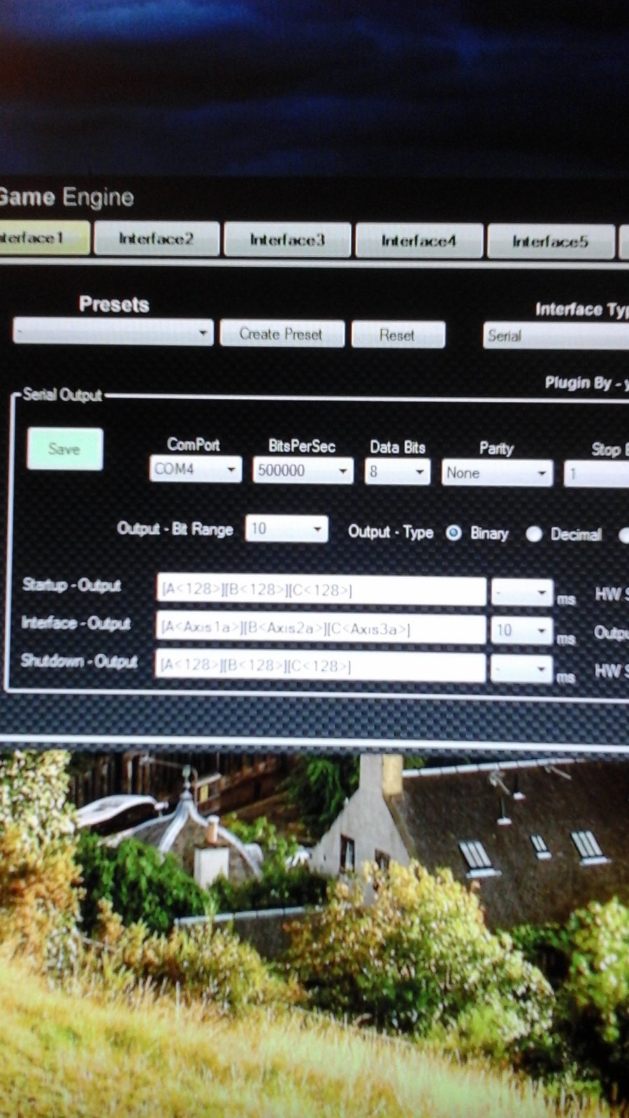

    Yes, At this time, I will go back to 2 pc setup again real soon, (was rough to edit and play game by ALT TAB
    I think I may now know why the sim-tools didn't talk each other, I didn't realize you had to set the IP in Both programs, even though they show the ip on the screen of each prg.
    I was only doing the one on the game manager that has the patch section cause it would warn me to re-patch the game, and was using the ip info from the game engine, didn't see the icon in game engine that you also change the ip address to the game manager?
    This is what I did, for 1 pc setup. And I got Race 03 and Dirt 3 running pretty good now, FSX close
