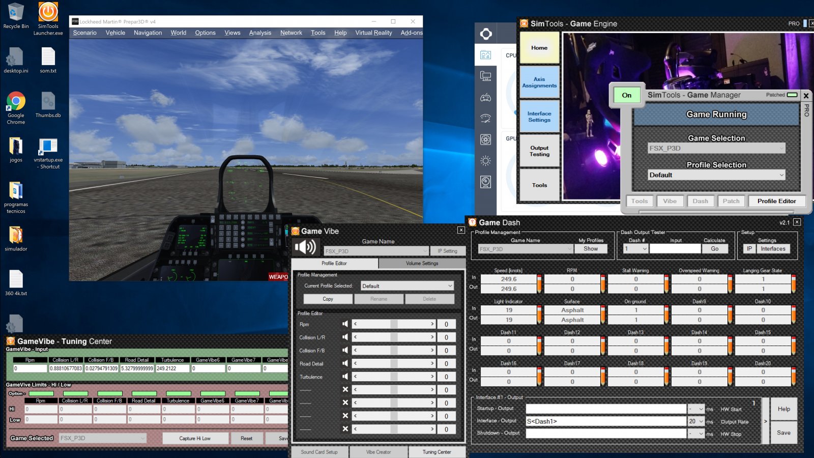

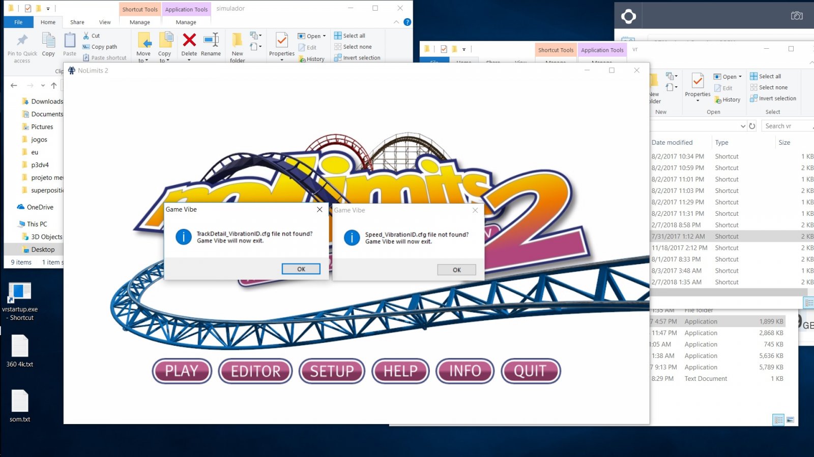

    moves ok. VIBES dont. ny idea? plugin ok, ip ok, dash output and tunning center ok... test with transducers and amplifiers.. ok. but no vibrations in game. test with admin rights, no admin, in game BEFORE and AFTER runs... dont works on any game. try asseto again and nothing...

    see images ( nolimits 2 and prepar )

    Looks like it need a small fix to the plugin itself.

    The FSX_P3D and the NLS plugins have already been fixed in the latest versions (2.0.2.0 and 2.0.1.17).
    @paulopsx2 Are you using these latest versions?

    yes.. and asseto too, and project cars, and others.. all plugins same problem. ALL WORKS, show on dash, show on vibe tunning center, test sound on gamevibe its ok.. but no vibrations... this is freakin and burn my mind rs.. i try ALL... put game, track.. and after this open plugin, or open before... nothing works.

    yeah... i think about.. but.. on ALL PLUGINS? asseto dont work, NLS dont works.. none of then... weird

    Can you get sound when using the Vibe Creator?

    i dont try this yet... only "test mode" on soundcard 1 and 2. it works.
