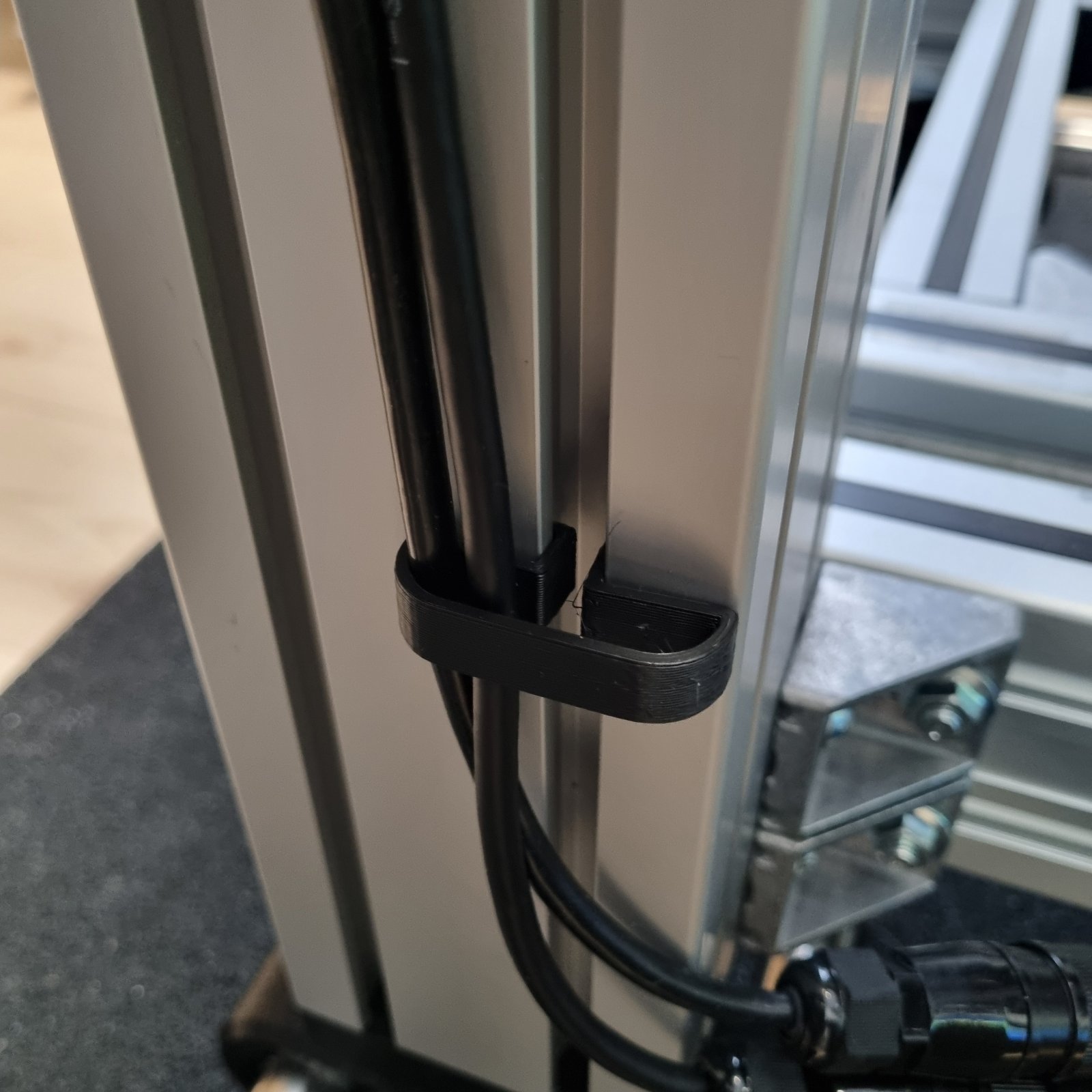

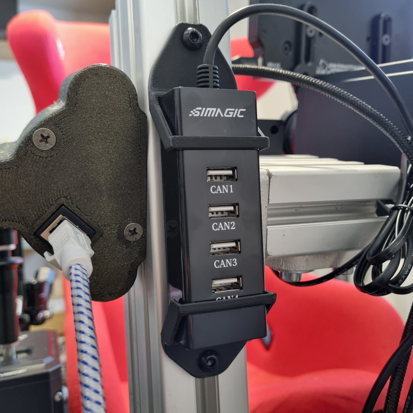

    At the weekend I added the handbrake and shifter and at the same time re-routed all the cables. I also printed cable clips and holders for all PSUs, so everything is now much tidier. I don't think much of cable channels and boxes, in my case they would only work to a limited extent and wouldn't look any better.
    I have published a few files on Printables. These include holders for Simagic Hub and PSU, as well as E-Stop and an adjustable Vesamount.

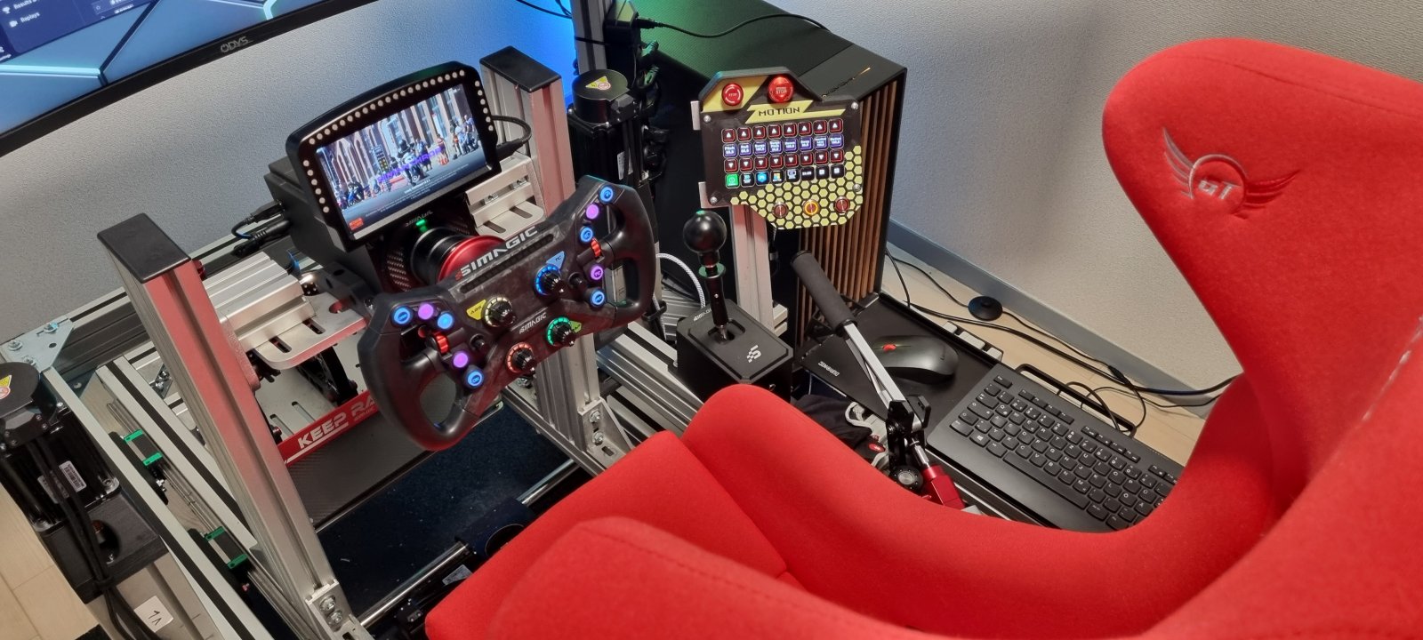

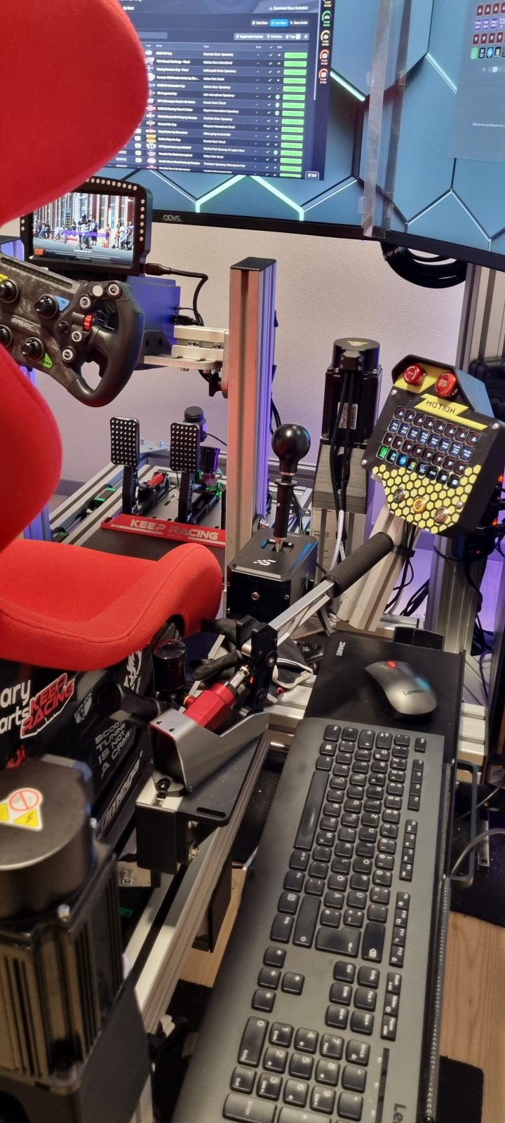

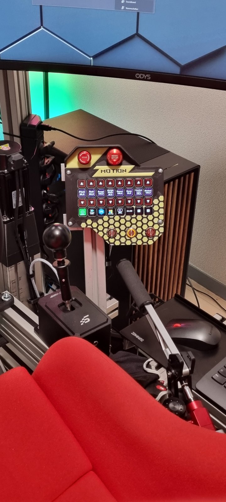

    Changed a few things again. The mouse and keyboard now have their place and my “button box” is almost finished and has already taken its place. Buttonbox contains a Streamdeck XL, emergency stop for the Simagic Base and Thanos motion controller and the 3 buttons for the Thanos controller. 20250216_213513.jpg 20250216_213539.jpg 20250216_213830.jpg 20250216_213844.jpg
    Really happy and there will be not many changes or updates in the future. Now it´s time to drive and enjoy.

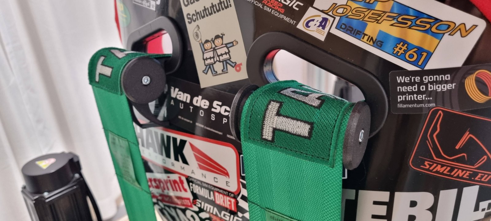

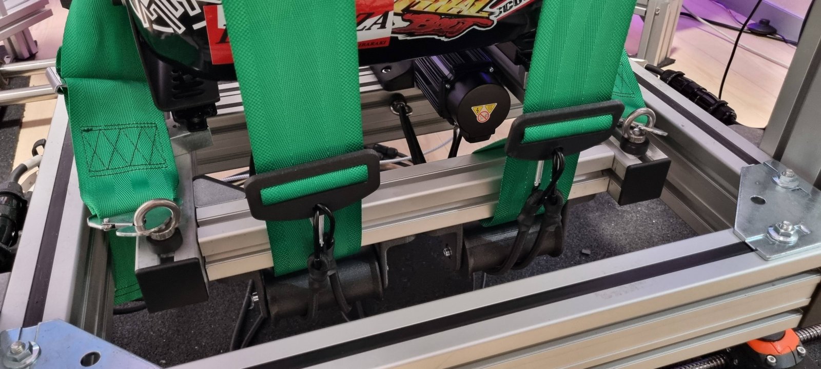

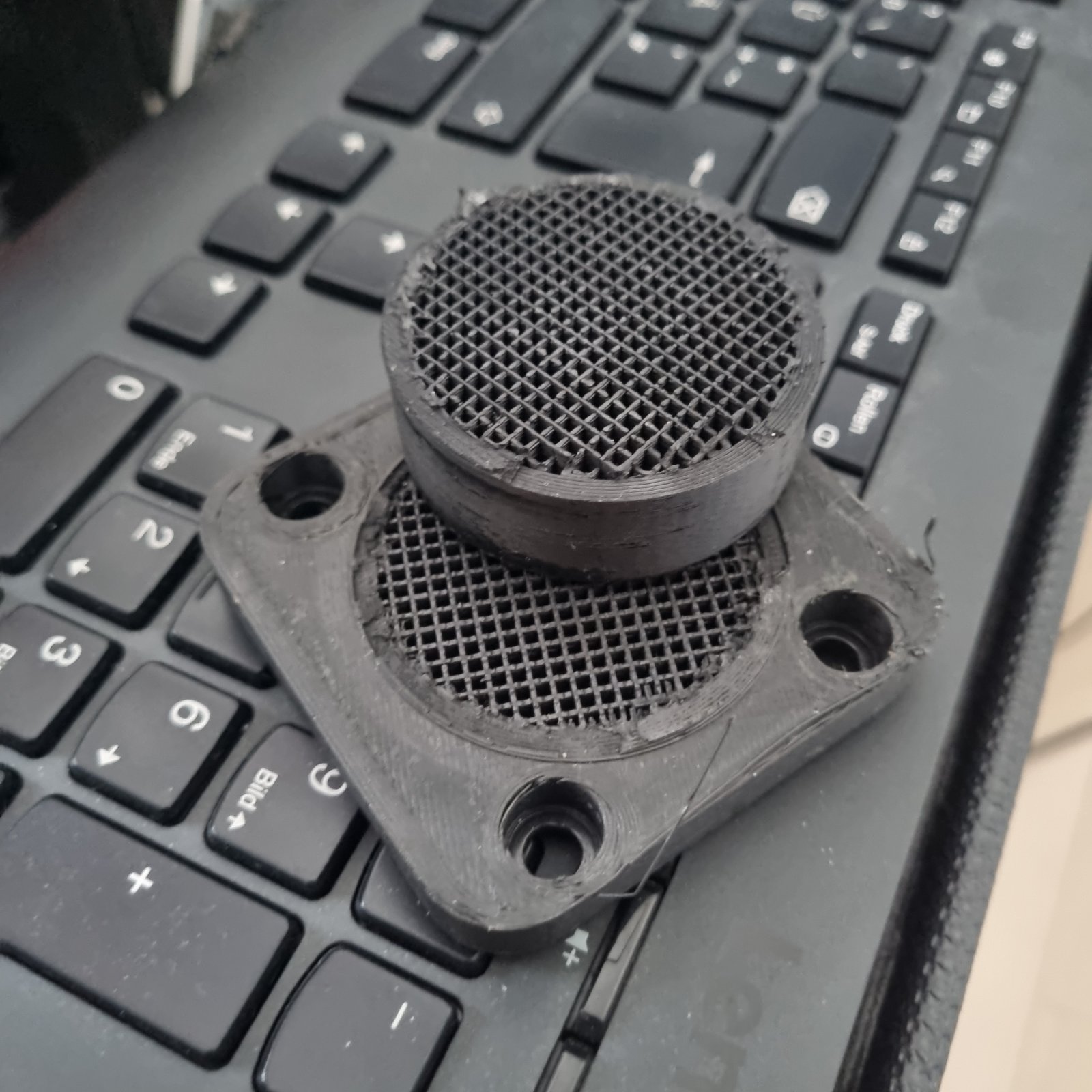

    Small Update, maybe for some people interesting which have an Surge Axis but don´t want to build an additional motor driven Belt tensioner.
    The rubber bands will pull on the Belts when the Surge Axis is moving while braking. Works great and the strength can be changed. It was only an sideproject the last 6weeks to get motivation again and i wanted some experience how it is do drive with belttensioner. In my opinion it´s no gamechanger or anything else and don´t know if i will use it a long time

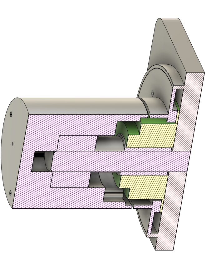

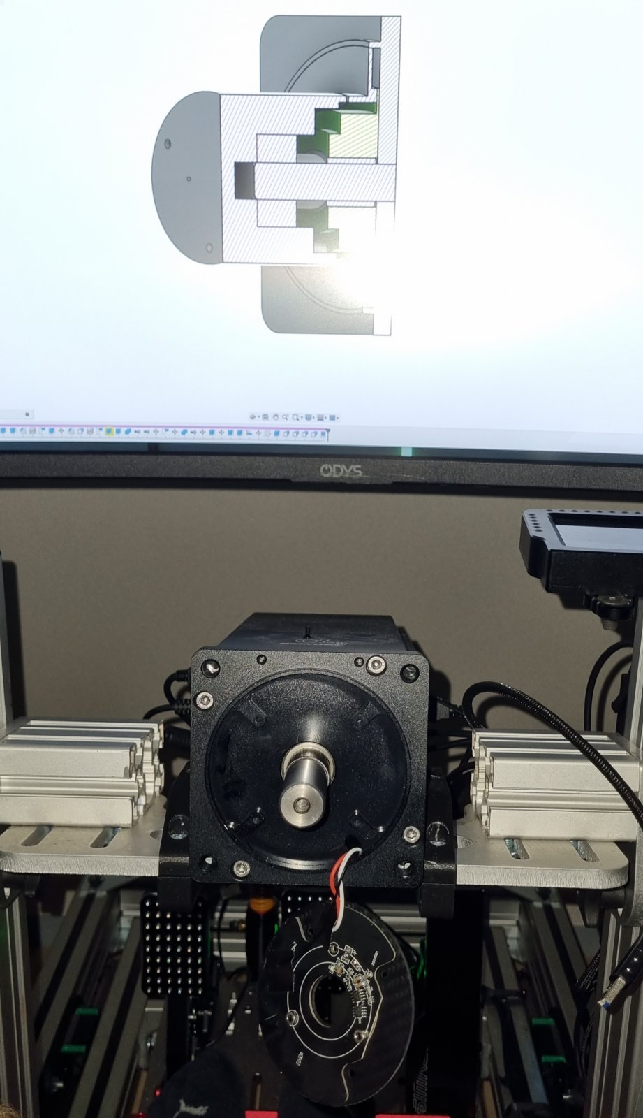

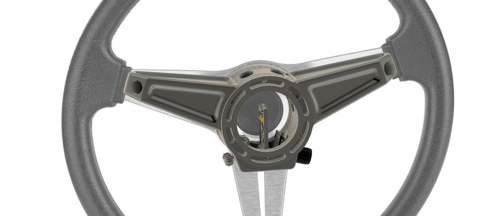

    I had a big interest in the new Conspit 300GT Wheel but i don´t want an coiled cable and after watching an Video about Dan Suzuki´s QR System, i got the idea to adapt the VRS USB-passthrough on the Simagic Alpha Ultimate Base. Simagic doesnt want to sell their Slipring and Wheelbase QR with PCB at the moment, so i have to use the VRS one.
    After taking first measurements and some cad designing, it would fit the base really good without any big issues. Only two parts has to be printed and it should be done.

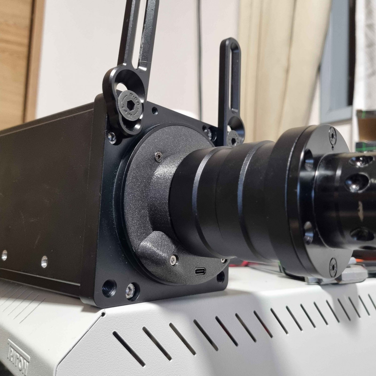

    I finished the Desin of the USB-Passthrough and printed the parts with XPETG, should be fine for the application.

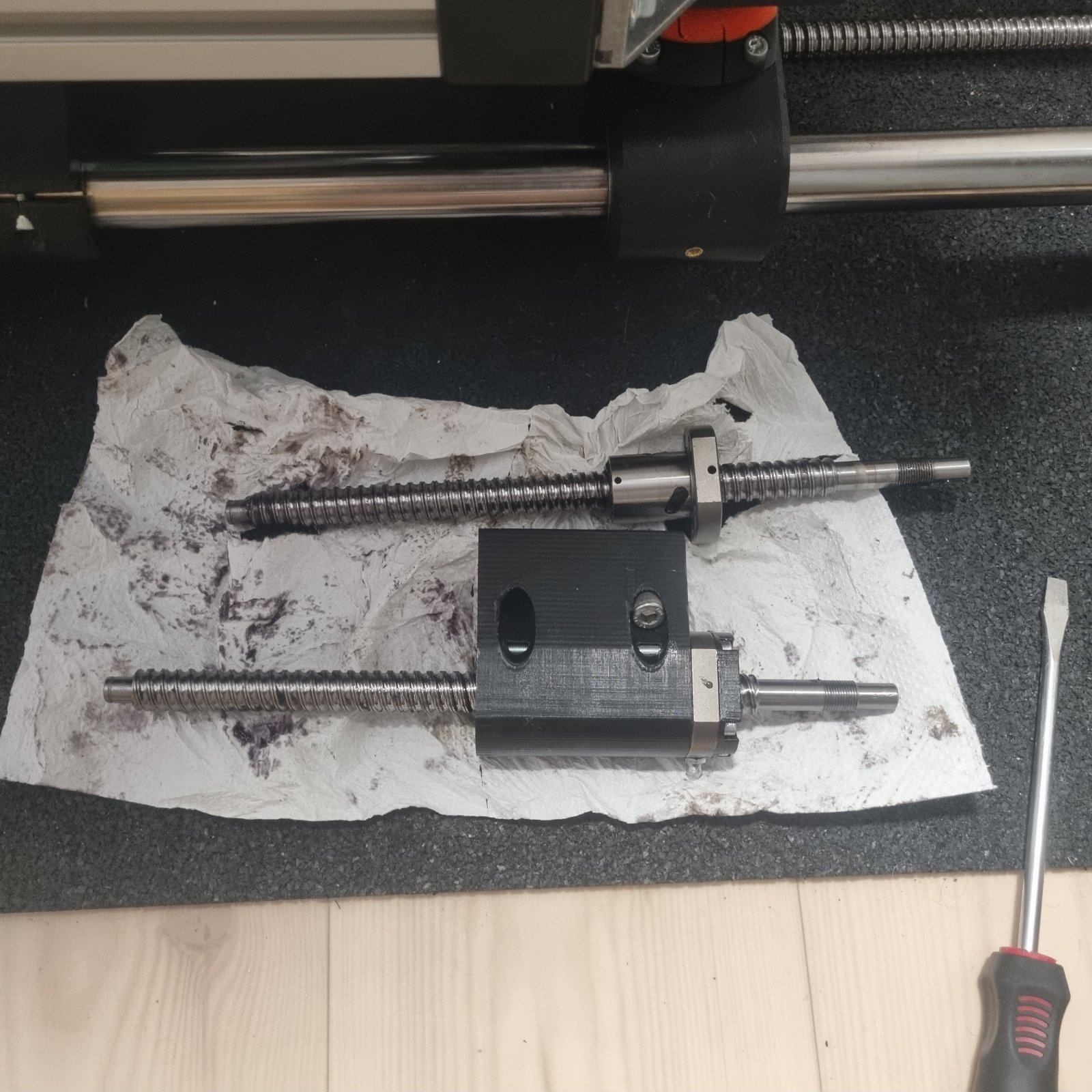

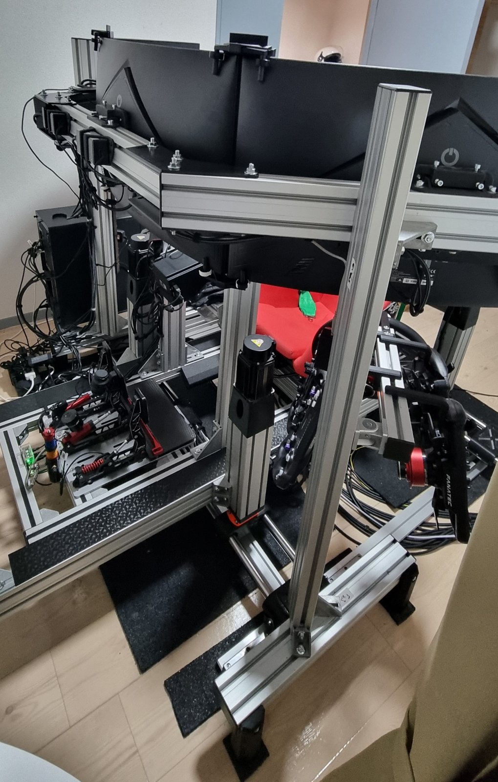

    And yesterday i changed my Surgeaxis from 5mm to 10mm Pitch. There were different Reasons for it. I wasn´t justified completely how the axis reacted and tested many things like 220V, 100V, aggressive settings and washout effect(Simhub). I even took apart the axis, re-greased it, and completely realigned it to make sure the rig wouldn't warp under stress because the ball screw made some noise lately. Since I had been ordering from a cheap Far East online retailer anyway for the USB passthrough project, I also ordered a ball screw with a 10 mm pitch.
    And i was surprised how well this turned out. It´s silent again and can be much more violant if you want it. Additional with the Washout-effect in Simhub it´s finally like i want it.

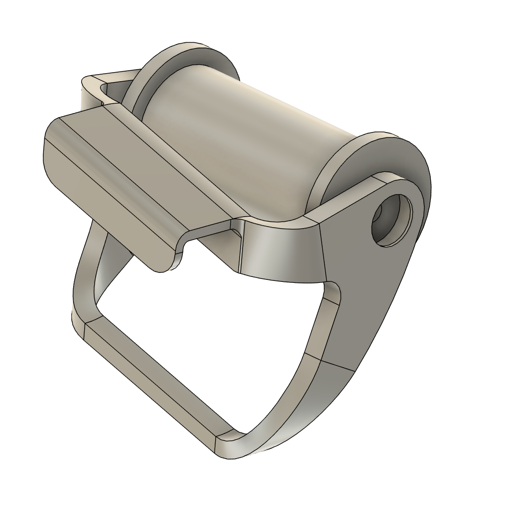

    I changed the Design and have published them on Printables: https://www.printables.com/model/1418782-roller-for-belttensioner
    I am working on different Improvements on my Rig at the moment.

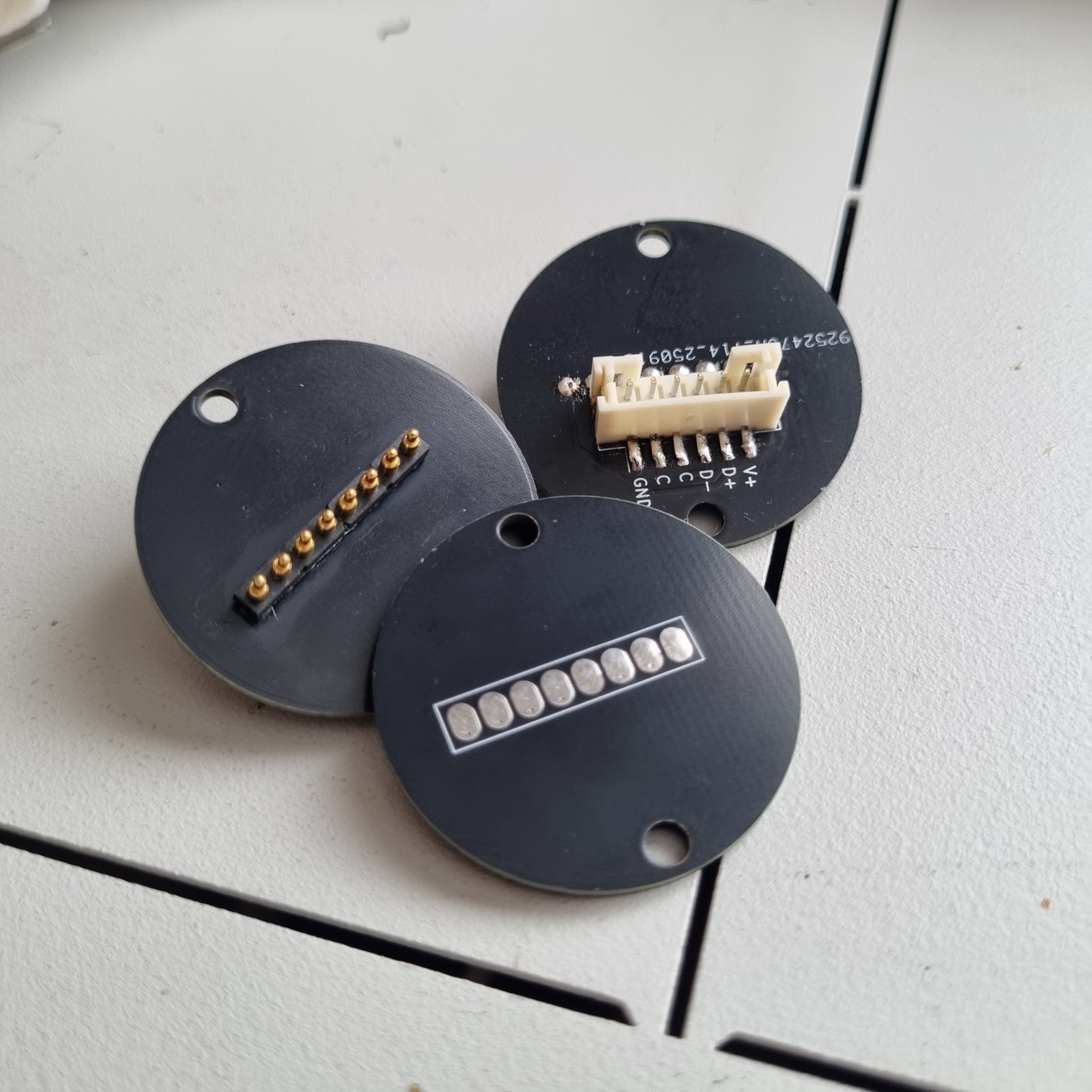

    • I designed my own Simagic Compatible PCB´s. So i can use 50/70mm QR´s in combination with USB-Passthrough(no need to buy the more expensive QR-A)
    • Had some Time to improve my Belttensioner Rollers

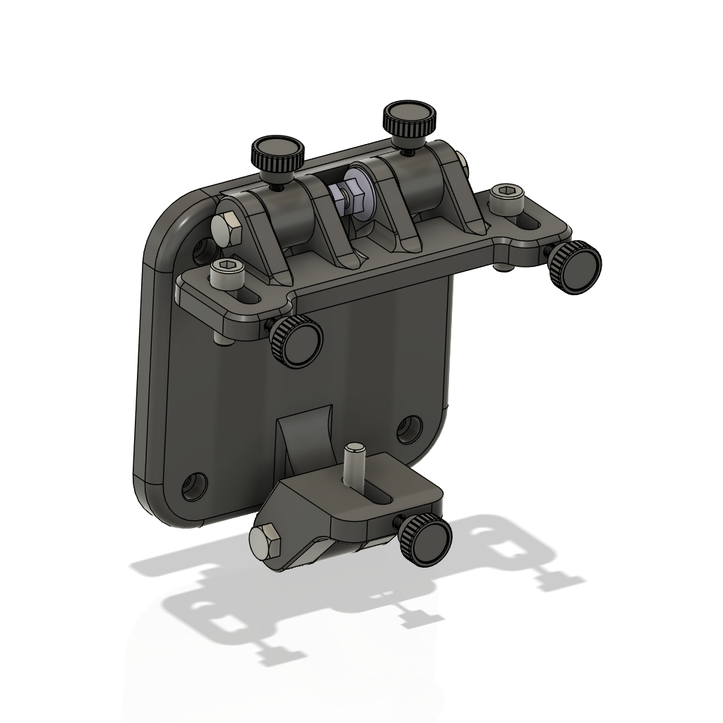

    • Finished the second Version of my Adjustable Vesamounts, which are now usable with Motionrigs(want to attach my Triplescreen on my Motionrig, instead of an seperate Stand)

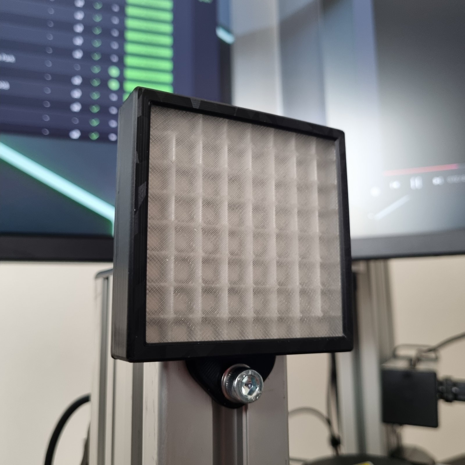

    • Designed two Housings for an Iflag, had the parts for it lying around for a long time

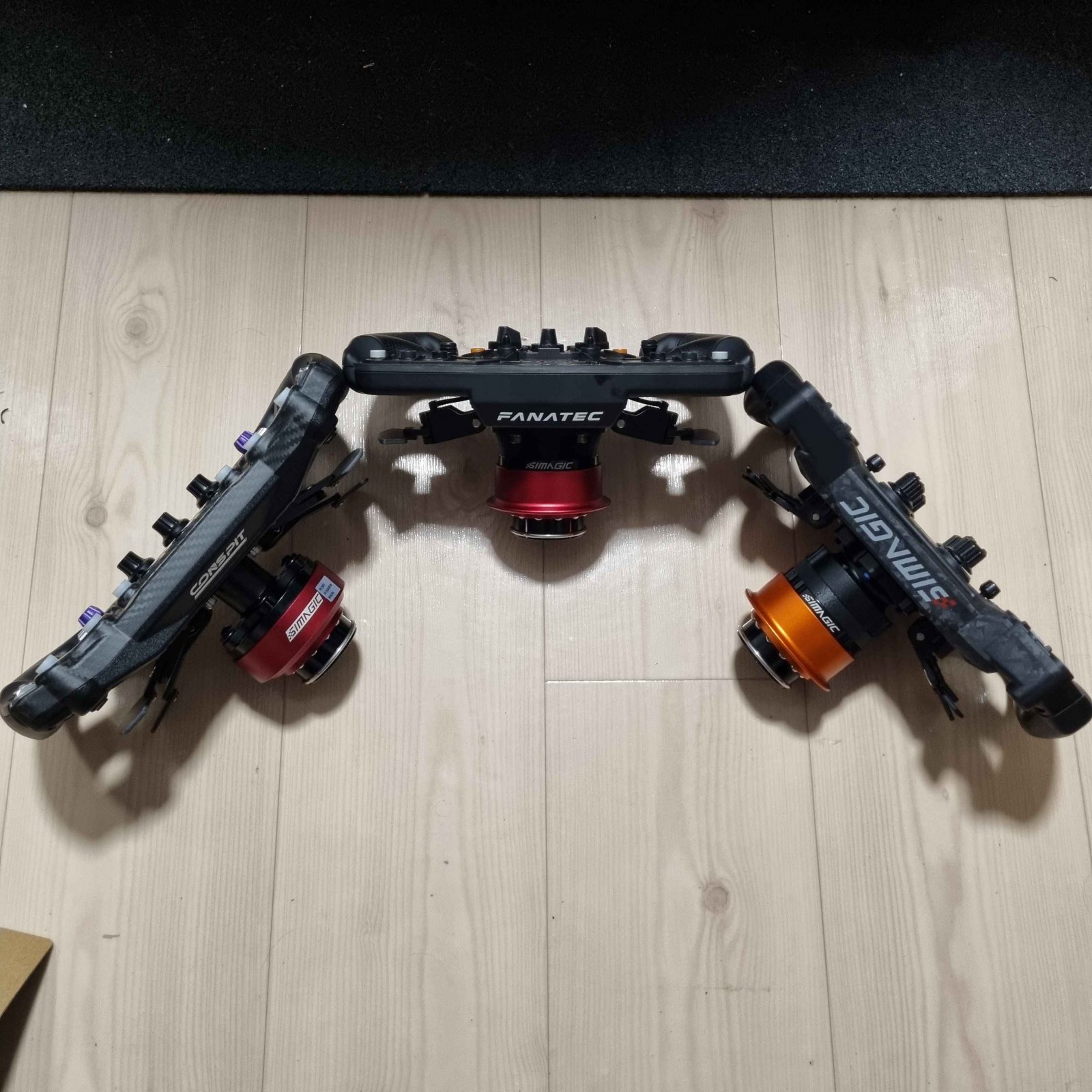

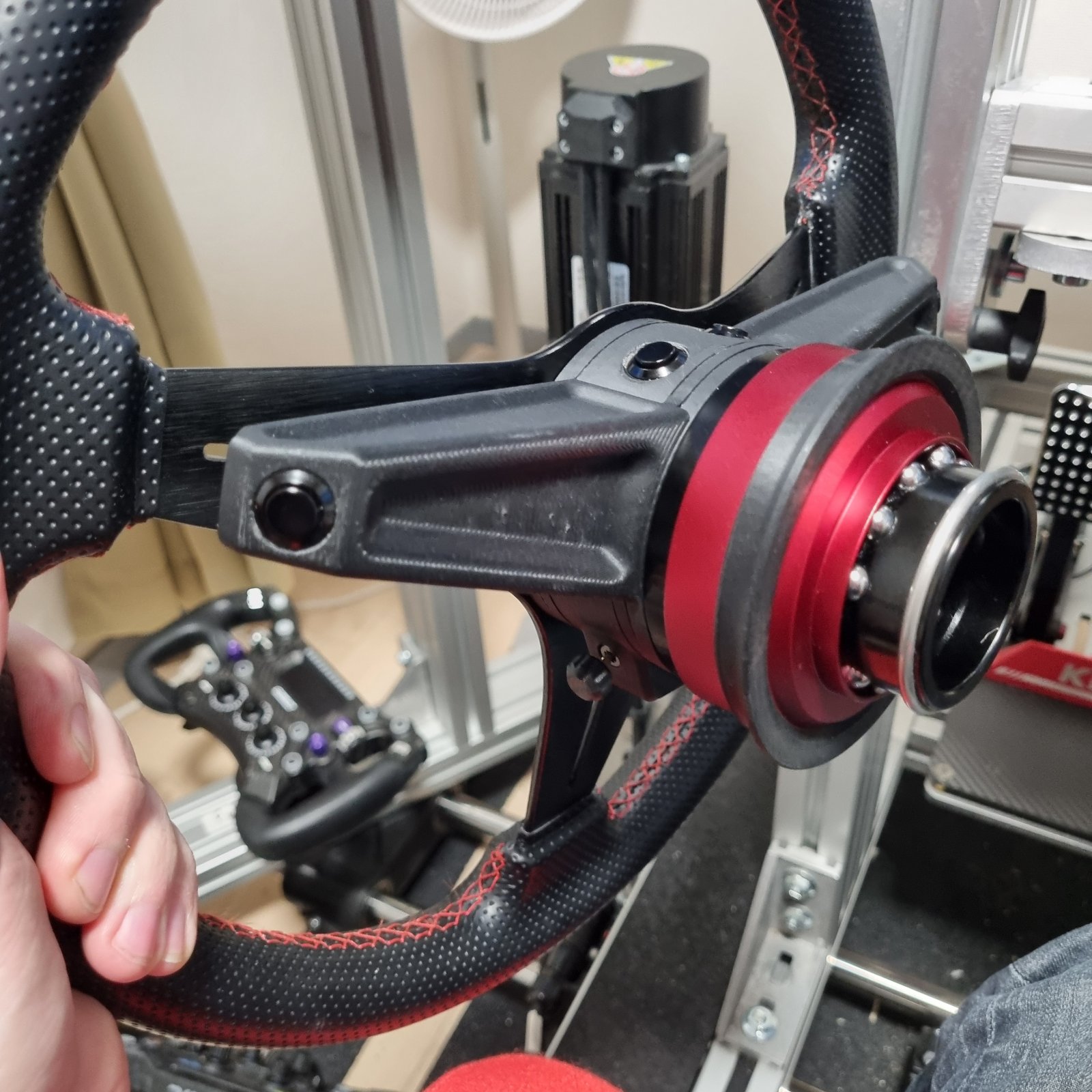

    My USB-Passthrough Conversion is finished and works great, additional I designed my own Simagic compatible PCB´s, because I didn´t like the available solutions.

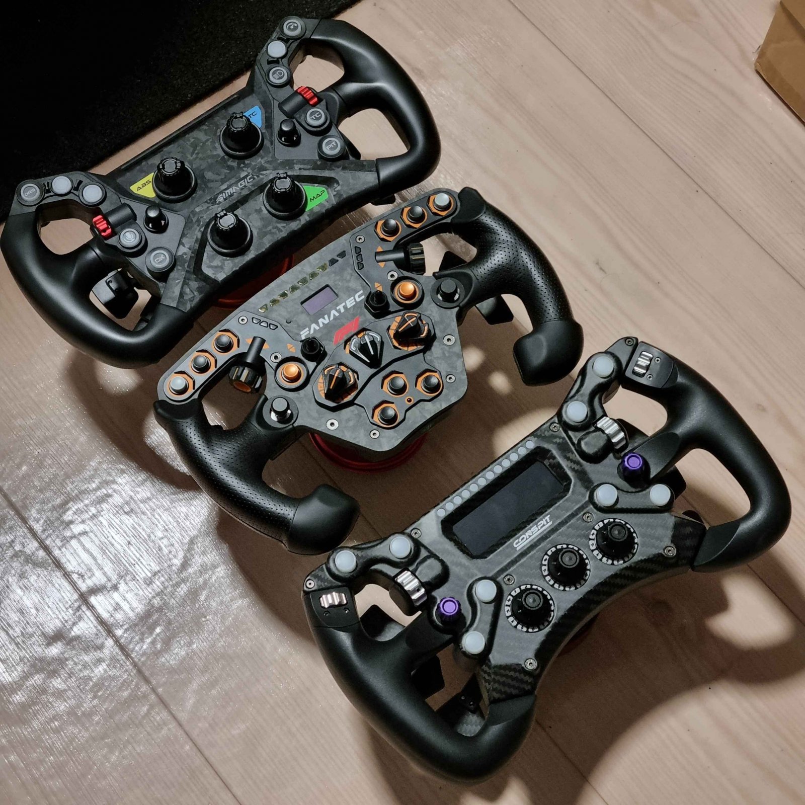

    Converted all my Wheels to NRG-style Quickreleases and all the Wheels have now the same Height(Distance from Wheel to QR)

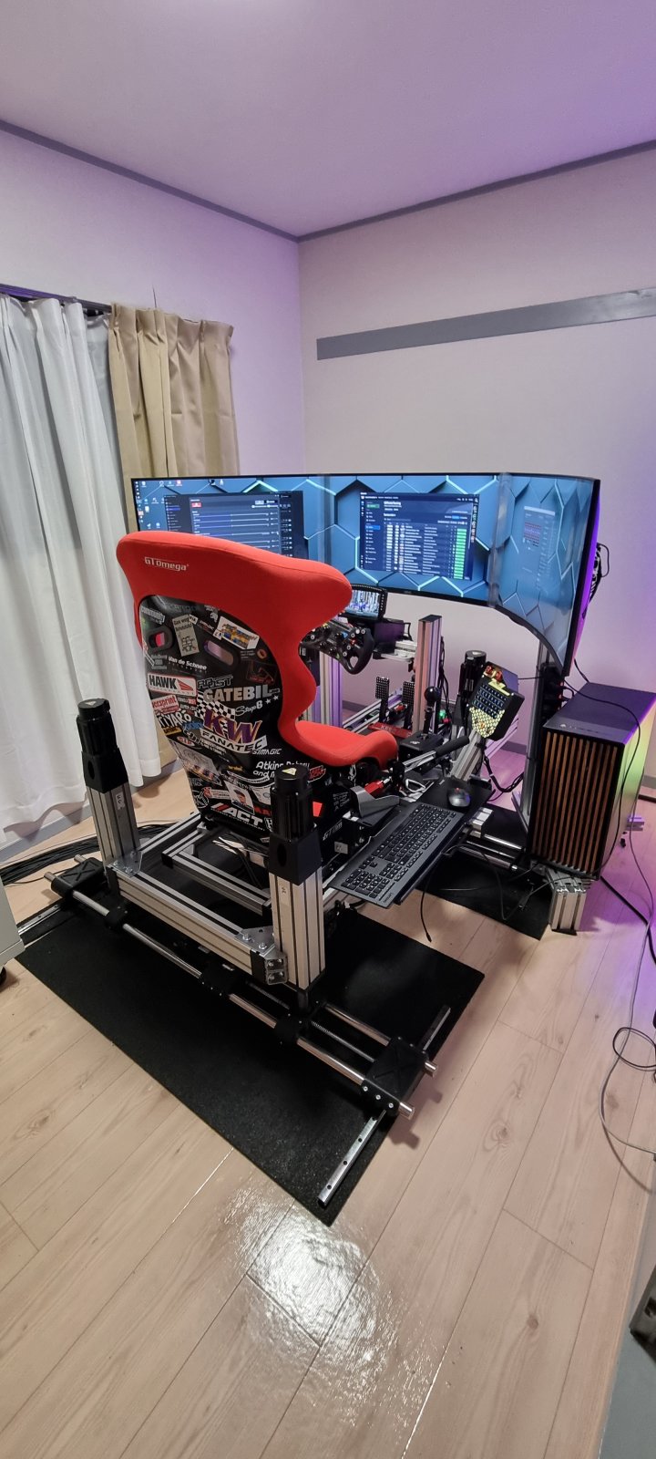

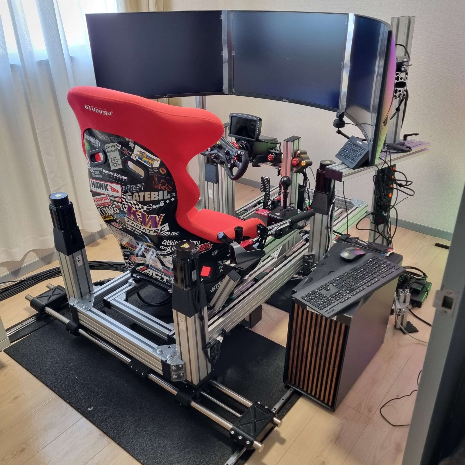

    Now waiting for the final parts to get my fanatec wheels usb converted. Then also this project is finished.
    After that i will rebuild my Stand for my Triplescreen, need to buy some bolts for it next week.
