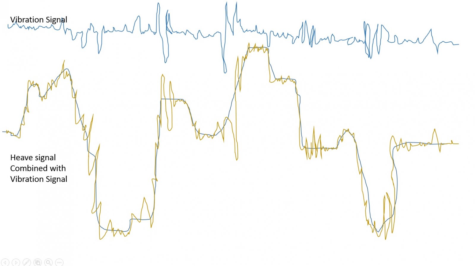

    But the video doesn't show what you drew in your hand drawn example imo.
    Its one thing to oscillate back and forth at a consistent higher frequency but another to do it while heaving at the same time. I thought that was what you were after since it’s not difficult to do one independently of the other. If you’re not getting enough road surface information in heave already you could probably stand to use lower tuning numbers and work on your controller settings some.

    That's because the Heave test function I used for this test just gives the max amplitude and only center position of the actuator. If the amplitude of the vibration signal is limited to 1/10nth or 1/100nth of the nornal position signal and shift its center to follow the larger position signal, it would work as desired. The vibration signal is AC signal not DC, so its center will be always on the 50% of the vibration signal.
    Anyway. I'll be experimenting with this in hardware the next days, while Dustin works on its software version.
