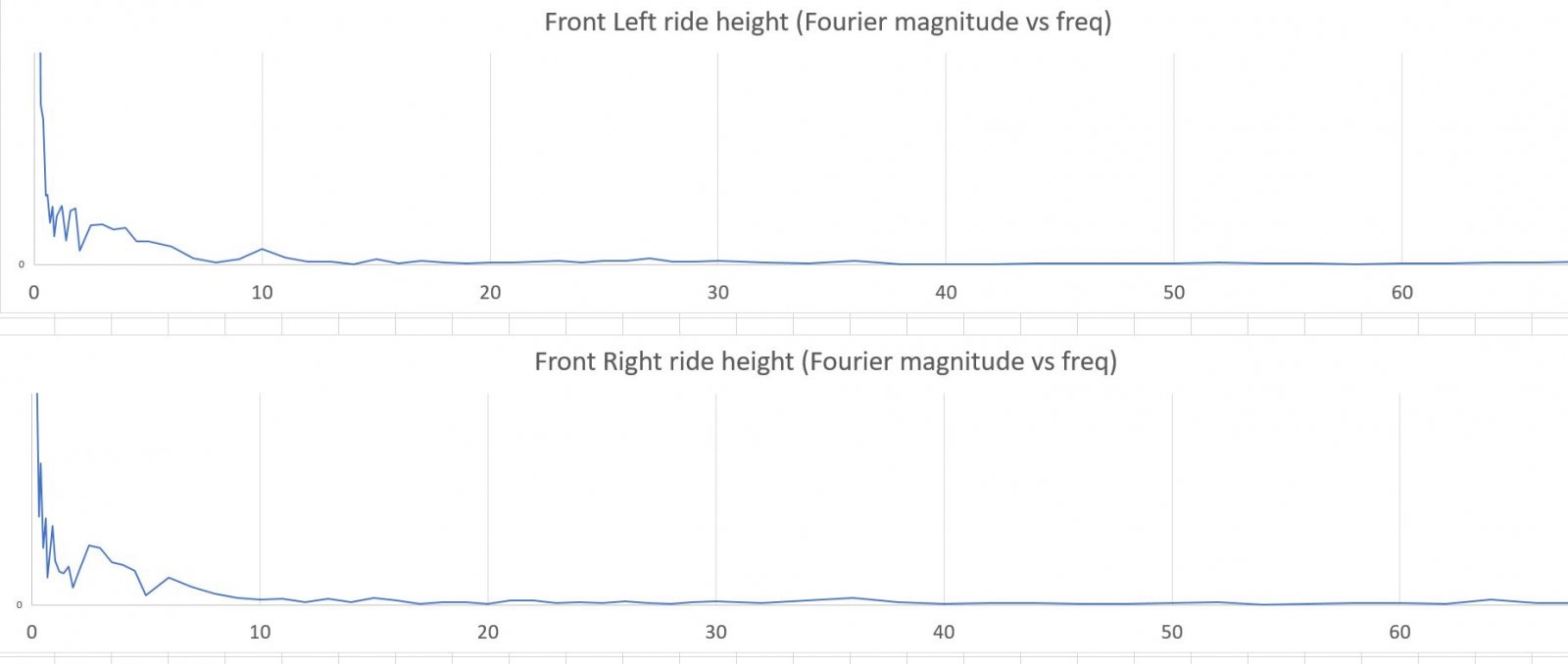

    I have asked to add two extras for inputs of Front left and Front right chassis RideHeights data.
    With such feeds to my front two actuators, I bet would feel much more realistic. Currently the heave/roll/pitch data SimTool feeds for D-box style just not adequate (the vibration fundamental mode < 0.1Hz, lack of higher modes). You will not feel vibrations or micro bump or road surface details. By using chassis rideHeights data will overcome this. In fact, you don't need an actuator to be capable of vibrating at very high Freq. The max freq for vibrating the chassis is less then 15Hz.
    Here the results for front left and right chassis rightHeights spectrum analysis I did with rF2 GT car data on Silverston track:

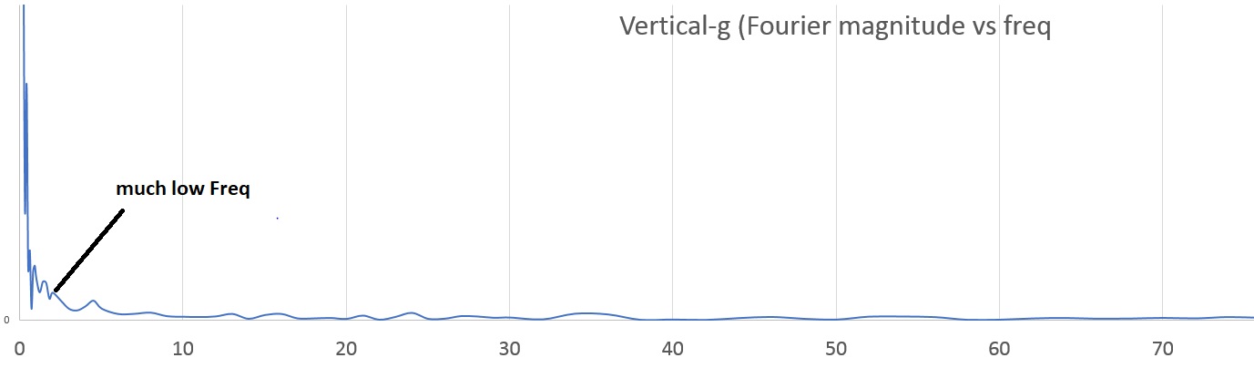

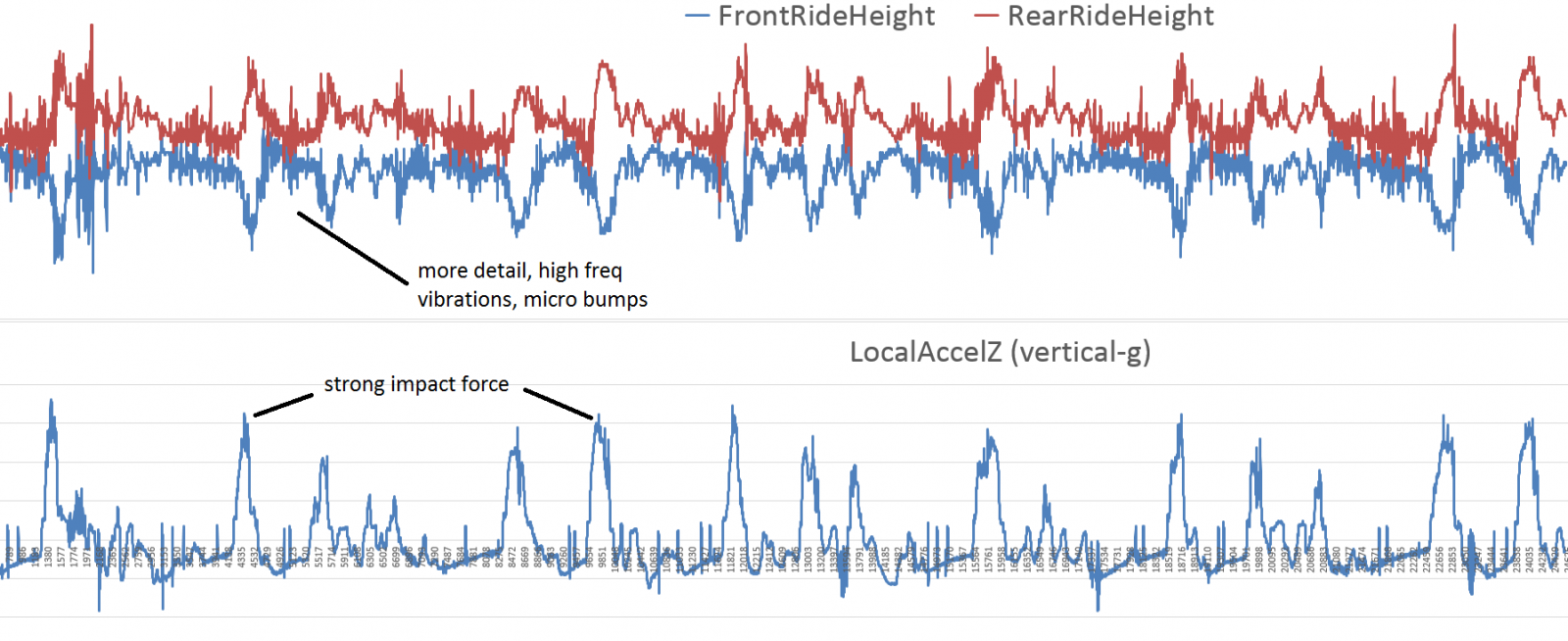

    The heave data from vertical-g as SimTool used has much less detail and low freq, which feel is not coherent with racing car if use this alone for chassis vertical movement (OK for flight sim I think):
    vertical g data: strong fundamental mode ~ 0.1 Hz; and 1st mode at ~ 0.4Hz, but lack of high freqs.
    That suggests the ride heights data contains more road surface textures, high freq vibrations and micro bumps, while the vertical g data contains main bumps with strong impact force. This is understandable since the vertical-g data is the 2nd derivative of CG rideHeight in respective to time, hence with far less spatial information.

    We don't sit on top of the shocks thou, we sit on the chassis of the vehicle.
    So there would be less vibrations applied at the chassis, as its the end result of all of these forces affecting the chassis.
    Also for a 4 legged sim anyway, if you did send ride height independently to each actuator, they all would kick unevenly causing one (maybe 2 at times) actuator(s) to lift off the ground.
    Sure thou, one could build a plugin with these values if they wanted to.
    Anything can be used in a plugin really.
