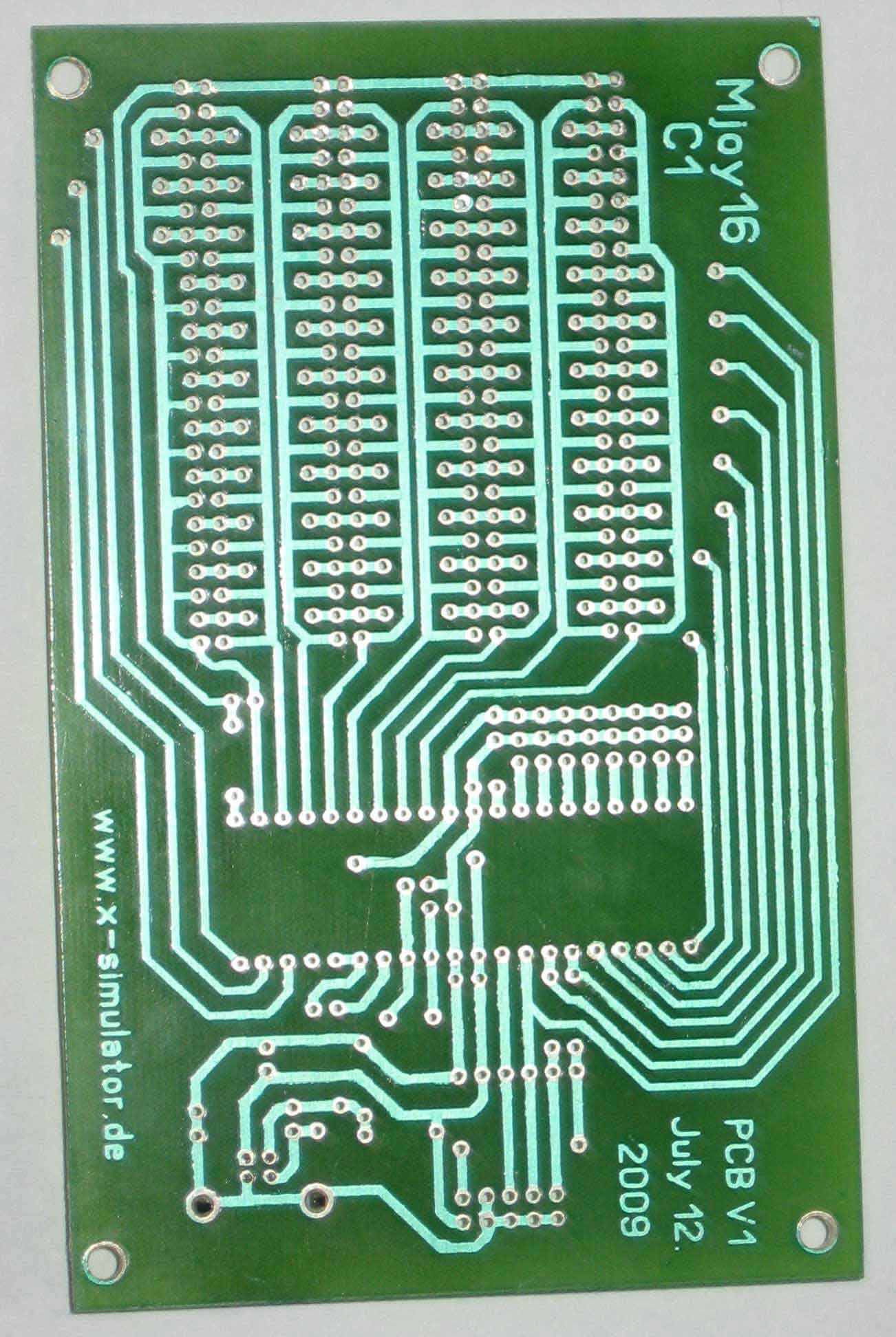

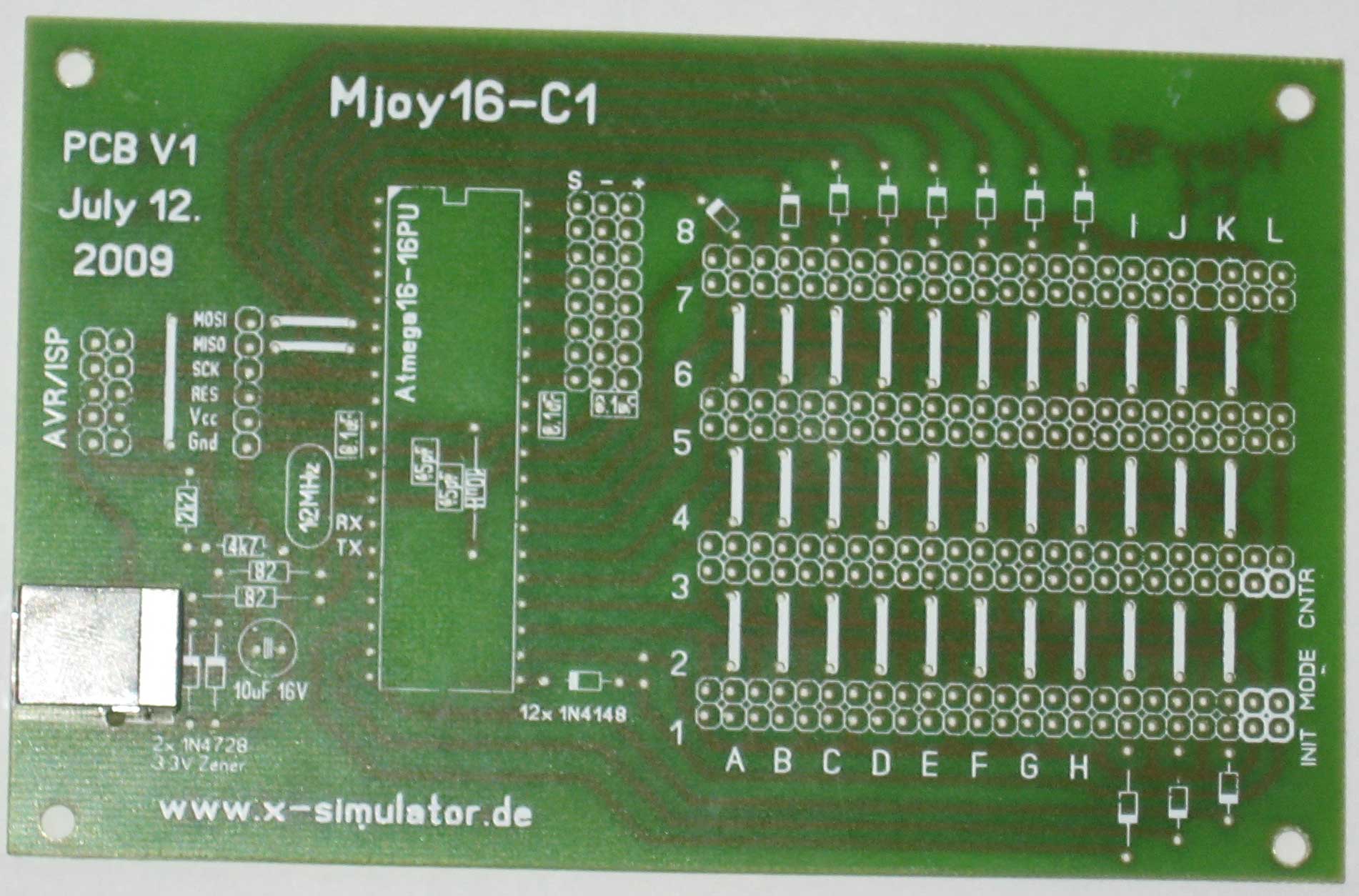

  10. Frakk
    Frakk Active Member
    Apr 15, 2009
    1,144
    328Coins
    Fred, you are correct. The printer port is only for programming, after that you will only use the USB. Alternatively the 10pin ISP header can be used with proper off the shelf programmers. I don't know what the wiki page lists, but the parts are marked on the pcb silkscreen. I am posting an updated schematic with all the diodes in place. I will make a full writeup, partslist, and the necessary pictures once I get my board made. Until then, please use the updated layouts: Copper13.5x8.5.pdf Position13.5x8.5.pdf
    Chandran, I sent you the new board and you made the old one :( It's ok, I'll help you fix it once you get it programmed.

  18. Frakk
    Frakk Active Member
    Apr 15, 2009
    1,144
    328Coins
    Hello crobol!
    I am making a write-up and a how-to guide to make my version of the Mjoy16-C1. I will include pictures and the total description of what to do and how to solder the all-in one controller and matrix board. I will also provide the files and the original manual from Mindaugas.
    Just hang in there, and I'll post it as soon as possible!
