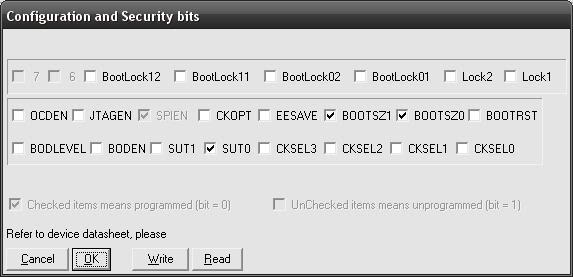

    It has been 4 weeks i have been trying to build my own MJOY 16 C1. I cannot make it work whatever i try!
    Now i am getting frustrated and i would like to ask your help..
    The ATmega16 was programmed on a programmer which is a clone of the STK200/300 ISP from AVR.
    The programming was done through PonyProg with WRITE successful! message and these fuses:
    I did it with EAGLE (software design tool) and PCB. It didn't work, Windows said USB device not recognized.
    Schematic
    PCB
    I then did it on a veroboard to see if i would get it ok this time. This did not work either.
    Then i did it on breadboard and -oh what a surprise!- it DID NOT WORK this time either!
    I know that the HEX is programmed on the chip, i can read the EEPROM which has 5 bytes written and the RAM that seems to be ok. Verification from Ponyprog says it is OK... Only thing that does not make so much sense is that the HEX file has CRC: EA4Eh and the written file on the ATmega16 has a different CRC: A674h

  20. Frakk
    Frakk Active Member
    Apr 15, 2009
    1,144
    328Coins
    Are you using the parallel port programmer or the STK clone now? You should read back the same file from the device than you put on it, so my first bet is a programming issue.
    I know you said Ponyprog says it is successful but It doesn't necessarily mean it doesn't have errors. Have you programmed AVR's with Ponyprog before that worked, or is this the first? I haven't tried programming with a STK clone and Pony, the parallel port and the serial interface works. Try those.
    I didn't the EEPROM file into the uC and still good for me, try to erease everything then program only the hex.
    Why do you have a diode between PC2 and PD7?
