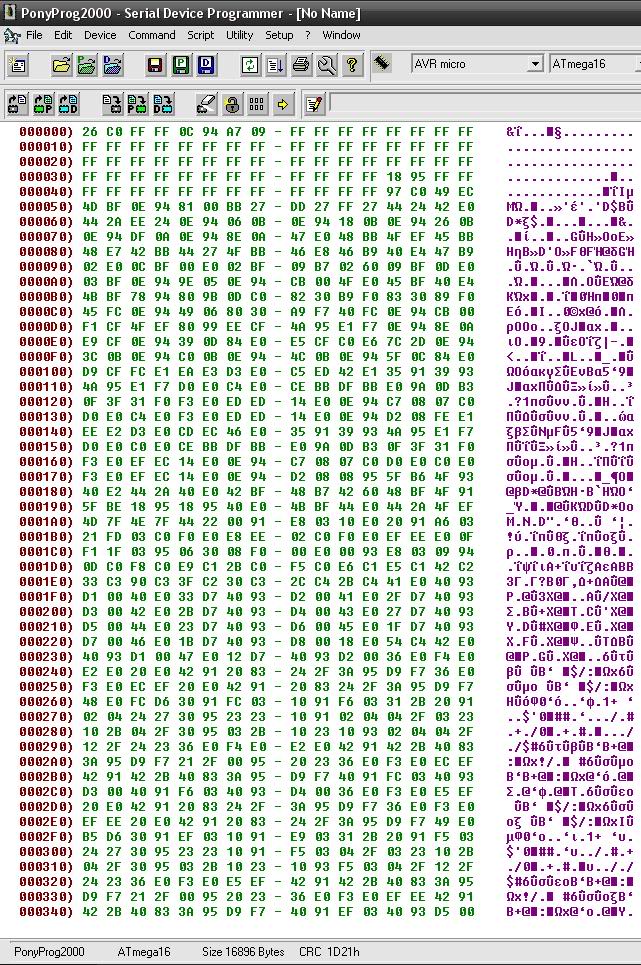

    I have just figured this out. With HEX only, i get the same CRC. With HEX and EEPROM file, i get a new combined CRC which is perfectly normal. The STK-clone is the PARALLEL port programmer Mindaugas uses. It is the one with 4 resistors and 4 wires. Exactly the same..
    I have just programmed the same ATmega16 to constantly blink a LED, and it work fine. I did it to see if the ATmega16 had a problem with the clock, but it did blink it at a correct rate, so i believe the clock and programmer work. I am using parallel port programming (4 330Ohms resistors and 4 parallel port wires), which is exactly the same as STK200/300..
    Will try once more!
    Because i want to disable the Center axis on boot feature, as describe in the manual..
    Thank you Frakk!

    Sorry I mixed up the STK with other programmers. Your schematic looks fine, double check resistors, capacitors and diodes, the connection to the USB port (don't mix up D+ and D-). Have you tried it on a different computer?

    yes, I have just come back from a different computer.. No luck! :sos:

    the CRC is written on the lower bar of Ponyprog after the programming is done. To be sure, after finishing programming the uC, click Read Device and you will have a refreshed CRC on the bottom of the PonyProg window..
    Look here, on the LOWER RIGHT SIDE: CRC: 1D21h

    Checked, my CRC is 56DDh.
    If I check .HEX files - before write > Open Program (FLASH) File, CRC is EA4Eh.
    Tested with 3 .HEX download from different pages, ie:

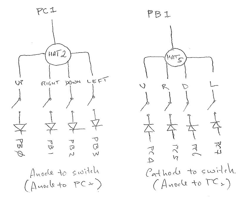

    Diode polarity; Hat identifier pins
    Thanks for the advice, Frakk.
    I never do anything the easy way, so I have a complicated diode setup because some of my joystick hats are identified by a pin from PC0 to PC7, and others by a pin PB0 to PB4. Thus some of the hats have their Up, Right, Down, Left positions mapped vertically and some horizontally in the mapping matrix. (See my spreadsheet and the diagram below if you want to clarify what I mean.) This way Hat 2Up on my CH Joystick can send a Direct X Button 2 message rather than Button 9 which would otherwise be sent (if I had all of the hats and buttons laid out horizontally as in the right half of the spreadsheet - which is the Throttle mapping), and older games do not have a mapping capability: i.e. Button 2 will always fire Cannon in Fighter Squadron.
    The diodes therefore are sometimes anode to switch and sometimes cathode to switch, but it all works the way I want.
