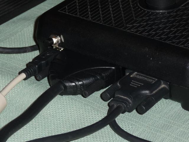

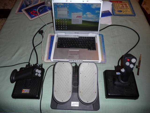

    CH Gameport mod to USB - Finito!
    Hi Folks,
    I wired up the rudder pedals last night and fitted everything together. Got the polarities for the potentiometers right, plugged in and it works very accurately. This equipment was CH but worked via a Gameport. It had wobbly axes (so that the control surfaces of the aeroplanes wobbled around at rest), the centre of axes was unstabe and often not centred, there were ghost buttons showing up all the time (nowhere near enough diodes on the switches), it was impossible to program from within Windows XP, and I couldn't get the CH programmer to recognize the stick lots of time. I suspect that this latter might have had something to do with my old Soundblaster, but I am not sure. Some have said that it is because newer computers do not work reliably with slow old gameport gamecards.
    This new USB setup appears to be dead stable, and using Autohotkey and SVMapper will be fully programmable.
    Thanks to Mindaugas for his original work, and to those here (Sokol, Senetor and Frakk, especially) who provided the encouragement to get it all done.
    I have two more sets of CH controllers which I can fiddle with now, but this one will have been the hardest: the greatest number of buttons of all my sticks, reverse engineering all of the PCB's in the heads of the controllers, fitting the MJoy into the base of the Throttle, and double and triple checking everything. Actually I am very happy, because, except for always getting my DSub connections the wrong way around, everything else worked correctly as it was powered up throughout the project.
    Regards,
    George.
    P.S. I still cannot work out how to use those big pedals with my wrists. For all the trouble they are giving me, I might as well use my feet. :rofl:

    Well done mate! Nice rig! ....but a Laptop? You are murdering all your effort! :gamer1:
    I didn't have time to work on my MJOY this weekend because of university pressure, i hope i will start RE-building (4th time) my MJOY on monday..

    Dear NuMca,
    That was just out of necessity: my wife was using my big computer!
